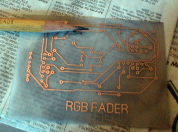

This is a board I did last Saturday. Its about 2.5" X 3.25". The traces are thin, almost like drawn with a pencil. I tried a demo of a different layout program, didn't think to change the defaults, everything was in metric (damn brits), so printed it anyway. I was a little concerned about whether it was going to work, so I used some cheap, paper thin copper I picked up surplus, cheap. Did two boards, came out amazing. I had the other board drill and fully assembled and functional by noon (and I tend to sleep late on weekends).

If you can fill a ground plane or 'pour copper' it will save you alot of etchant.
Like this:
If you are worried about how nice the board looks and you have someone else work without the ground plane. I use a medium sharpie marker and color it in on the copper before the etchant. Write date/initials, etc.
