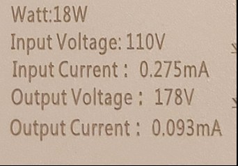

You are correct. Just so I understand you want a photo of the LEDS in the circuit? I would have to cut the tube open to see the inside. Now I did connect it to this 9-36v regulator and no light even at its max 36V DC
The label on the device is obviously misprinted - surely you realised that?, how bright do you think LED lights would be fed with only 93uA :D
And post #2 still has the wrong current - so changed, but not corrected.
Yes, I realized that as I indicated in my original post, where I said: "There is something wrong about the numbers listed on the device:". LEDs operating at fractions of a milliamp makes no kind of sense. I guess I'm just not smart enough to figure out what the manufacturer meant, as if I care.

This should output read 93 mA or 0.093 A and my reverse engineering on photo says it will be 100 mA.

This is just a simple 100 mA linear current limiter using 7.5 Ohms across 0.75 Vref meaning the IC will get hot as a low dropout linear regulator if the dropout is not "low" meaning if you do not have ~ 54 white/blue LEDs in series = 178V out, with a load of <= 16.5W, the IC will burn up. This is a product "worth about 25 cents". and consumer cost about $5 more or less is a ripoff.

1) 110 V x 0.275 mA = 30 VA (vector or apparent volt-amps)≠ 18 watts. It is more like 30 mW
2) 178 V x 0.093 mA = 16.55 mW, which means the thing is pretty inefficient, just over 50%. That is piss poor in my estimation.

Looking at the outside box, I recall parts of Japan have regions of 110V grid and I am wondering if this product was designed for that market only.
So it would seem to prevent burn out one the current limiter chip and one needs to drop the input voltage from 120 to 110 by some power resistor. 10V/0.1A = 100 Ohms @ 1W @ 150'C or a 5 W resistor in series with the very hot 50 Ohm 2W resistor at the AC input.
North America is generally 120V +/-10%. others may be 127 V nom. Mine is usually 120~123 Vrms. That could burn out the current limiter which becomes a variable resistor and heater with 1 watt for every 10V rise @ 0.1A Also, 1 Watt is all this chip can handle @ exceed 150'C and that's pushing it already. So it must have been designed for 110 Vac sources ONLY and not North America which is why they are unreliable.
This product just rectifies to DC with 4 diodes so 120 * sqrt(2) = 170 Vdc with no load so the measured No load in #1 is high 246V but this is a measurement error where meters will measure almost double the DC value in AC mode intended for AC only but when with DC are almost double. (std. rect. avg. to rms scaling).
