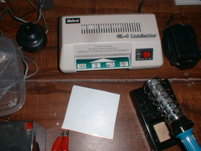

Laminator not hot enough? Hmm... mine gets hot enough that I need to set the board down to cool off. I run them through twice. I'll do a couple of light strips on the photo paper tomorrow. Can let it soak while I mow the yard... Guess I'd better charge the camera batteries so I can use the flash this time...

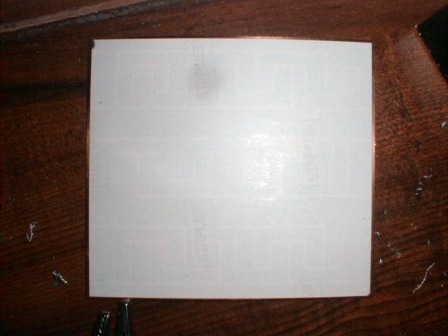

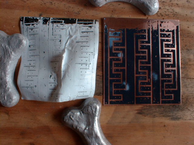

Okay, tried the photo paper. Kind of strange, but the paper didn't get soft or seperate when I soaked it. I let it set for about an hour, while I mowed my yard. I started peeling it back, and it was seperating from the toner fairly clean. So, kept going, but had put some effort into it. Got down to the last half inch or so, and the toner peeled off the copper (not clean enough?). Won't bother etching this one, just clean off the toner and try again.
Don't know why the paper didn't seperate like when I tried it with the iron.
Photo01 shows the print and the Staples paper I used.
Photo02 is after I ran it through the laminator.
Photo03 Board and laminator I use.
Photo04 After peeling off the paper, Board and paper.

I didn't iron anything. It was a test to see if the laminator (Photo03 earlier post), would work with the photo paper. It wasn't a huge failure, actually almost worked. Might have rushed preparing the copper. Also, maybe the paper is considerably thicker, so I should have passed it through the laminator more then twice (as I usually do). Kind of wondering if it's the right paper.
When I used the iron (before I bought the laminator), I remembered there was some melting, like plastic (clear) around the edges. Will try another experiment later.

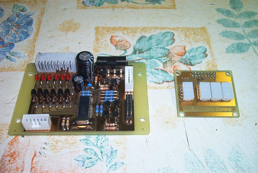

Below is a board I made of Bill's (blueroom) inchworm ICD2 a couple weeks ago.. Time was maybe 1 hour (start to finish), and I had to takes his JPG from electro-tech-online.com, remove the silk screen and resize it and mirror it (in photoshop; maybe that is why it took an hour :))
I printed it at 600DPI on a laser printer to staples picture paper, iron the heck out of it, soak/peel and scrub (see right picture, that is after I scrubbed it and toner still on it), dip in etchant 5-6 minutes (see left picture).
https://www.electro-tech-online.com/attachments/inchworm-jpg.8550/
This method works. If someone gets a laminator working, that will help save time. But you still have to drill it :confused:
