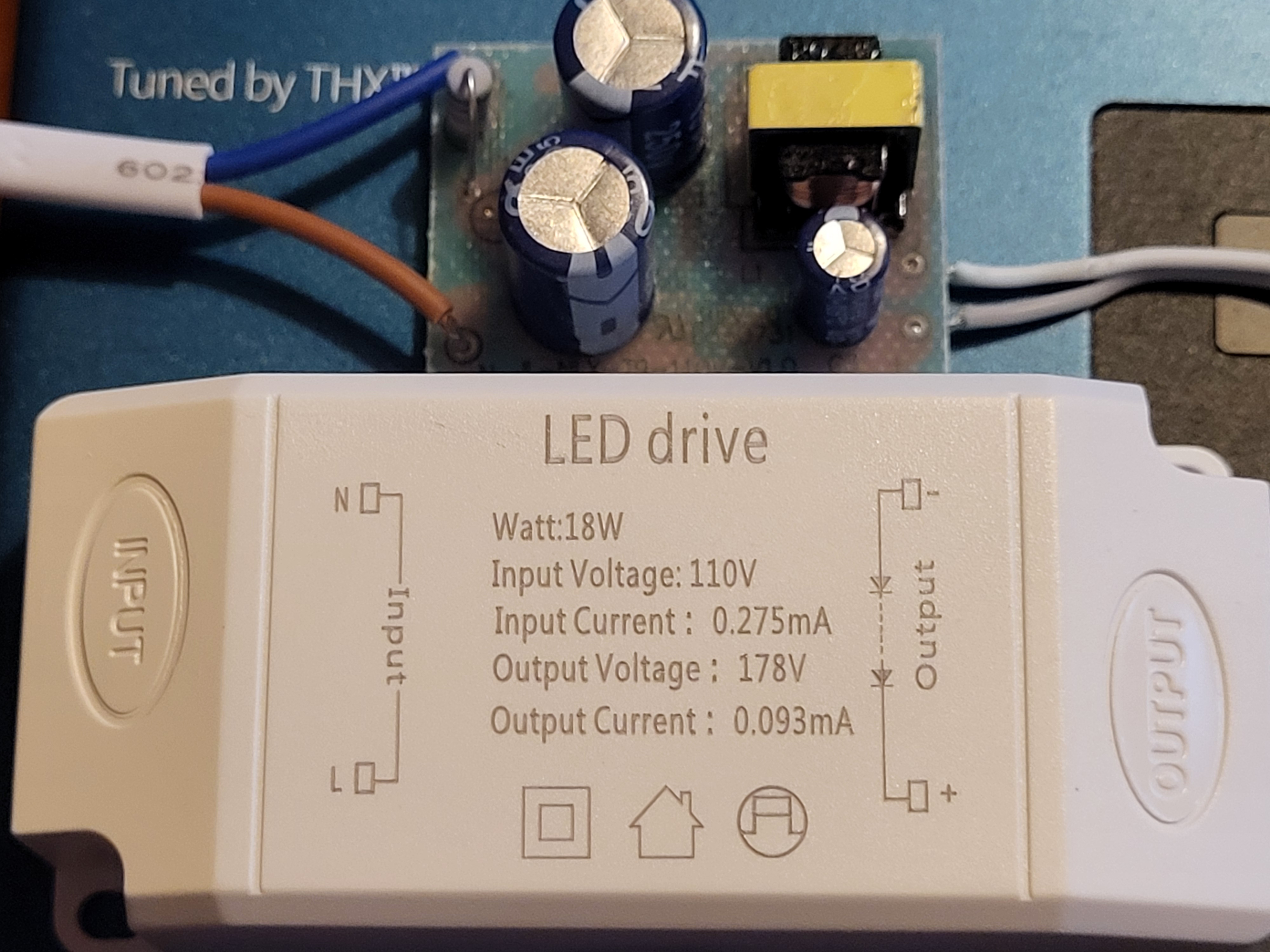

I am baffled. This transformer / LED Driver is 120V AC input and outputs over 200V DC. Probed with no load 246V
It is meant to drive a 12 inch ring of leds. Why so much for a small amount of LEDS?

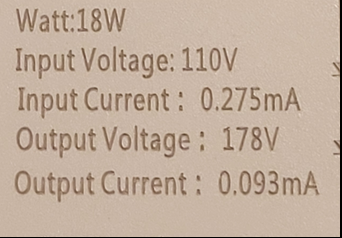

There is something wrong about the numbers listed on the device:
1) 110 V x 0.275 mA ≠ 18 watts. It is more like 30 mW
2) 178 V x 0.093 mA = 16.55 mW, which means the thing is pretty inefficient, just over 50%. That is piss poor in my estimation.

That is a custom designed LED driver. Without knowing the exact specifications of the LEDs its connected to, replacing it with anything else is likely to damage the LEDs or the replacement PSU.

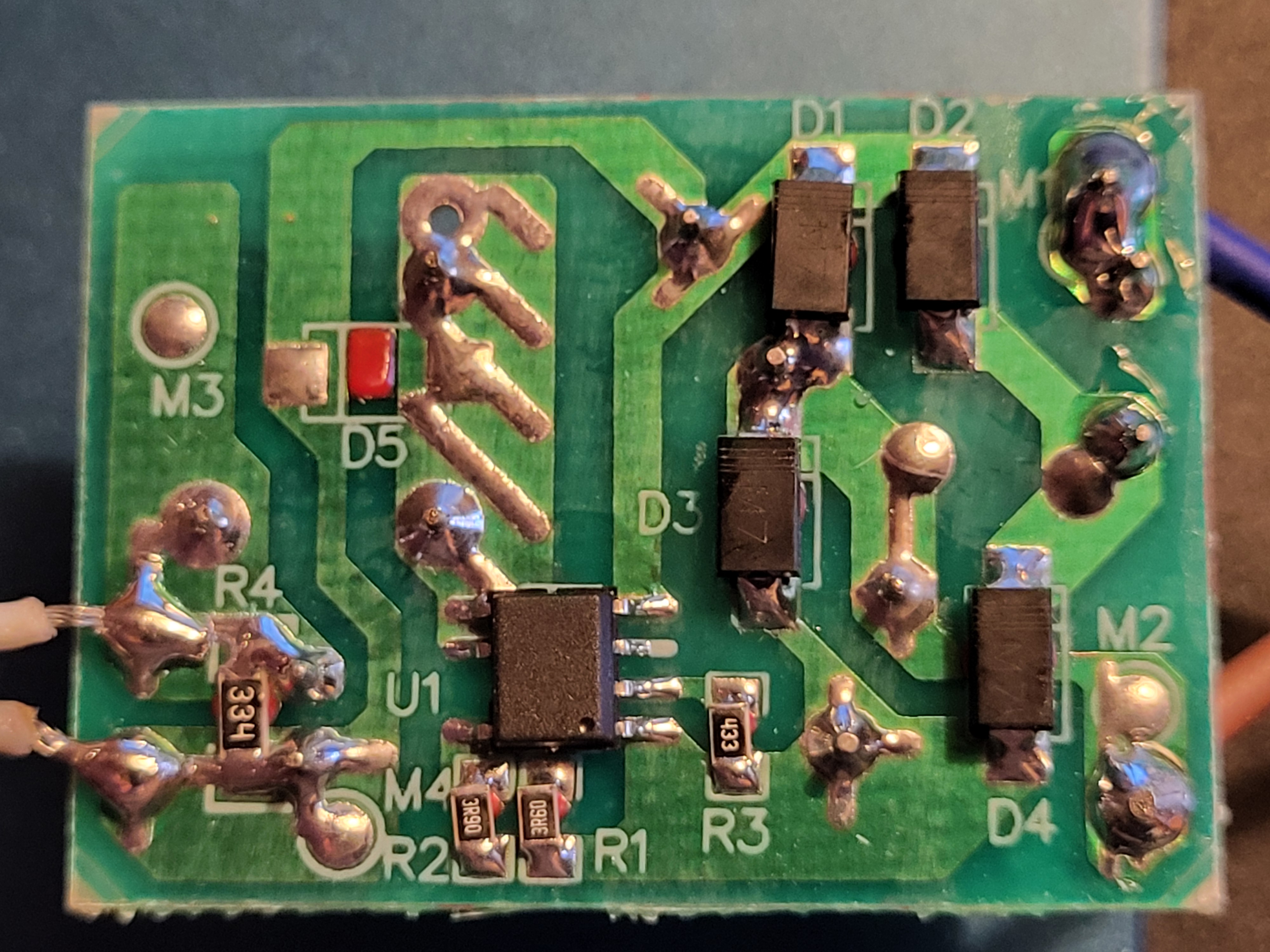

As others say, it is NOT a "Transformer". It looks fine to me; it is simple as it uses an all-in-one high voltage switching / regulator IC. "TOPswitch" style.
The voltage and current may be maximums - if it is a constant current device, the current could be the same at much lower voltage when connected to a chain of LEDs.

You've messed your maths up - the output is rated at 16.55 watts (not milliwatts).
However, you can't simply do the same for the input, the specification for the current will be the MAXIMUM - not the normal running current. It's a standard constant current LED driver, and will be reasonably efficient.
I don't see the OP's issue?, his mistake is trying to measure the output voltage of a constant current supply with no load - connect it up properly, job done.

I agree. An output current of 0.093mA is nonsense. Probably a typo for 0.093A.

Ill connect the led ring and probe the load.
Like always, you folks have helped me solve another problem.

The label on the device is obviously misprinted - surely you realised that?, how bright do you think LED lights would be fed with only 93uA :D
And post #2 still has the wrong current - so changed, but not corrected.
I have to agree that common sense (so little of that is demonstrated here) rules in this case. The mA has to be a typo and should be Amps. LEDs are pretty darned efficient, but even a 5mm LED isn't going to operate at 0.093mA, let alone higher power LEDs designed for illumination.

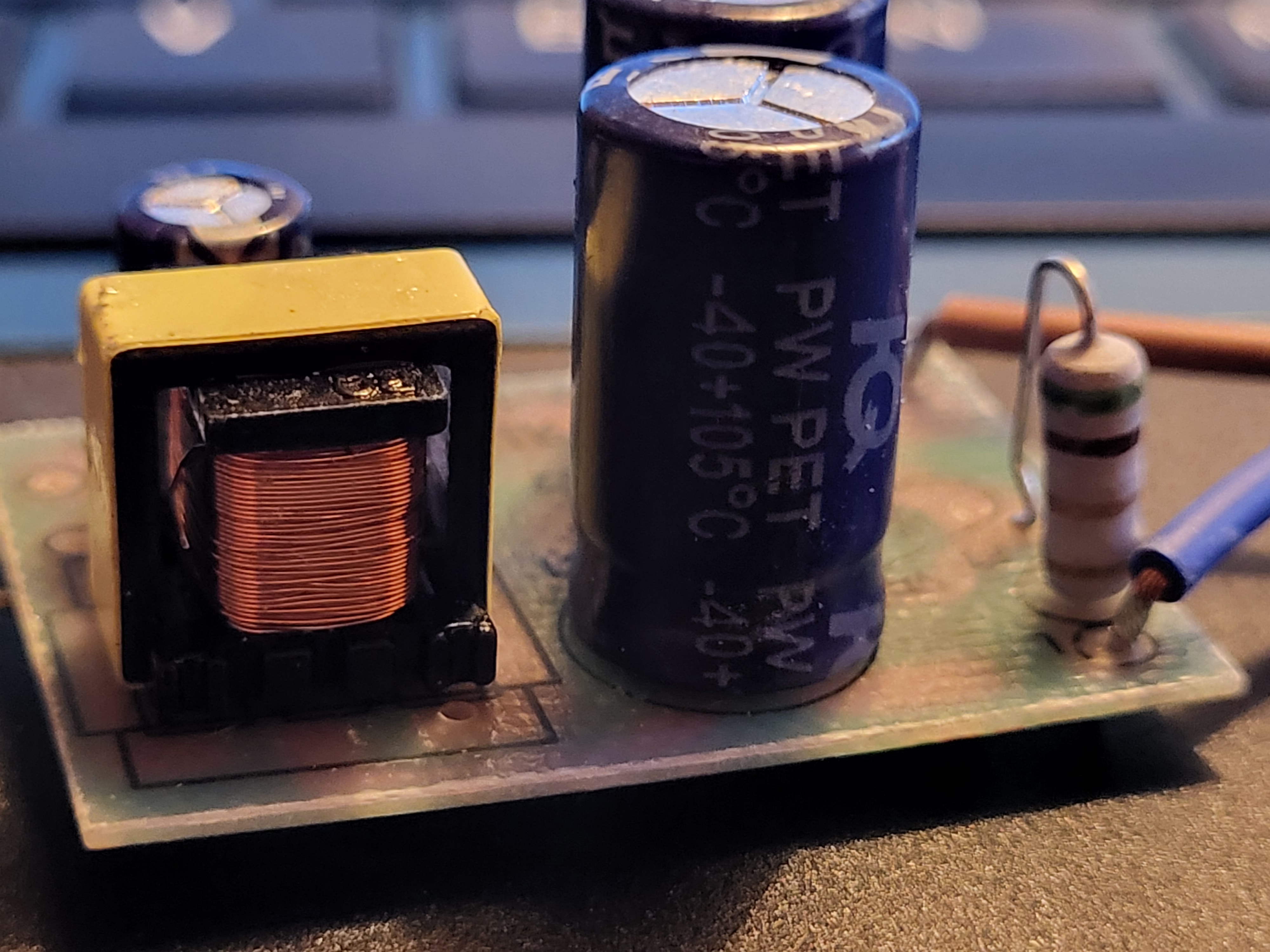

This should output read 93 mA or 0.093 A and my reverse engineering on photo says it will be 100 mA.
The two bulk caps in series are rated for 250V so it can tolerate 500V * 80% (from tolerance mismatch)
No-load higher voltage is always higher when the max number of LEDs in the string limits the voltage.
I roughly estimate 3.3V per LED and think this can drive up to 54 series LEDs with constant current.

This is just a simple 100 mA linear current limiter using 7.5 Ohms across 0.75 Vref meaning the IC will get hot as a low dropout linear regulator if the dropout is not "low" meaning if you do not have ~ 54 white/blue LEDs in series = 178V out, with a load of <= 16.5W, the IC will burn up. This is a product "worth about 25 cents". and consumer cost about $5 more or less is a ripoff.
