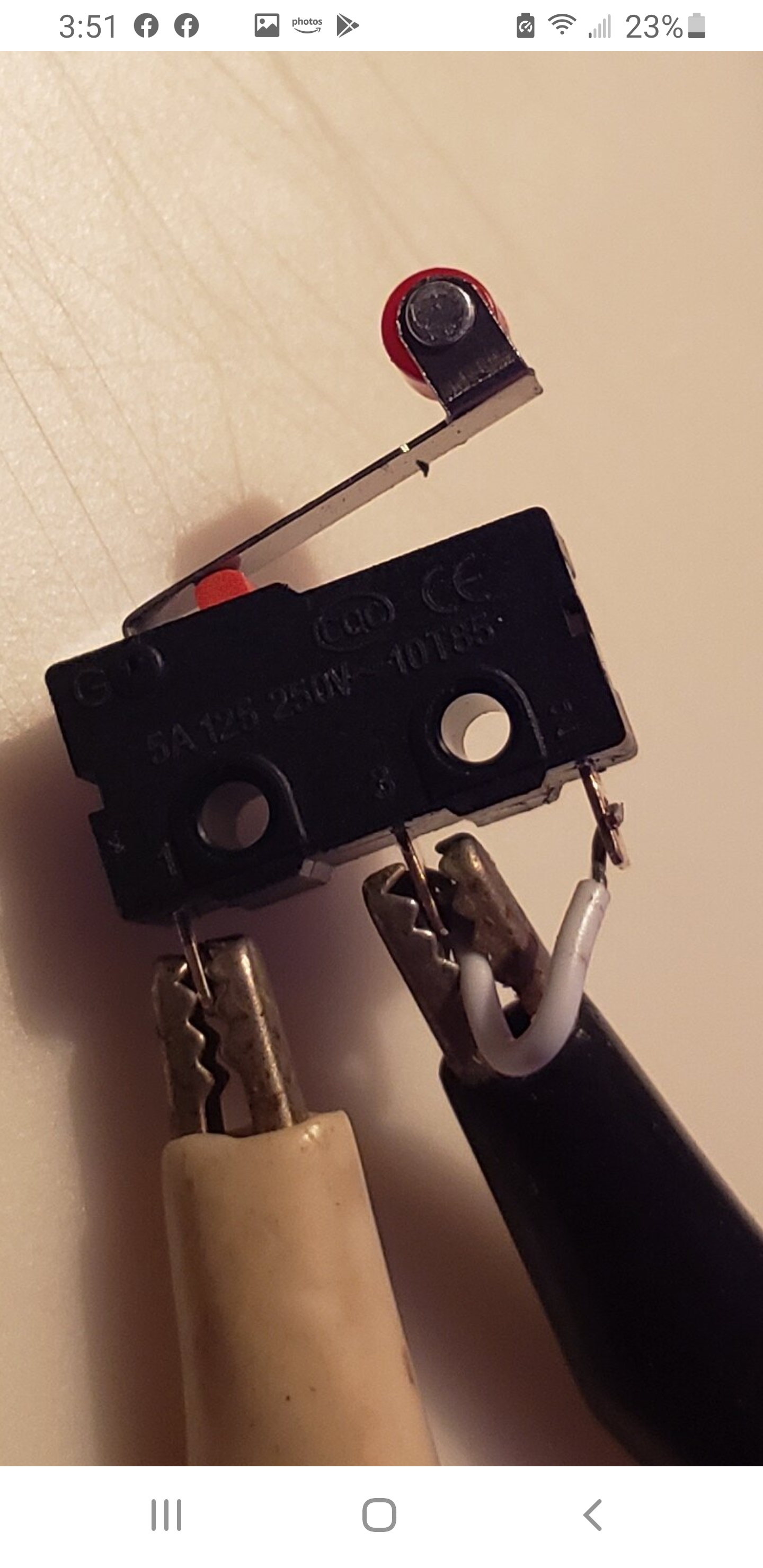

Will you be using a N.O switch like the micro switch? I'll need a part number for the switch.

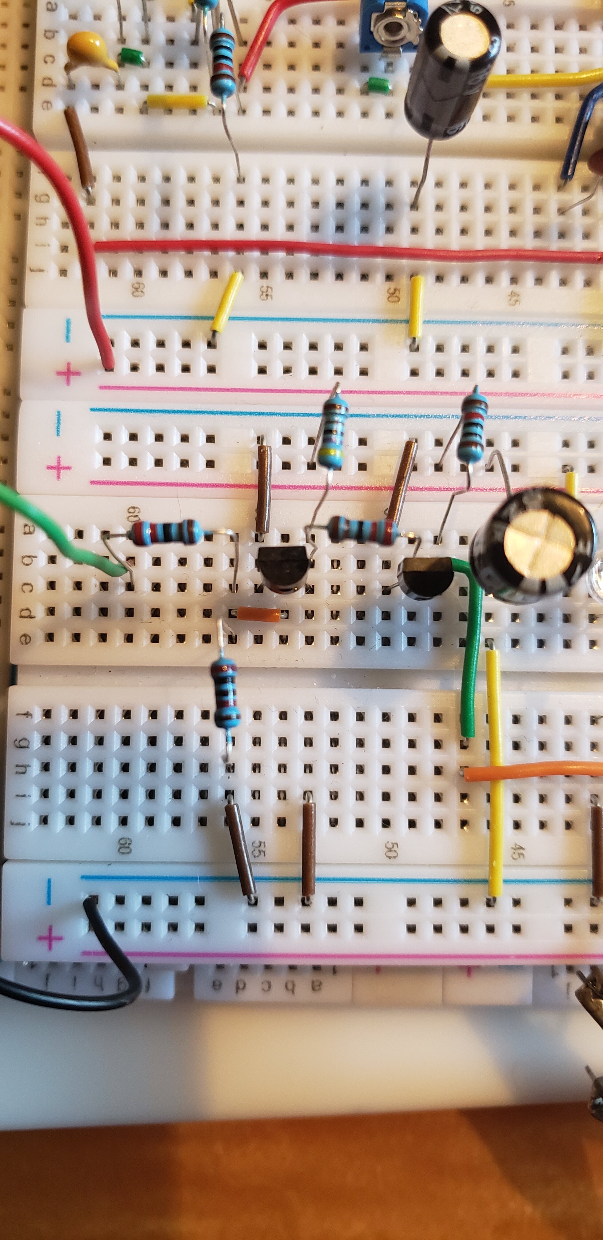

Ok. I rewired the optional power circuit. Checked all components. Tested. No workie. Here are the voltage readings from Q9 & Q10 in standby and touch sensor pressed.
Q9
E 0 - 0
B 0 - .70
C 2.1 - 0
Q10
E 0 - 0
B .70 - 0
C 0 - .25

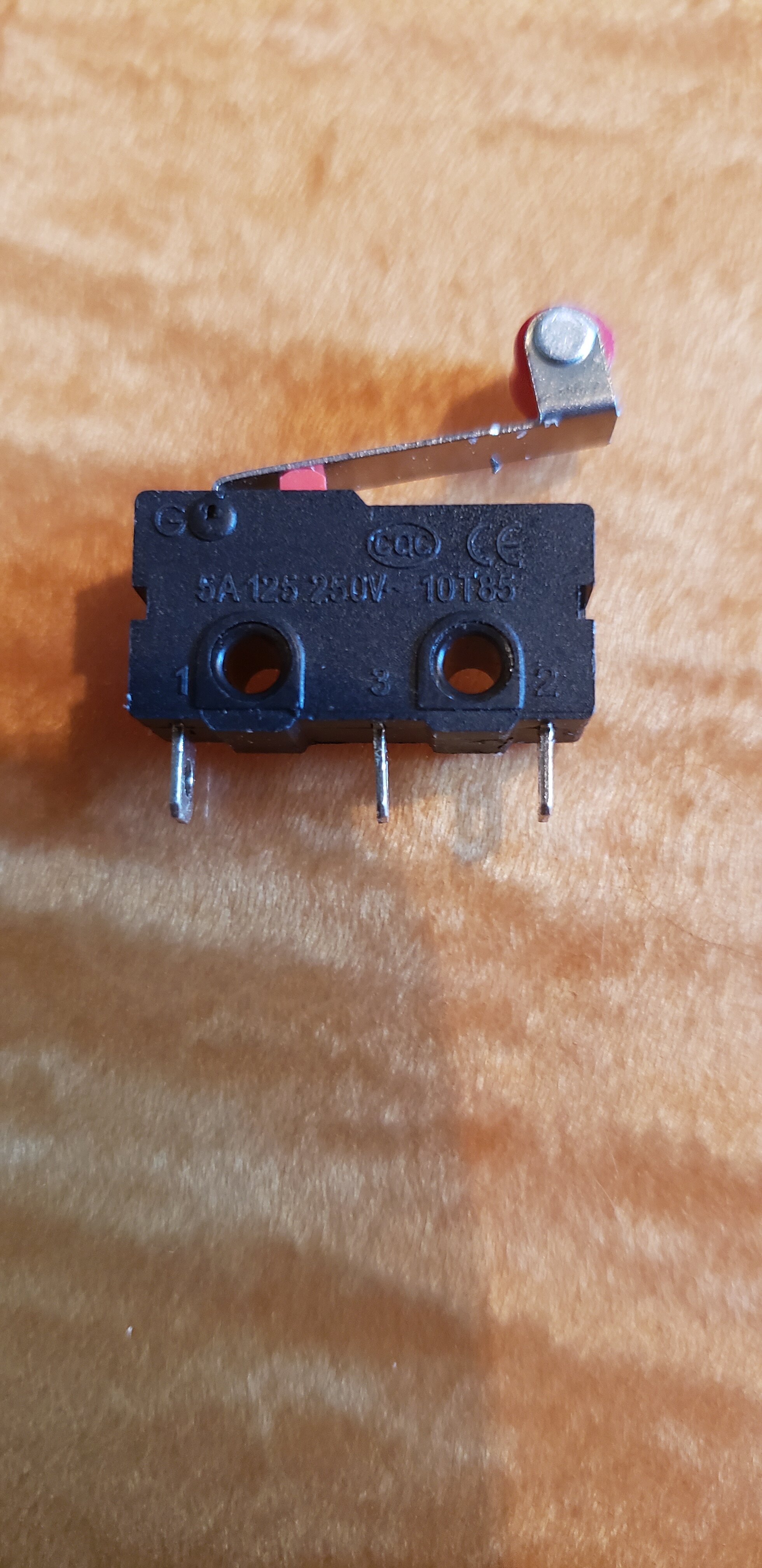

Both. Depends on the door. N.o. switch or touch switch.Here it is.
The thing with this is I will short this so it sends a positive latch when pressed or released. Thus triggering the circuit when the door is opened then again when it is closed. I dont have to do this if you have a way to alter the circuit so it resets if the switch is released. Anyway,, This may pose a new issue when the door is left open and the timer circuit resets after the 555 expires. What will happen when the door is finally closed? The light will turn on. Perhaps there's a trick up the sleeve of one of the ic's that could be used to determine what to do with the unwanted pulse. Maybe my pinswitch needs more pins?

I'm using the same switches throughout the project. Either a digital touch or a mechanical NO/NC that can be rewired to be a NC/NC

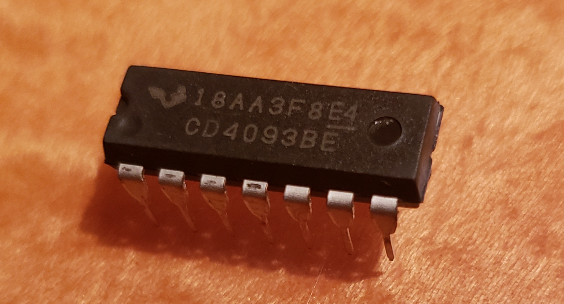

I hope this is not confusing. I documented it this way because the 4093 uses a similar truth table to make decisions.

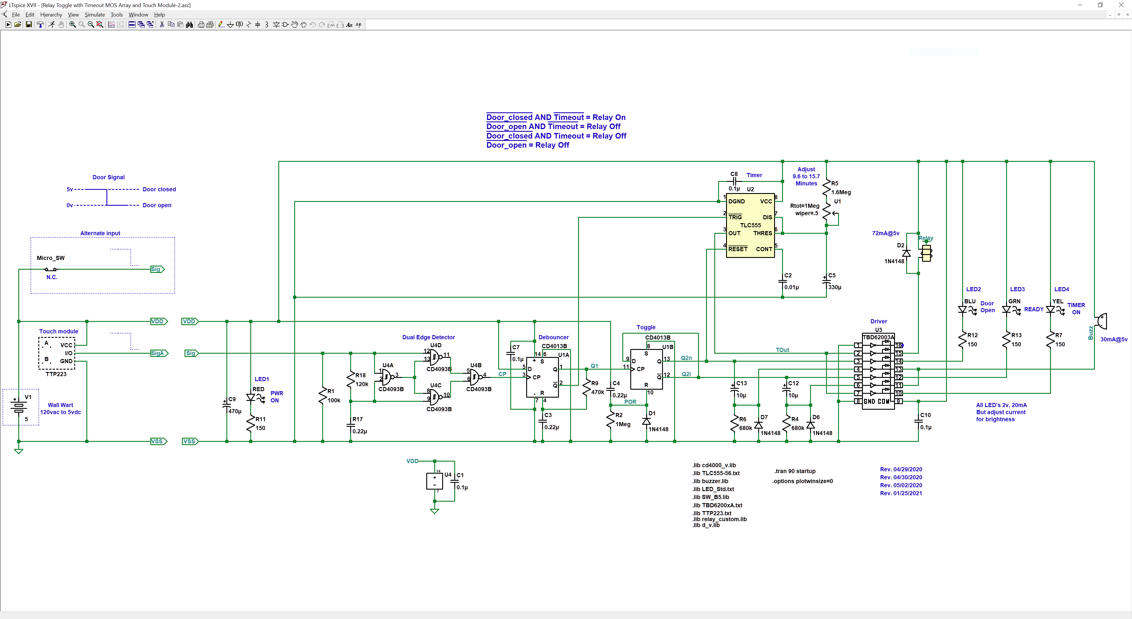

OK.
I think this will do what you want.
It is the mostly the same as the last circuit but with a few modifications.
See circuit below for the following comments.
1. I've replaced the input signal differentiator circuit with a "dual edge detector" circuit. The dual edge detector generates a pulse when the input changes voltages levels. It doesn't matter whether level changes from high-to-low or low-to-high. It will produce a pulse on either change.
2. I've reconfigured the reset (pin 10) of the Toggle flip flop with a "Power On Reset (POR)". This ensures the Toggle flip flop "Q" is set low at power up.
3. I've re-wired the 555 timer so that the output drives the relay via the TBD62003A. When the door is opened the timer is enabled so its output immediately goes high, begins the timing, and energizes the relay. If the timer expires, the relay will de-energize. If the door is closed before timeout, the relay will also de-energize. If the door is opened again, the sequence starts over.
4. I changed the wiring of the Blue LED to reflect the status of the door. Basically, anytime "Q" of the toggle flip flop is high, the door is open.
I thought it would be more useful that way since now the timer LED reflects the state of the relay. We can change it if you prefer.
5. One thing that is a mandatory requirement for this circuit to work is that the Micro-switch or Touch module must "latch" its output.
This is easy for the Micro-Switch, but the Touch-Switch must latch its output on touch detection. I think the one you have will do that.
It doesn't matter, however, whether the output initially low and changes to high, or visa-versa, as long as it hold its state (no pulsed output).
You shouldn't need any more parts. The changes I made use existing parts.
I have the modified circuit on the breadboard and its working as intended.
Let me know what you think.
Well I think your awesome for doing this regardless how it functions. Im excited to apply the changes. And yes the touch sensor can be set to latch. Ill connect the micro switch as it is without mods. So it will latch closed on door open and latch open on door closed. Ill be in touch. Thank you so much.
I've made the changes to my schematic. Im going to build this on a new test board. I am curious about a few things...
Does this circuit know the difference between which button is used? Micro / Touch
So this circuit will now ignore a "single" request via (button or touch) to engage relay if a certain condition exists. That condition being that a door is open and the relay off
If that is the case. Then the circuit (after ignoring the request) will reset itself and become ready again.
I'm curious how does the circuit know the doors state? Is it voltage based? 5v+ (high) means door closed and 0v (low) means door open?
Again thank you. I am learning a great deal. I like to stay sharp and this is good exercise for me noggin.
