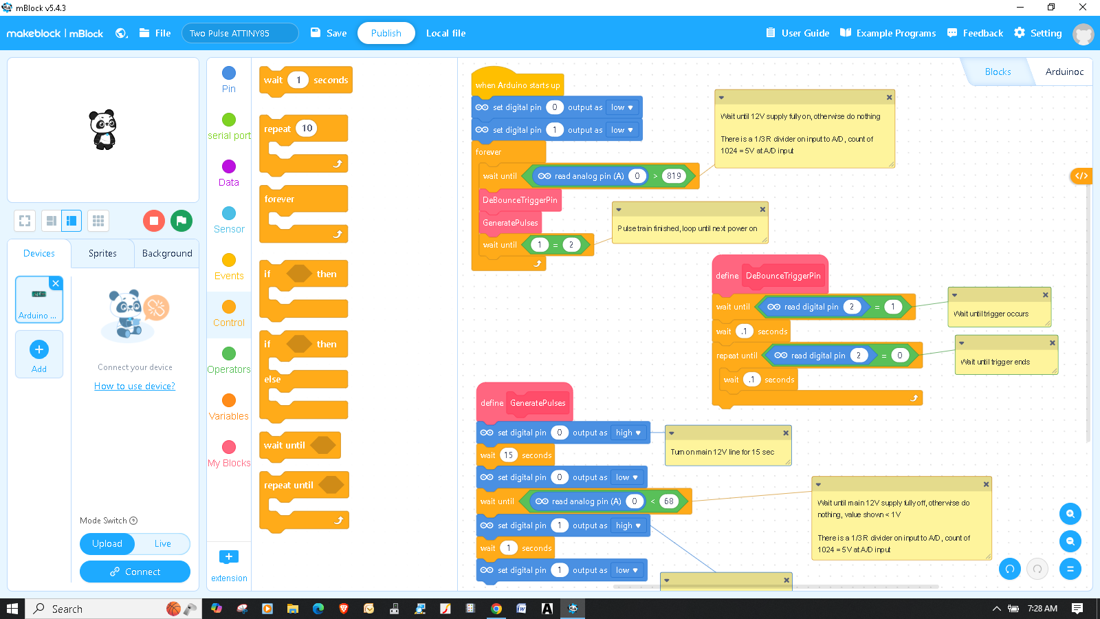

The following should accomplish all the above still using ATTINY85 as discussed in
post # 6. Here is what it should look like in block code :
The main loop block group upper left right hand window, and the subroutines called as needed.
The power of programmable devices where appropriate. And simplicity of block programing if
one is new to programing micros.
There is a learning curve associated with above, so stay the course on your 555 approach,
and you can address the above design points other ways if any of them deemed necessary.
Regards, Dana.
An example :
I sped timing up to make acquisitions for me easier than twiddling my thumbs waiting
for long delays. Note the 100 mS delay implemented between 15 sec pulse and the 1 sec.
That of course is adjustable. Simple block delay entry. Thats to allow the 12V main supply
to drop to < 1V (just a setting in block code above) before switching on the aux 1 sec supply.
I also looked for glitches on power up, found none. Trigger is bottom trace, implemented as bounce in then
out to initiate pulses. Mechanical generated trigger. Again trivial to change to edge based trigger.
