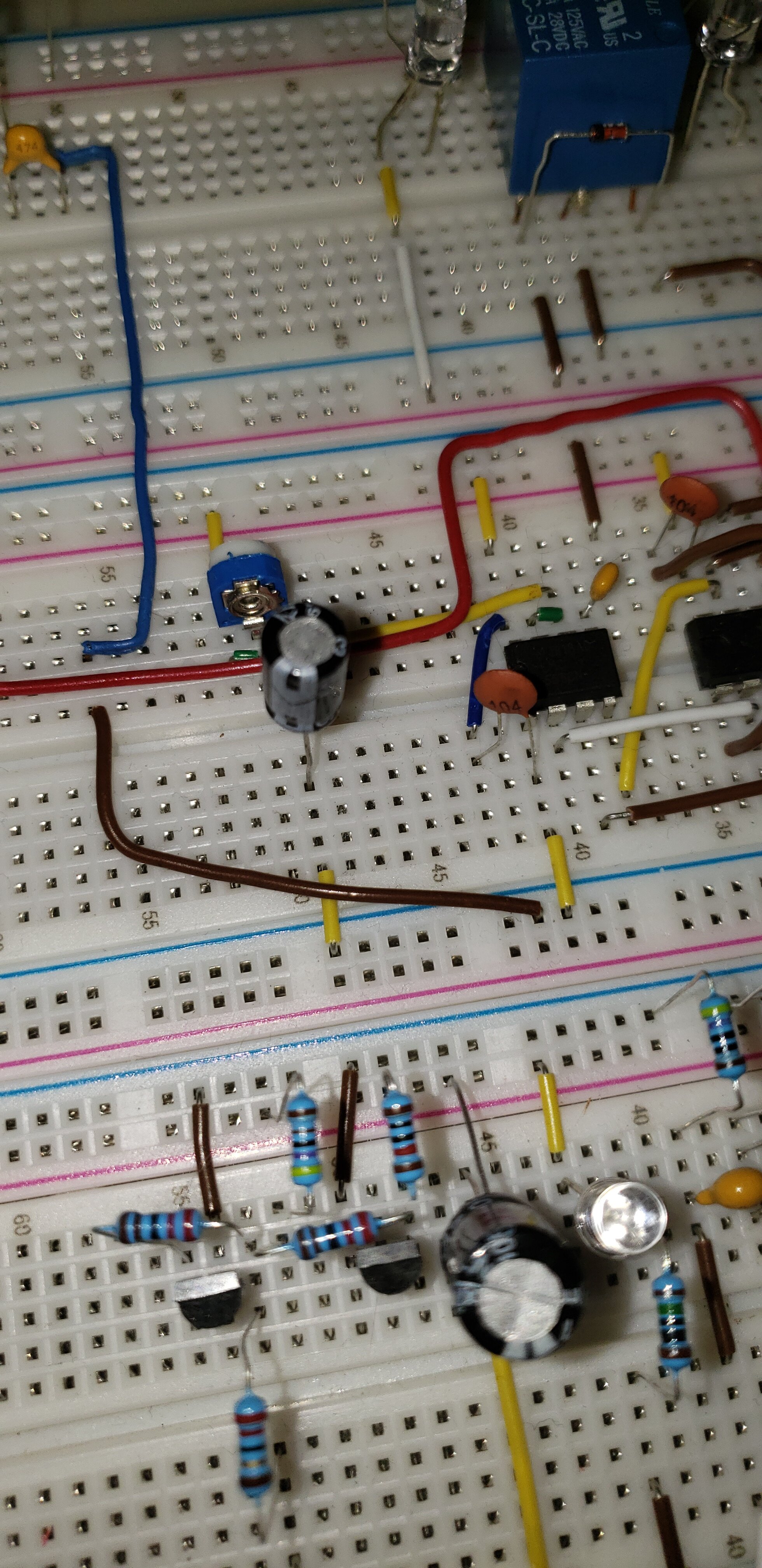

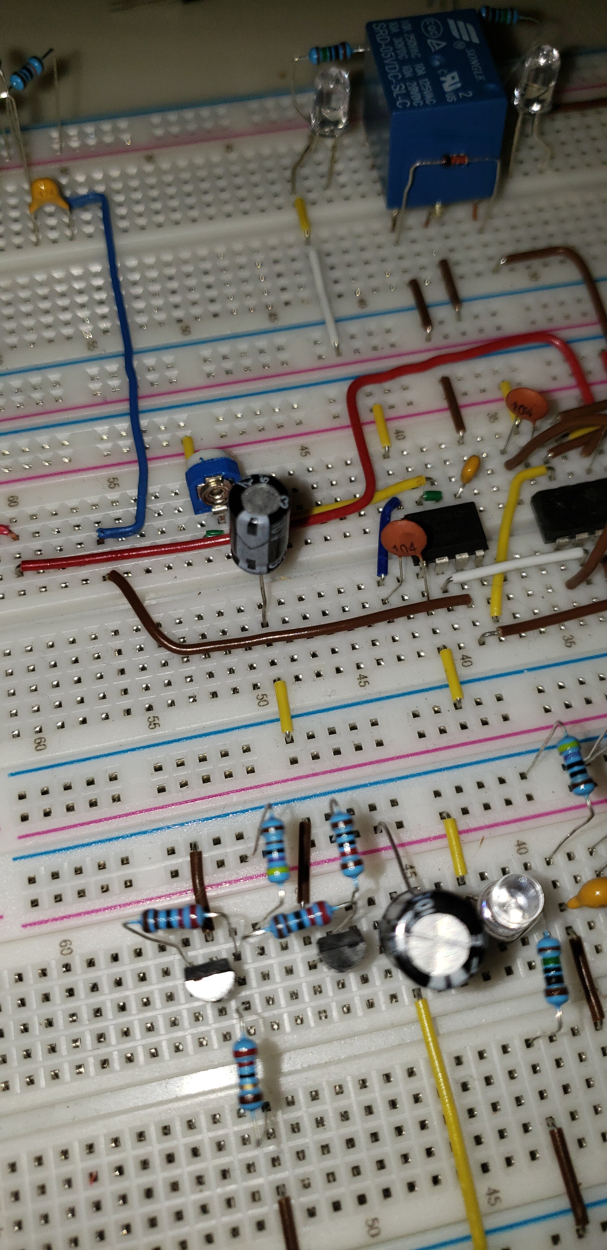

Your up late. Here's 2 quick pics. Before and after
I did remove x8. And that blue lead changes to brown then goes to ground.

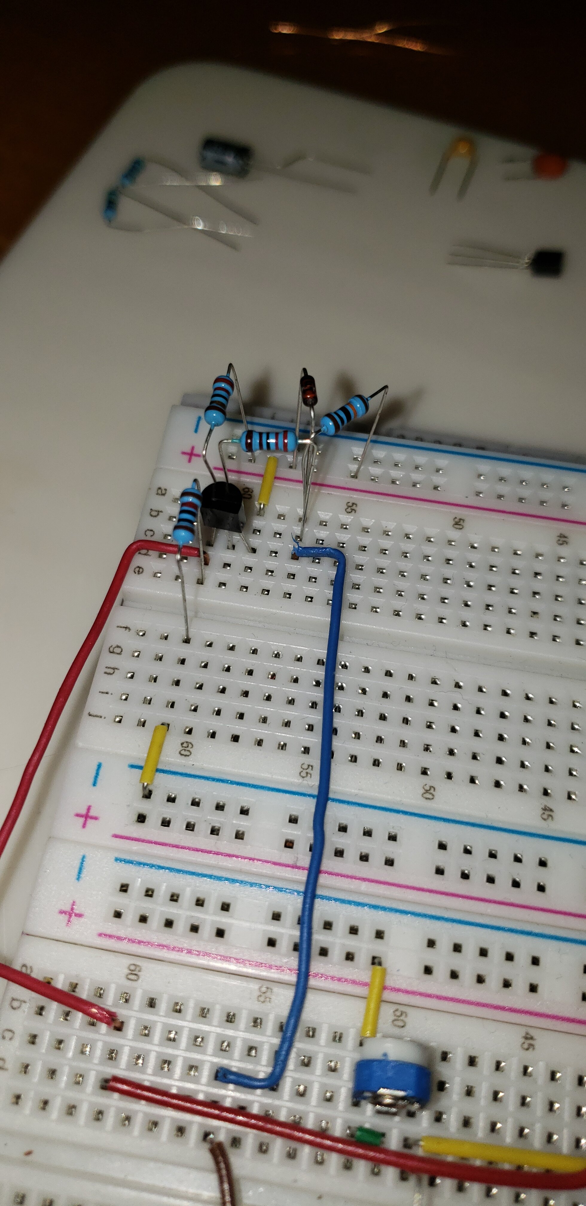

I even relocated that part of the circuit to a different location and changed all the components. I was so hopeful it would work. But pin 1 will not go high.
The 327 is connected as follows
Collector to pin 10 of the 4013 & to ground via a 10k resistor
Base goes to 5v via a junction of 3 resistors and 1 diode.
Emitter goes directly to 5v
On the other side of the junction is a lead that goes to ground.
The result from this test is the collector remains low.

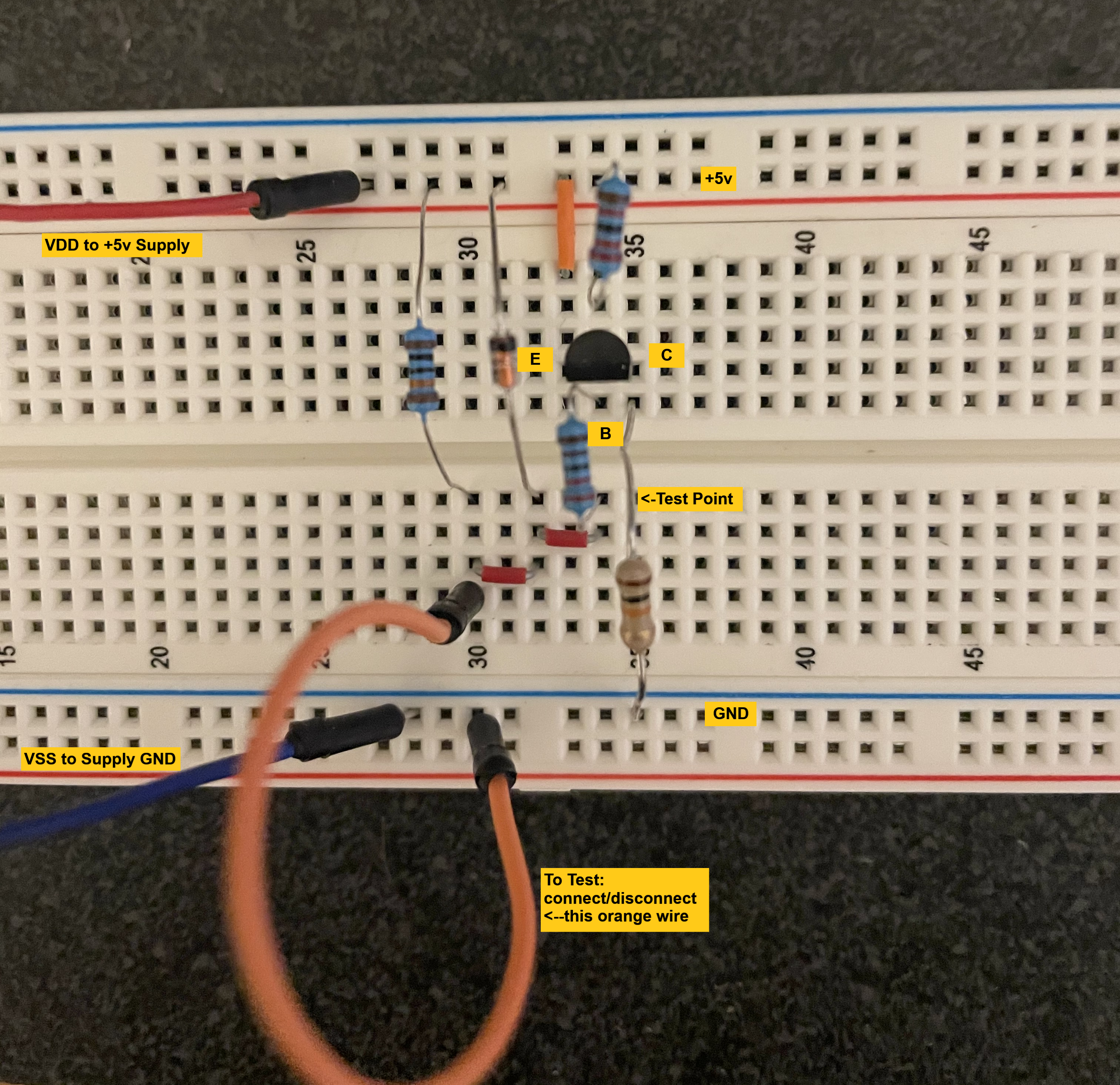

Hi
Here is a photo of my working circuit. This uses a 2N3906.
It is shown with the orange test jumper connected to ground. The measuremet at the test point is 5v
When this jumper is disconnected, the voltage measured at the test point changes to 0v.
I began just setting up an isolated circuit to just test the transistor. Im going to hook mine up like you have and try this.
Well well. That worked.
I've completed the test. While I had it set up I tested all 327 transistors.
