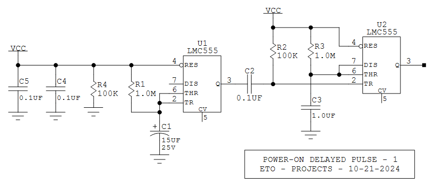

Hey guy's, I may find the solution before someone answers here but I figured if it can save me sometime might as well double down.
Trying to figure out how to setup a monostable 555 circuit to add a 15 second delay upon receiving power, then power a second 555 with a shorter 1 second delay. I found a few different circuits just searching the web but whenever I try to simulate them in LTspice I'm not getting the type of readings I was expecting. Essentially the goal of what I am doing is to get the first half of the circuit to wait 15 seconds then power a second half that has a shorter delay (1 second) that will receive its voltage from a secondary source.
I know it would probably be better to use relays but I have loads of 555 chips on hand already so if I can figure something out just using these then that would be nice. Any help would be greatly appreciated.

Your problem is likely cause by the first cycle of the 555's timing capacitor charge from 0 to 2/3Vdd. Subsequent cycles go from 1/3v to 2/3v. So, plan your timing accordingly if you are charging from the first connection and the timing cap is completely discharged. If you trigger twice in short succession, you may need to discharge the capacitor completely as part of the trigger to keep timing consistent.
Better to have both 555's powered continuously, and have the first 555 *trigger* the second one. This works by having the first 555's Output connected to the second one's Trigger input through an R-C differentiation network.

First pass at the requested dual-555 circuit.
R1-C1 is the 15 second power-on delay. R2-C2 is a differentiator to compensate for the 555's non-monostable behavior. It turns the U1 output trailing edge into a short trigger pulse. Its period is not critical, but must be less than the output pulse width. R3-C3 sets the 1 second output pulse time.
For both timers, the pulse width is 1.05 x R x C.
R4 provides a discharge path for C1 and C3 when power is removed. C4 and C5 are power supply decoupling caps for the two ICs.
The two ICs can have different power sources, but the two circuits must share a common GND.
Click on the schematic for a larger image.

Just to clarify a bit more here is the situation. There are 2 seperate 12v lines, one is always on, and one is momentarily on. The issue is when the device is powered on by the main (The always on line will be "main") it sends a constant 12v down the momentary line as well which causes a conflict shortly after.
So what I am trying to achieve is basically having the first 555 start when the device is powered from the main, I want to run the momentary 12v line through a 2nd 555 that is off, this way no current will be allowed through until AFTER the first delay. Then once all of that is complete the 2nd 555 will stay on but with short delay so the momentary 12v line can do its thing.
The main device is a amusement machine so what happens when the momentary 12v line is energized for longer than 5 seconds or so, it makes the machine go into an error because it sees that as a coin slot being stuck closed.

One will be powered continuously however I would like the second one to remain off for the short duration that way no voltage will pass through it before the first delay. Bipolar

So I attempted to copy the first part replacing the output with a LED just for testing sake, I feel like I have something setup wrong though. Getting 850mv through output. Fairly certain I just have this setup wrong, I'm new to using this kind of software so forgive my ignorance lol
EDIT: I noticed I did miss a connection but even after connecting that other resistor it didn't fix it

You have the Trig and Thrs inputs connected directly to Vcc, and the bottom end of R2 is floating. Break the connection to Vcc, and connect R2 to Trig and Thrs.
