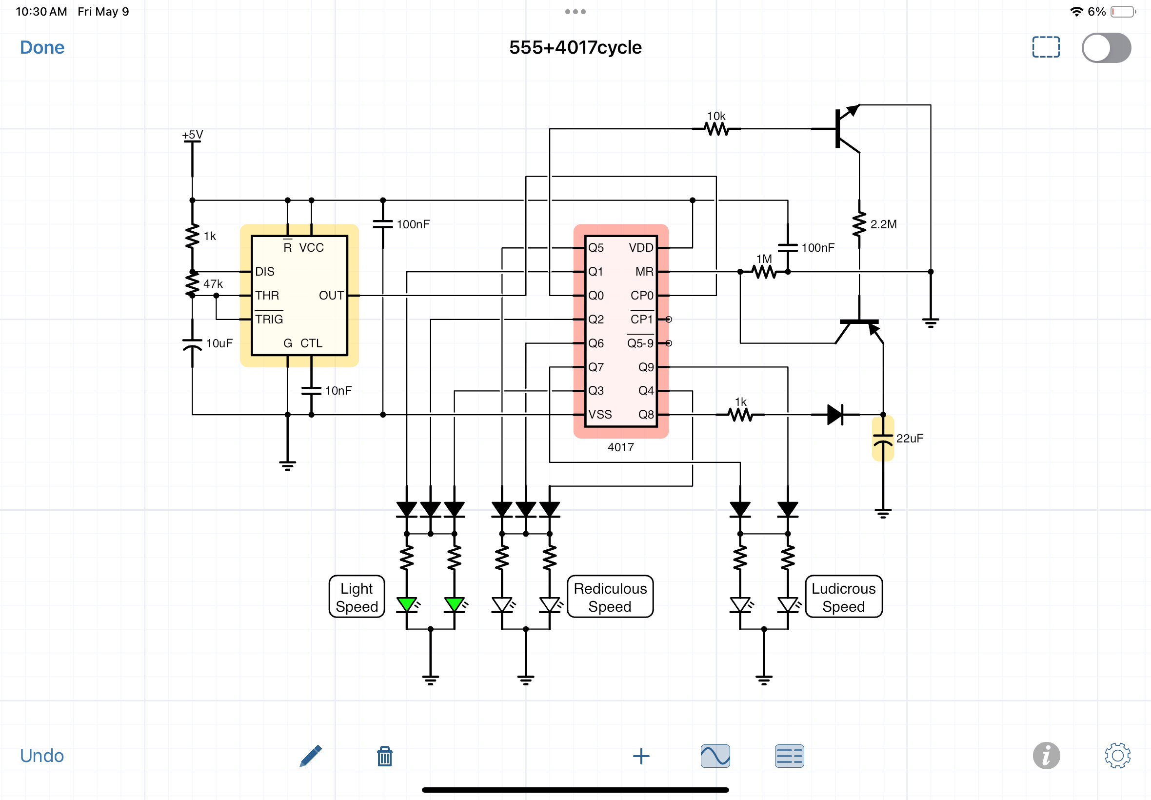

If you want to do it quickly and easily, I'd use a decade counter and an LM555 chip to pulse the decade counter.
The decade counter has 10 outputs (Q0 to Q9). When you turn the circuit on, it lights the first pin, then pulses to light the second, then third (all three I'd these are connected to light your first sign) Q1, Q2 and Q3j. Q0 wound be connected to anything as the dark starting point. .
Then the fifth, sixth and seventh pins (Q4 - Q6) light up the second time for about 0.6 seconds each for a total of 2 seconds. There will be no flash as one turns off and the next turns on.
Finally, for the third sign, flashes the second sign in, (Q7) makes the first flash, then Q8 not connected to anything means everything is dark, (Q9) flashes the third sign on again.
Now, you can make it stop there until you switch it off and on again, or you can have it continuously cycling back to the dark before the first sign and repeat.
Let me know what you prefer.
There will be a few more wires with this method but no installing software, writing a program and loading into the microcontroller. Just two chips. One that makes pulses, and one that takes those pulses and energizes ten different pins.

Here
I modified my original description a bit to allow an extended (4-6second) pause at the start of each cycle. Otherwise, it looks like it is just another flash if the "all dark restart" is the same amount of time as the all dark between Ludicrous flashes (0.66 seconds). To do this, Q8 charges a capacitor that the Q0 discharges. At the beginning of the discharge, the 4017 is paused in reset until it discharges enough.
I haven't breadboarded it yet but let me know if it works (or not).

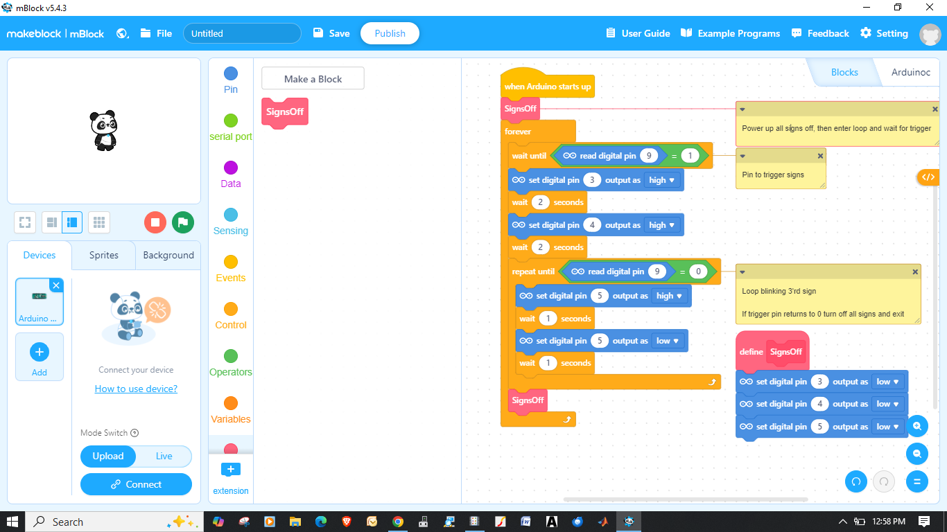

Use Arduino Nano board, ~$3, and write program (as shown) in mBlock. mBlock
takes your block configuration and generates Arduino code from that. Quick and
dirty solution, timing accurate as board has xtal on it.
Load of fun programming in block language. Many variants, like Tuniot, NodeRed, Scratch, Snap4Arduino
make it easy, 2 minutes, to bring up a simple server for example.

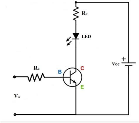

The board cant drive high power LEDs directly, so use a NPN interface to pin like -
Use ~ 1K in base, Rc will set current thru LED, and add a 10K R from base to ground to insure
LED stays off when design first powers up and sets output pins floating.

Here

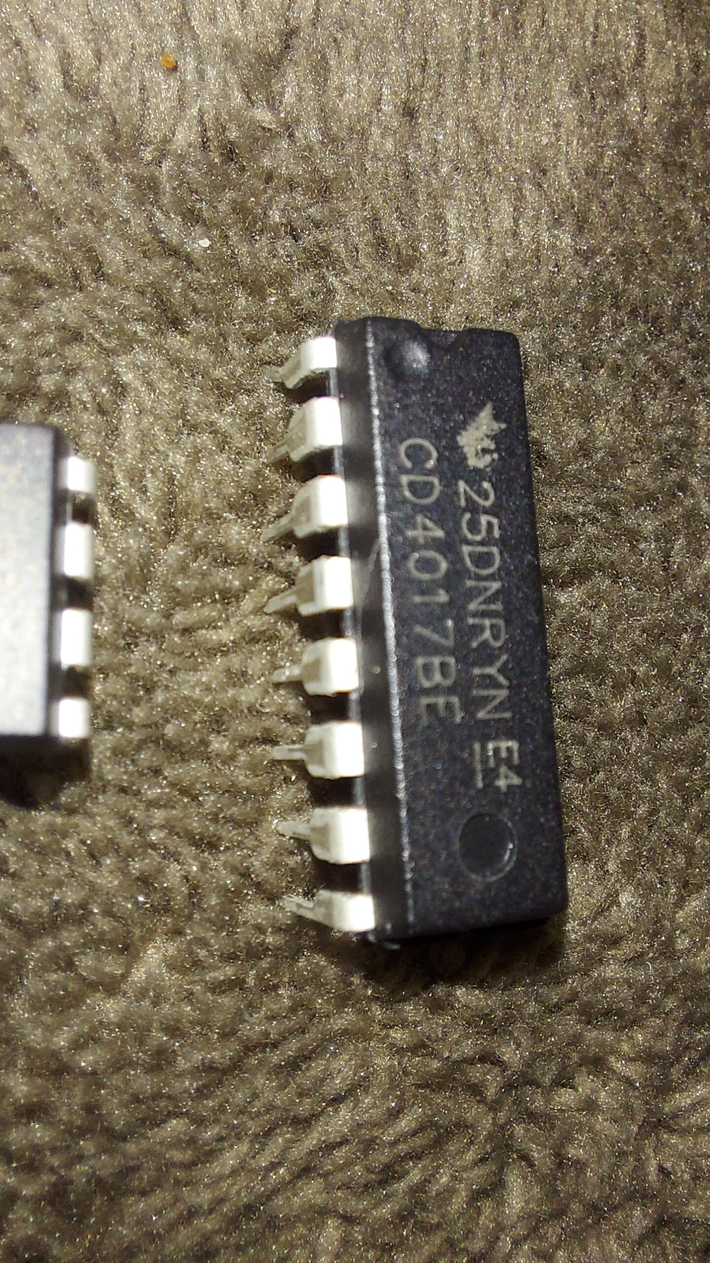

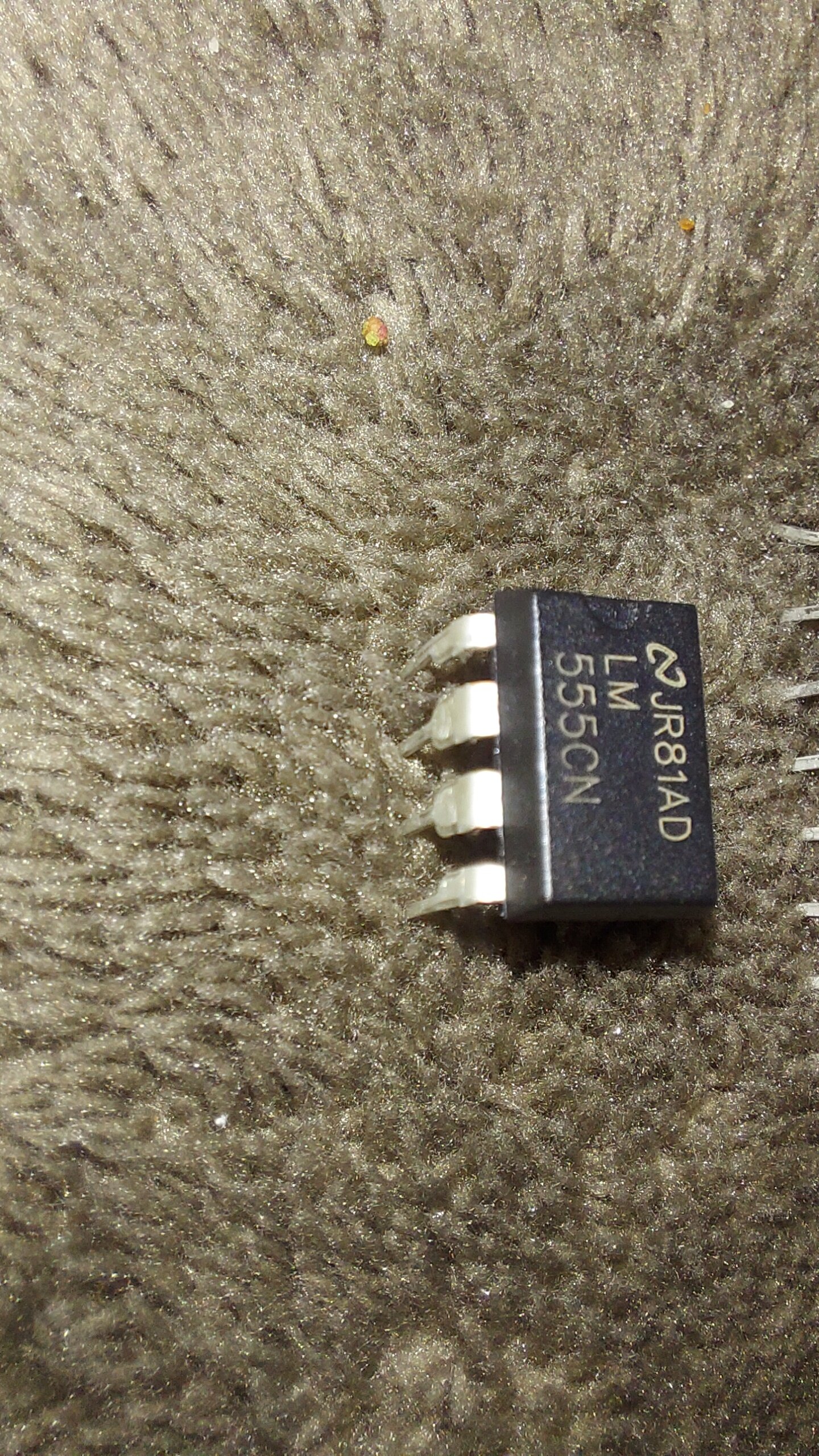

I bought all the components for this circuit and tried wiring it tonight.
I could not get it to work.
Is there a simpler way to test this circuit to turn on just one light to test the circuit?
I wired the timer and got voltage out of the 555 timer. But once I added the output to the 4017, it wouldn't power anything out of the Q outputs.
So I'm not exactly sure what I'm doing wrong.
Included is the components I purchased.
Are they correct?

Sorry, pin 13 (CP1) should be connected to your + power supply (pin 16).

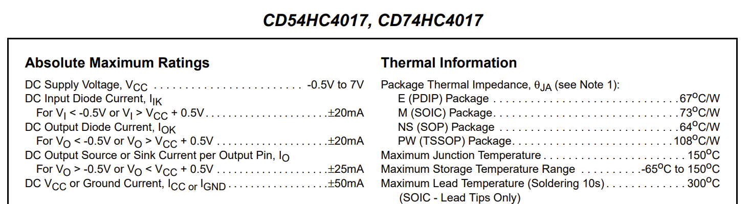

When running on 5 V, the 4017 is rated to source only 1 mA for a full output, and 3 mA for an output voltage reduced to 3 V.
When I connect 13 to 16, it shuts down the circuit.
Using your original diagram you gave me, and putting pin 13 to ground, here is what I get....
LED #1 comes on....stays on for 1.4 seconds and turns off.
LED #2 comes on .7 seconds after LED #1 turns off and stays on for 1.4 seconds.
LED #3 comes on immediately after LED #2 turns off, flashes twice and turns off.
Then the circuit resets.
So, is it possible to have #1 and #2 to turn on and stay on throughout the duration of the circuit?
And, is there a way to have LED #3 to turn on 1.4 seconds after LED #2 comes on and blink 6+ times before turning off and resetting the circuit?
Also, I can't use 3 inputs on the first and second bank of LED's.
If I use 2, it will illuminate, but it's dim.
If I use 3, it wont illuminate at all.
Im using only 1, 3 volt white light LED with no resistor.
using 2 LED's dims them both unless i bump up the input voltage to 6 volts.

Since the part that the OP has is the CD4017, the specs for the CD74HC4017 are irrelevant.
If the drive levels are not adequate, and he has to mod the circuit, why not unsolder the vanilla part
and put in the solution ?
