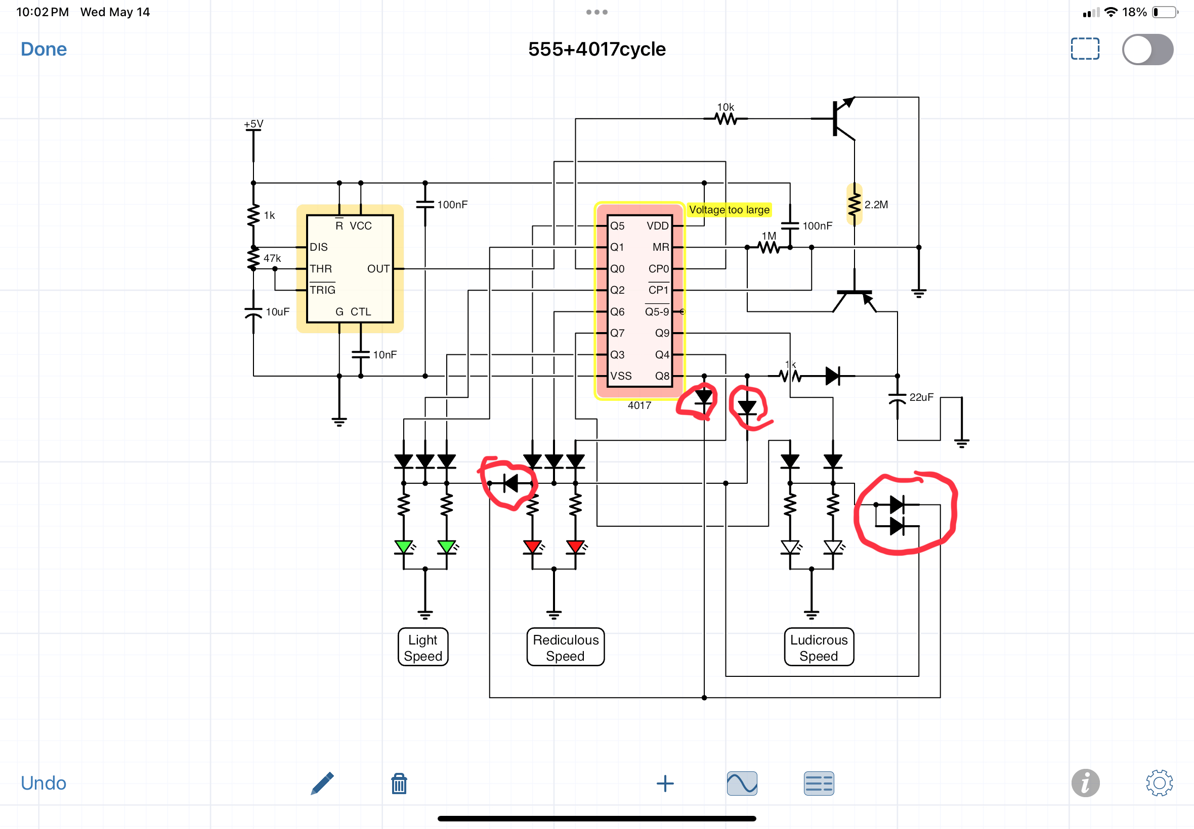

Ok, try this... but, when rediculous speed comes on, the light speed sign will dim a bit.
When the ludicrous speed sign comes on, the rediculous sign will dim a bit (but the light speed sign will NOT dim more).
You can make the dimming less severe by using a higher voltage for your supply (6 or 7.5v). I don't know how noticeable it will be but it may even be kind of nice to have them toned down
Note, some traces moved but I circled the key changes. Just diodes need to be added.

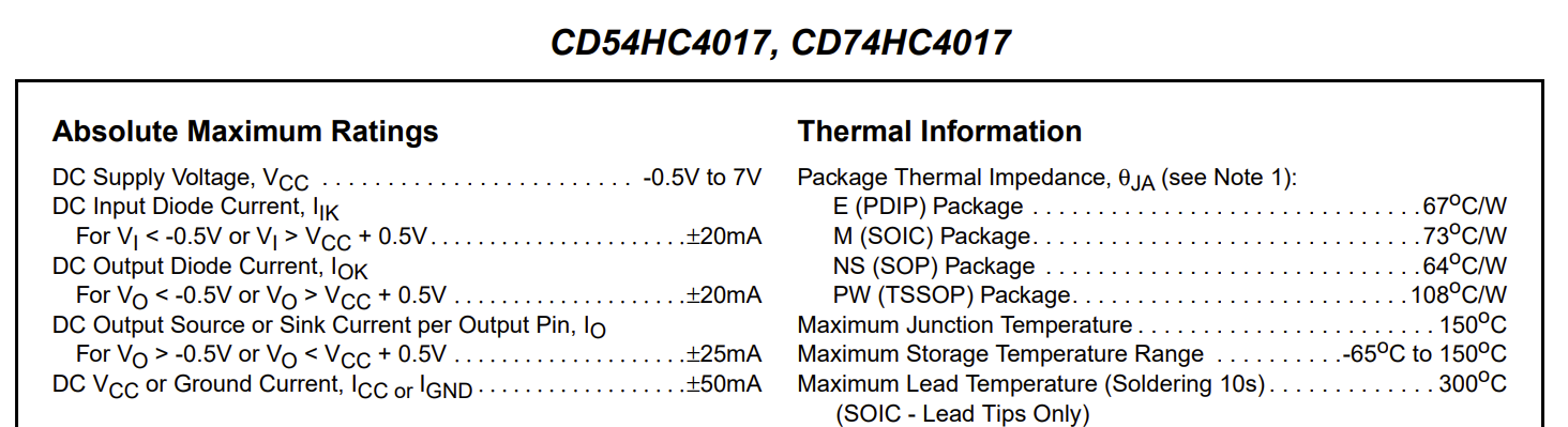

As danadak mentioned, the 74HC version of the part has higher output current, and would be an improvement for a 5 Volt system. Personally, I would add 3 2N7000 mosfets and switch the low side of the LEDs. That would make the output drive current of the 4017 almost irrelevant.
The CD74HC4017 drive level looks like -
No, they do not. And implying to anyone that it is ok to use Absolute Maximum Ratings as design parameters, especially someone not experienced enough to know how dangerous that can be, is dangerous.
The image in post #10 shows that the OP purchased a CD4017B, not a CD74HC4017. The original 4017 part has lower current ratings for both the Absolute Maximums and normal operation. Here is the datasheet for the CD4017B. This is the original datasheet composed by RCA. Note the Output High (Source) Current on page 3 for the 5 V condition.

The datasheet I looked at, and most others, between manufacturers, have limited
specs. The absolute maxes, are guidance, limits, but one surely can infer more than
1 mA would fly. I even found a 74HC datasheet with 50 mA max total Vcc current.
But this is all moot given we do not know how much current already being consumed
be existing unmoded board, current available for driving more additive loads, eg. driver
solutions. Or for that matter what the Voh worst case is in existing unmoded design.
Eg. need for external driver solution, specs over T and V......

When I made up this circuit, I did not include extra diodes in line with the LED's as this schematic showed. As the LED's were diodes already.
Since I'm not familiar with these types of circuits, can you explain the purpose of the diodes in the original schematic and what the additional diodes will do?
Also, any certain value diode I need to use?

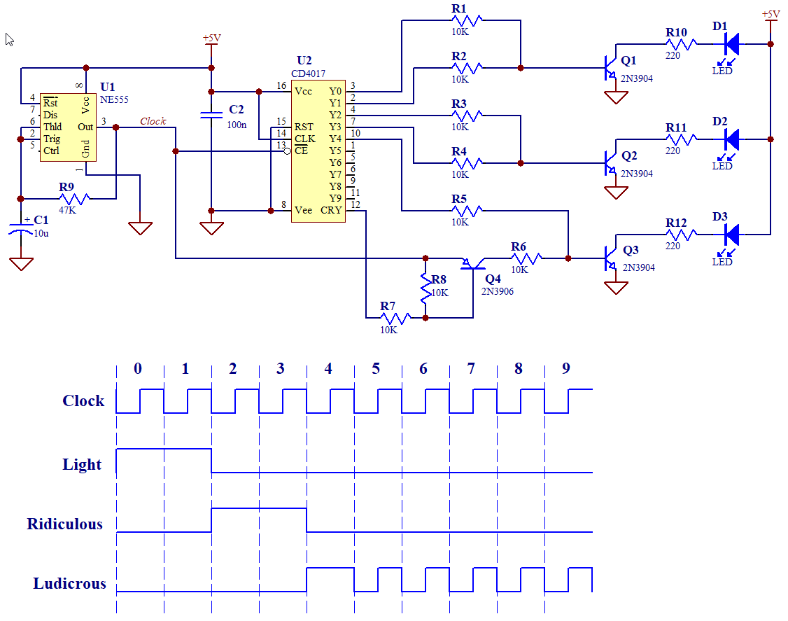

I think that this circuit is close to what you want. See the timing diagram for what the three LEDs will do.
Transistors Q1-Q3 are used to drive your LEDs better than what the CD4017 can do directly. Their collector pins are connected to the negative side of your LEDs. The actual value of resistors R10-R12 are determined by the LED specs.
Capacitor C2 should be connected electrically close to the power pins of U2.

I think this will do what you want.
At power on:
1. Light speed on and remains on.
2. Rediculus speed on 2s later and remains on.
3. Ludicrus speed on 2s after Rediculus speed, flashes 6 times, then resets the circuit.
4. Cycle repeats.
I've used 74HC273 instead of CD4017 because I could make the outputs latch.
I don't know the forward current of the LEDs you are using, so I've used 2V,20mA Leds.
Once you post the actual values, we can make adjustments.
