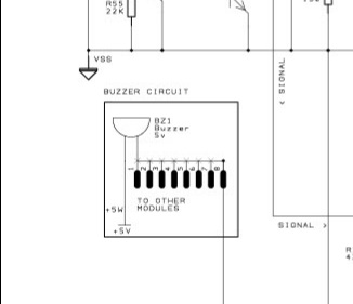

I've saved some room on the circuit board and moved the speaker to its own pcb with leads to the other identical boards. Now when any of the boards called for a beep it will come from this one speaker.
My question is now that I've tied all the leads together id like to keep the pulse coming from the circuit calling the buzzer from traveling back through to the other boards. To accomplish this would I add a rectifer diode to each lead?

Now that I look at this would this even work? The outputs are all high.

What am I thinking. This would never work the way it is. I guess I have learned something. So can this be done? It seems it should. Ive got an array of pins all high. If one goes low the buzzer should sound.

The TDA62003 driver outputs switch between ground and high impedence, so you should be able to connect the outputs together without using a diode. However, the buzzer and modules will need to be referenced (connected) to the same +5 volt/ground supply.

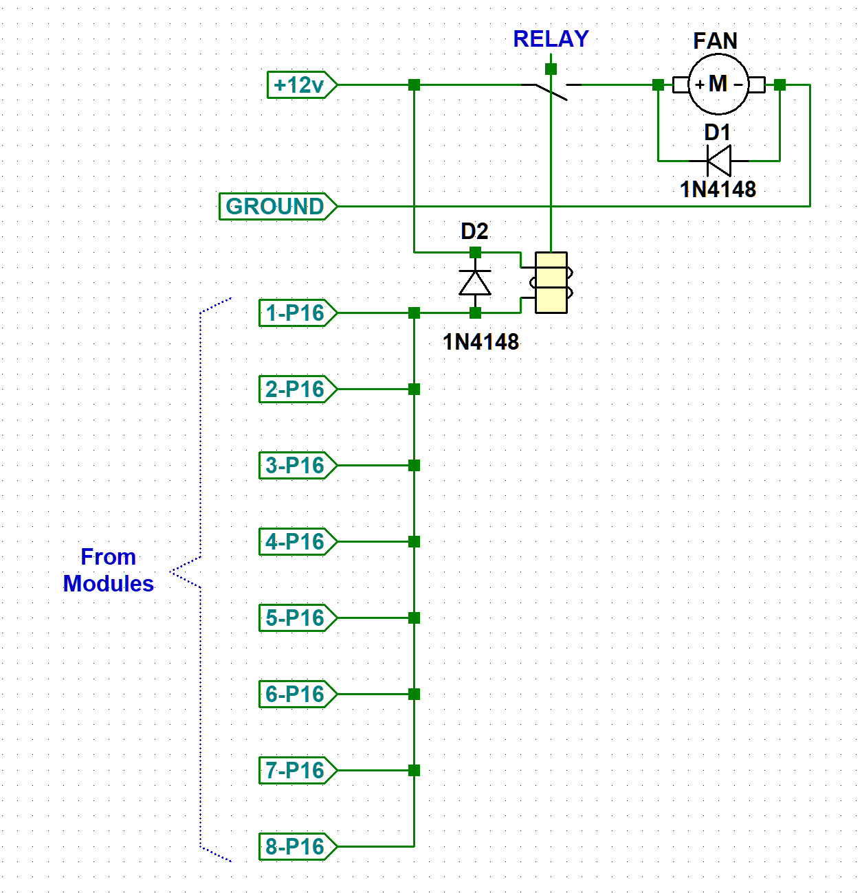

I've got another thing I wanted to do. Its the same as the buzzer but it turns on a 50mmx50mm computer fan only when the relay from any of the 7 circuits is tripped. Basically when the light is on.
I know if I simply tap off the relay that illuminates the light that would work but if I tap all of them and connect to one fan I'd essentially be triggering all the lights when any one relay was tripped. Would this be a condition to insert a diode on each tap so the current won't travel up from one and down the others? In this case grounding all the connections? It would be 12v source.
I see pin 16 on the driver is free. I could use it with a second relay and fan. (one for all) instead of tapping the existing relay
Here is a sample drawing of what I would do.
The fan is shown incorrectly. One side of fan would connect to +12, the other thru relay contact to ground (or visa versa, your choice). Also connect a diode across the external relay coil to prevent back EMF. Connect cathode to +5V side of relay and anode to driver side of relay.

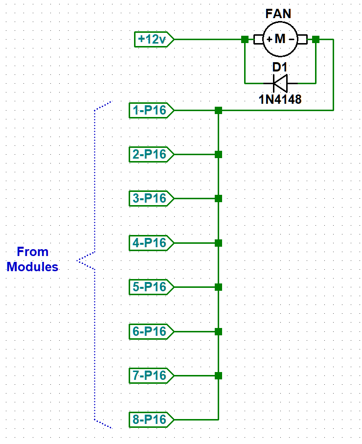

There is another option, but it requires a common ground connection between the +12V and +5V power supplies.
Then you could drive the FAN directly from pin 16 without the external relay.
If you connect as follows, you don't need the external relay.
Connect Pin 1 to Pin 2 at each TDA62003 of each module.
Then connect the FAN like this:

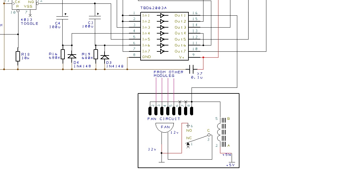

Ive been researching a way to keep the fan running after pin 16 goes back to high for 30-60 seconds. The 555 traditionally is triggered low and outputs high so that was my first hurdle. I found an example that triggers on high through pin 6 but still outputs high. I thought I'd connect pin16 to the fan and pin6 of this circuit. When pin16 went back from low to high the timer would trigger but its output on pin3 is high so I did not know how to overcome that. I really was hoping that I could figure this one out myself. I do however understand some of what I'm reading more that I did last year so I'm pleased with that.

I'm a little confused with what you want the fan to do.
You want the FAN to turn on when any one of 7 relays energize
You want the FAN to stay on untill all 7 relays de-energize.
Then you want the FAN to stay on for 30-60 seconds after all 7 relays de-energize.
So...you want a 30-60 second "delay off" for the fan. Correct?
Hi.
Currently the fan is controlled by pin 16. Anytime the fan is turned off via pin 16 I'd like it to turn back on (or stay on) for an additional 30 seconds.
