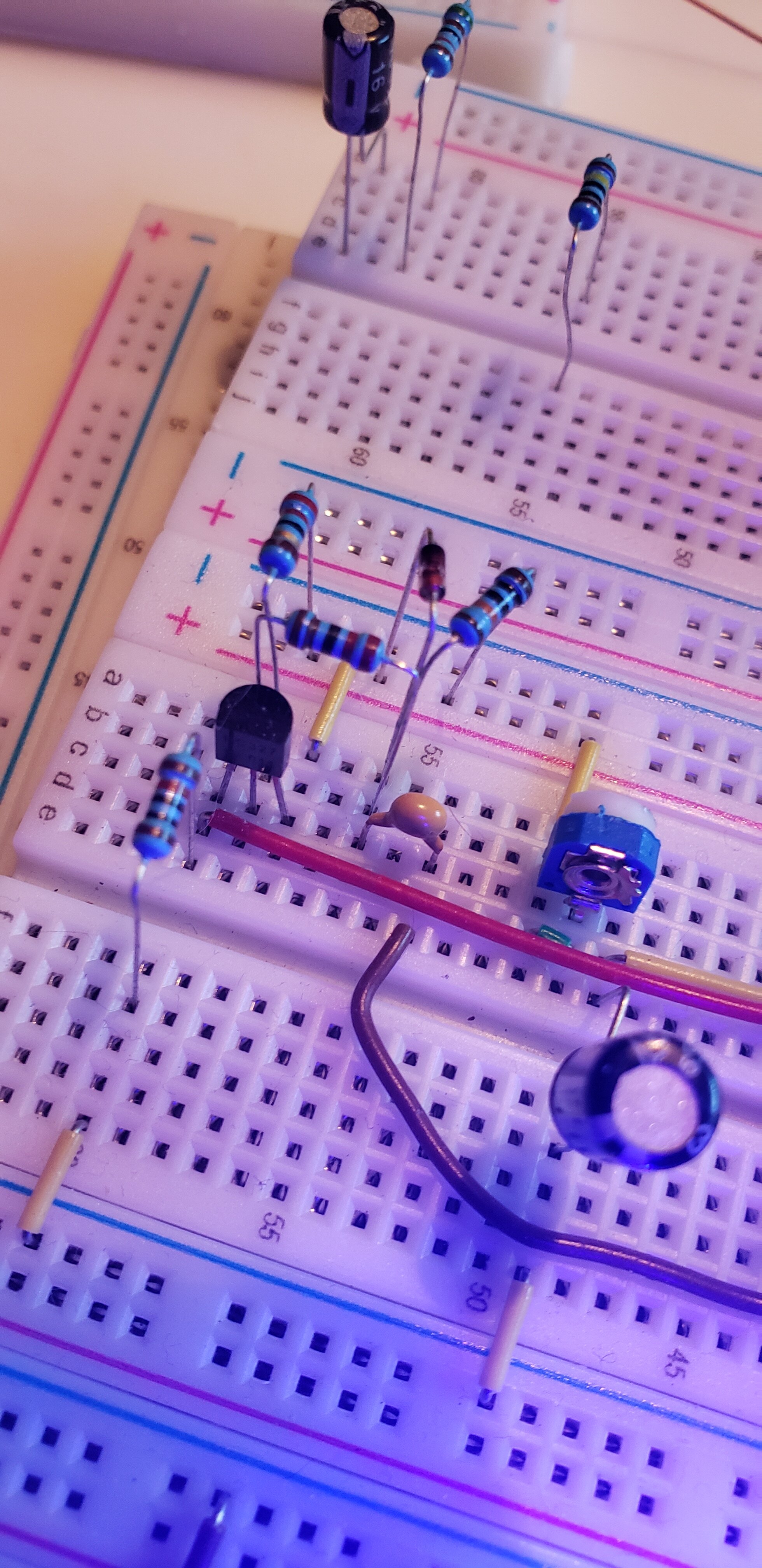

When the timer times out, a short pulse is generated at the junction of collector Q1 and R10. The pulse resets the 4013(toggle). This also deenergizes the relay and turns off the Grn LED.
Monitor the voltage at 4013, P10, and see if you can see the voltage change from low to high. It will be a very short pulse, your meter might not register the change.
So...
Repeat test post #93 while monitoring 4013, P10. At the moment the time expires, you should see a "low" to "high" pulse at 4013,P10.
report back.
I do not detect the change on my meter. Here is the connection Q1 and surrounding components. It looks correct. The pin on the far right of Q1 is documented as the emitter. Am I correct?
I've tried monitoring other components that do successfully go from hi to low (the buzzer) and the meter can't see that either
We need to check/test the Q1 circuit
Looks correct.

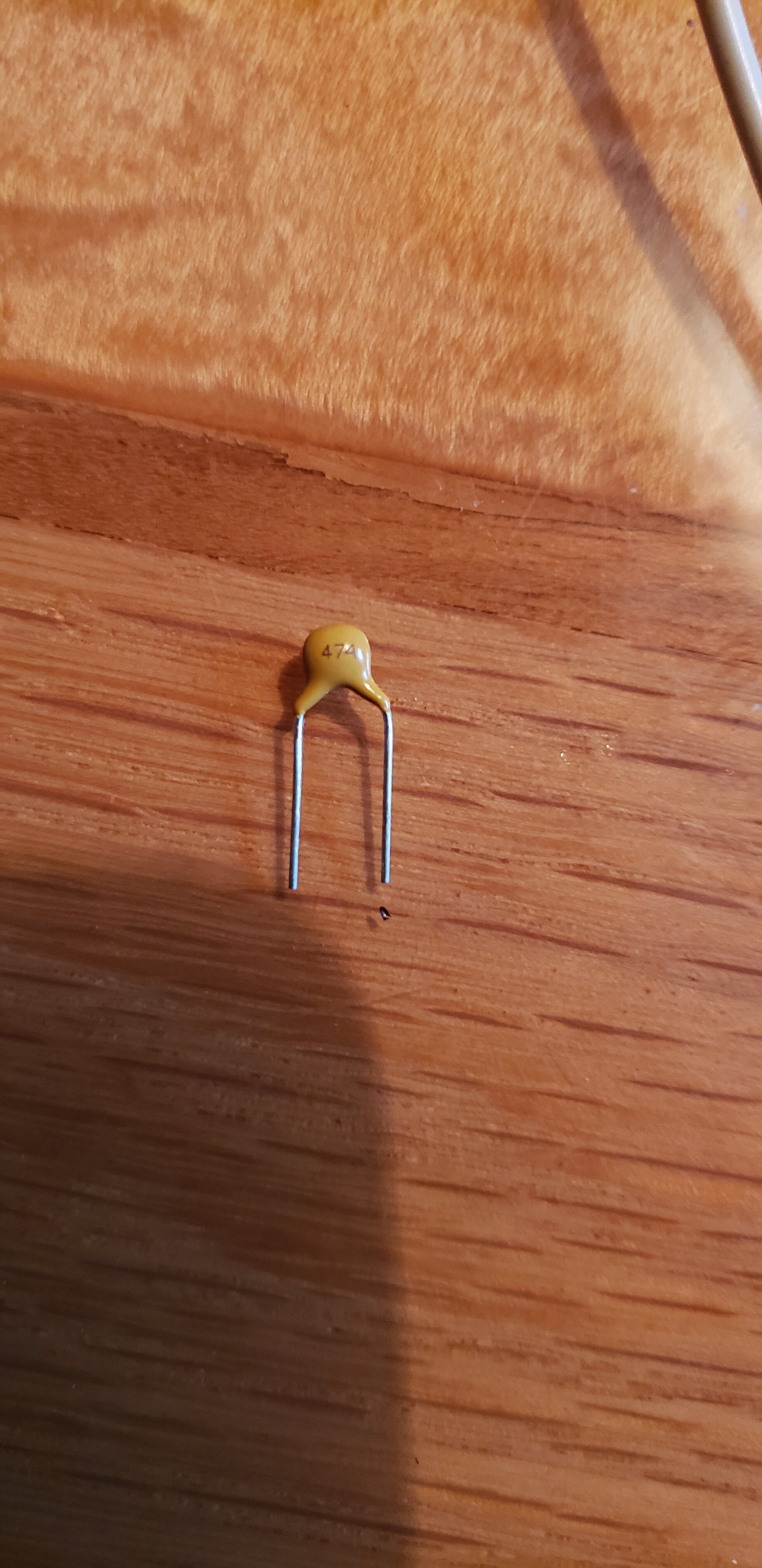

Can you verify the cap value? If it has polarity markings, please check.
We need to confirm the "auto reset" is working.
Disconnect X8 from U2, P3 so it is isolated from the rest of the circuit. We'll try to test maually by touching the junction of X8/R7 to ground.
That should turn on Q1. 4013,P10 should go from low-to-high, and stay high as long as the junction is at ground.
Monitor the voltage at pin 4013,P10
Try this test and report back.
