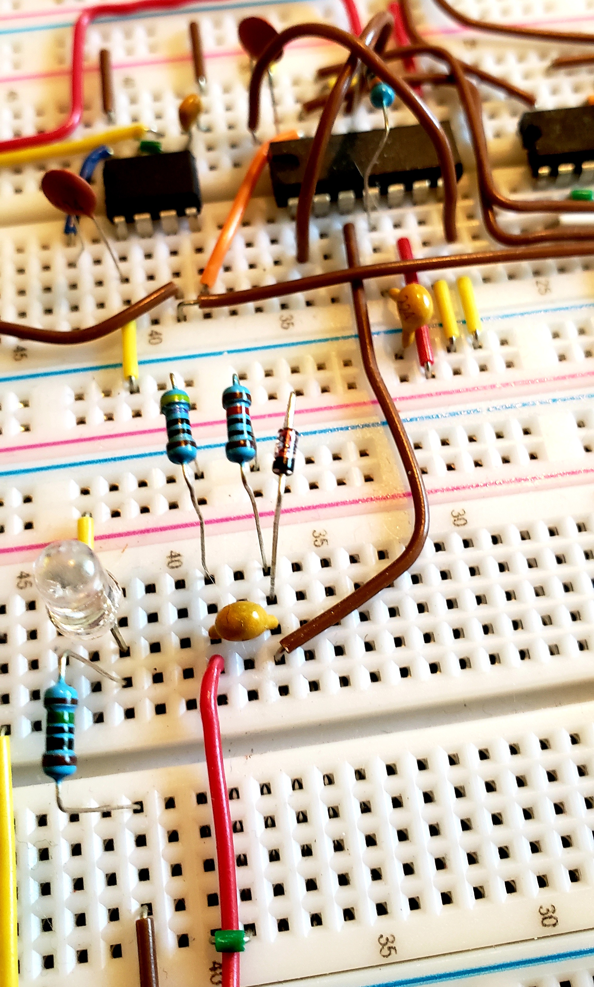

In addition, add a diode (1N4148) from 4013 pin #3 to ground (cathode to pin #3, anode to ground). This will prevent a negative spike from triggering the 4013.
Sorry for the mixup.....
add a diode (1N4148) from 4013 pin #3 to ground. This will prevent a negative spike from triggering the 4013.
Just to be sure I connected the diode the right direction

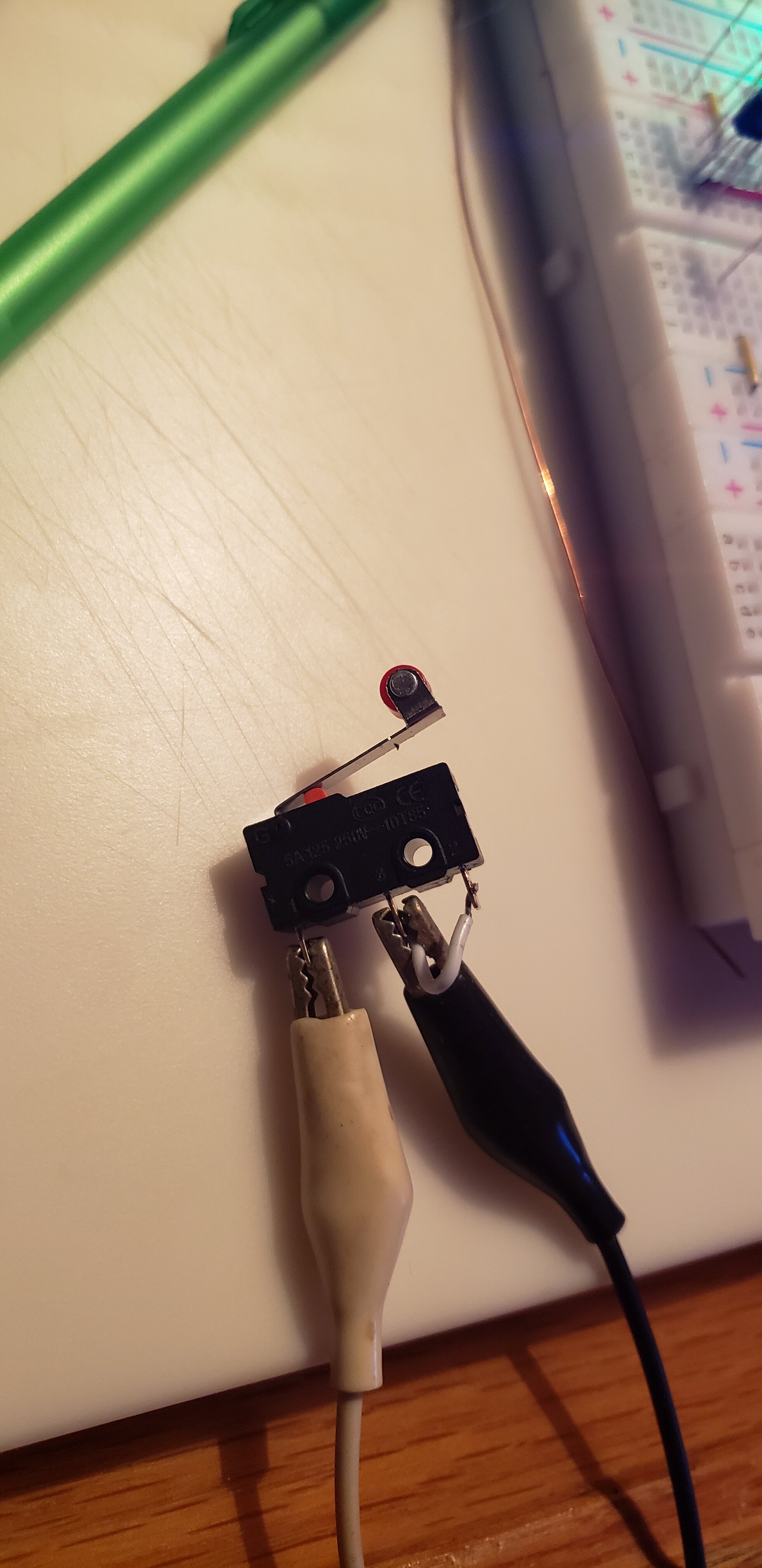

Hmmm...What are you using for a button? Can you show a photo of the button connections?

Also double check the connections to 4013 pin 3. Make sure the wires and components are properly seated.
Check the values of the resistors and capacitor X12,X13...both should be 0.22uf (220nF), 10v minimum. X11 should be 0.1uF.
If the values are correct, then I'm thinking there are loose connections at multiple points of the circuit.
The 4013 behavior seems to be changing in unexpected ways which is probably caused by loose connections.

I re tested all connections and they were sound. You mentioned the type of button and I remember reading something about button bounce. I looked it up and can see you have applied it to this circuit. I then changed the button to one of my no/nc mico pin switchs and it worked without fail 35 times in succession. I then shorted the (no) side and it now works (changes the 4013s state) when the switch is pushed or released. (Sort of like a latching pulse)That would simulate the pantry door opening or closing. That worked over 50 times without fail. That now eliminates the need for another switch circuit. If I only had a scope I would have seen the other buttons behaviour. I then attached the touch switch and set the output to pulse high. It works too. No fail
Maybe not. At this point I don't know what the 555 does to the 4013 to turn it off but I think if its not a signal to pin 3 we could use that along with a transistor or two to help determine if the pantry door is open or closed then it could pass or deny the pulse from the mechanical (on/on) switch. But I'm just talking out loud here.
