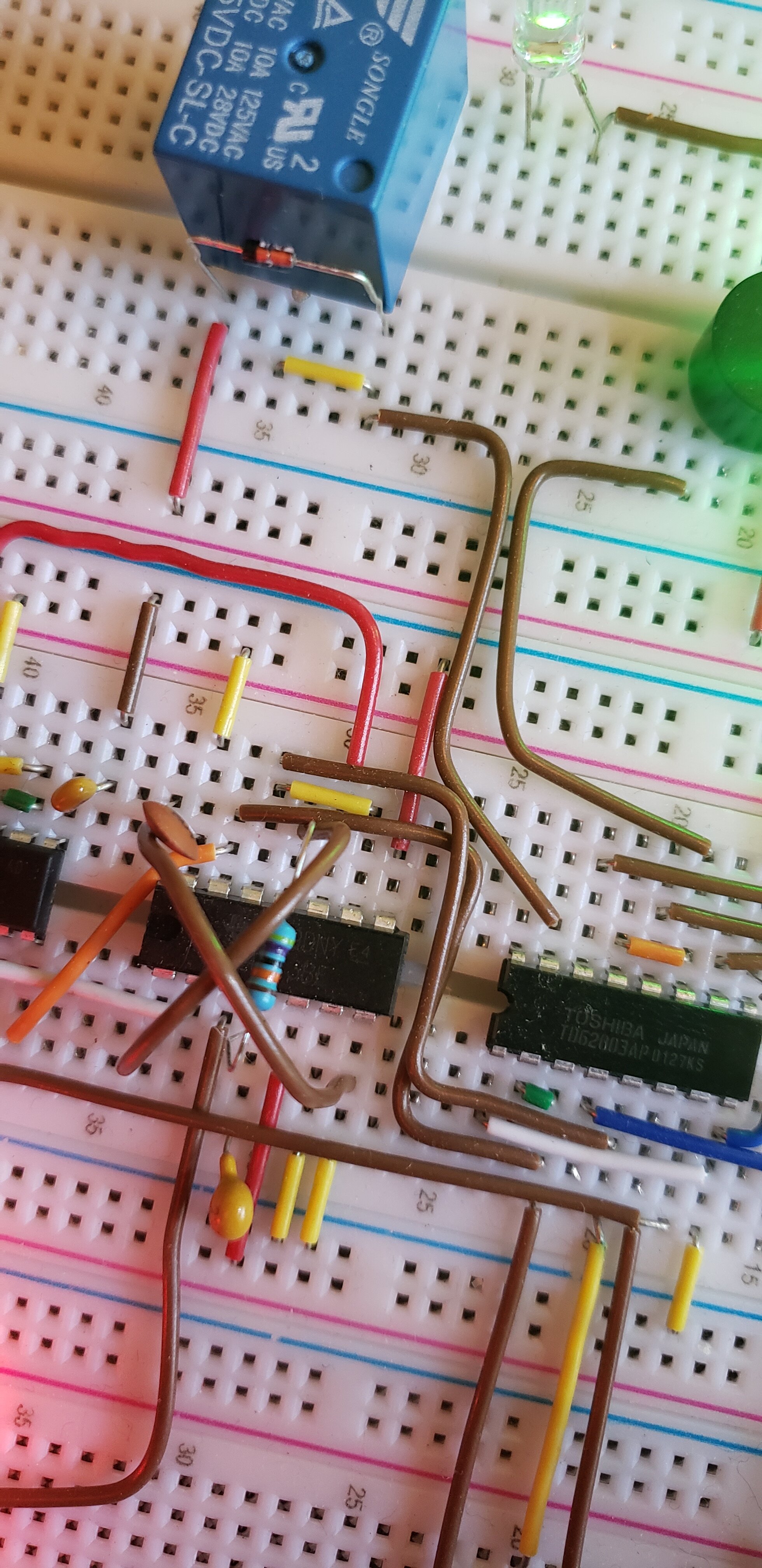

This morning I checked each leg on each chip. I traced all the jumpers. I powered it up. There was some hesitation getting it to work but it does function just as it did last night. I can manually operate it but if I let it time out the led at pin 10 goes out but the relay stays latched.
Some other things that might help pinpoint an issue. The buzzer only chirps for a millisecond and the led im using to visually show that the relay closed is dim. It has the same 150r resistor as the others. Food for thought.

The debouncer hmmm. Something does not look right. Can't verify power. Ill double check it.

I checked the voltage at the "beginning" of the circuit. 5.5v i checked it at the relay 4.8v
Hmmm, seems 4.8v is low with a 5.5v supply.
How much current can the power supply provide? It may be "limiting".

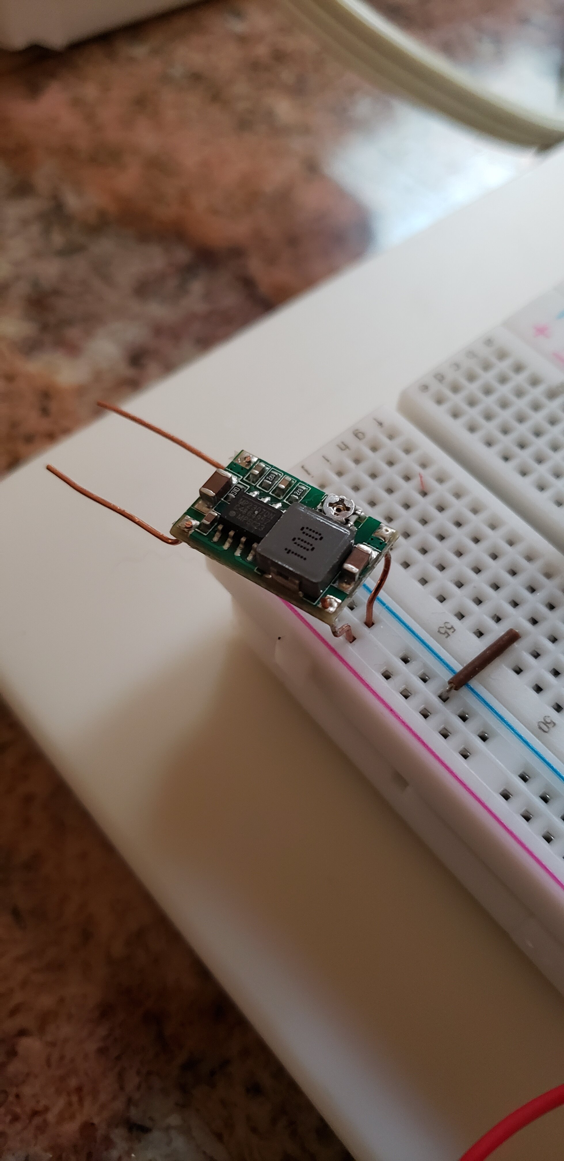

A 12v transformer with a variable voltage reducer set to 5.5v

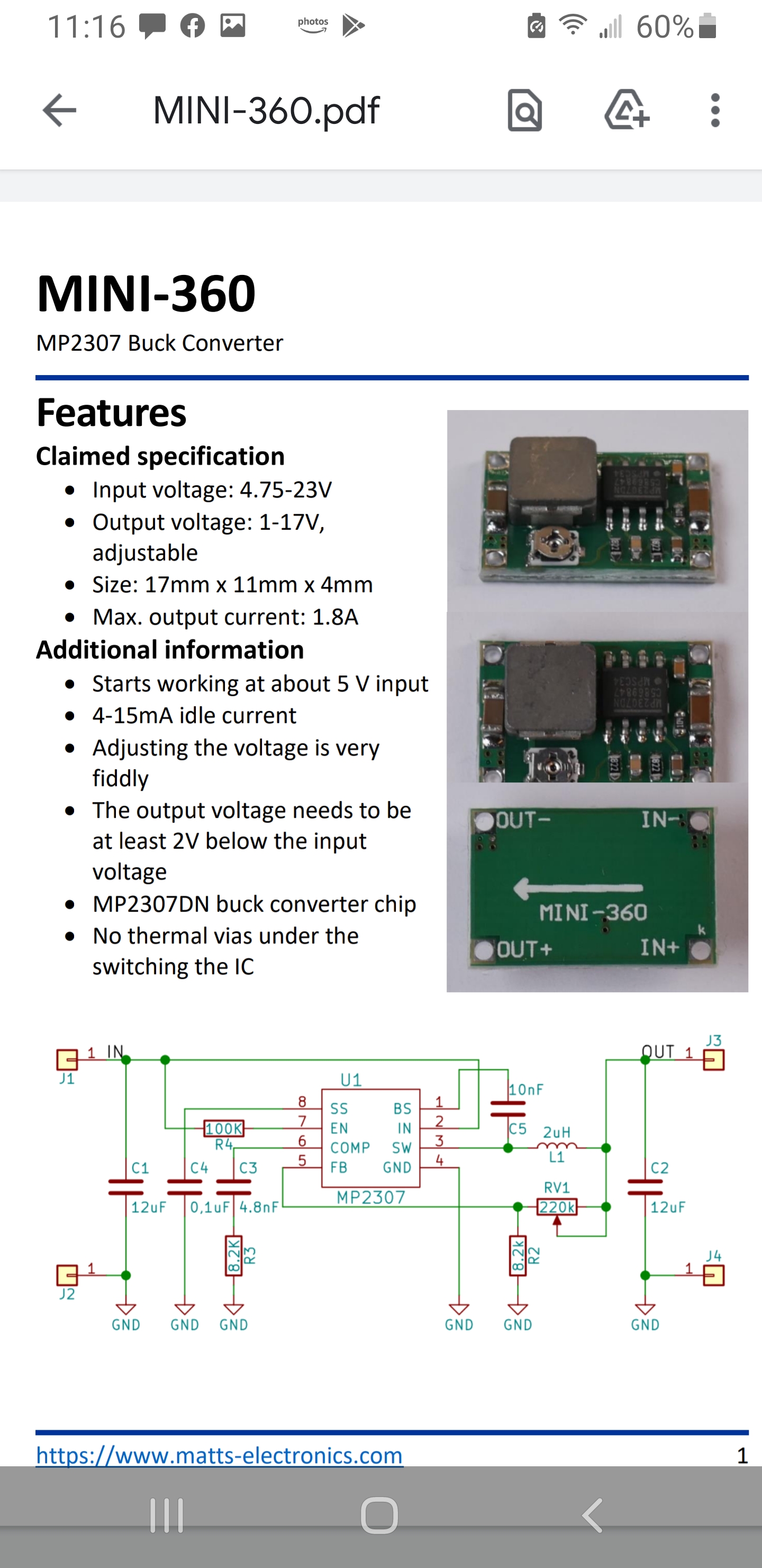

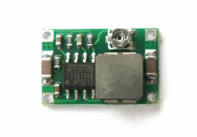

Ok. I looked up the part number on the module. The specifications say it is an adjustable DC-DC converter. So the input you mentioned should be 12v DC (not a transformer I hope). A 12VDC wall wart will work. The output should be adjusted to 5.5 VDC. Did you make the output adjustment?
Here's the link i found to the converter:
Sorry. To me transformer / power supply are one in the same. But I am learning they are NOT. So yes the Ledmo power supply 12v. With this mini-360 attached to its output and diald down to 5.5v
