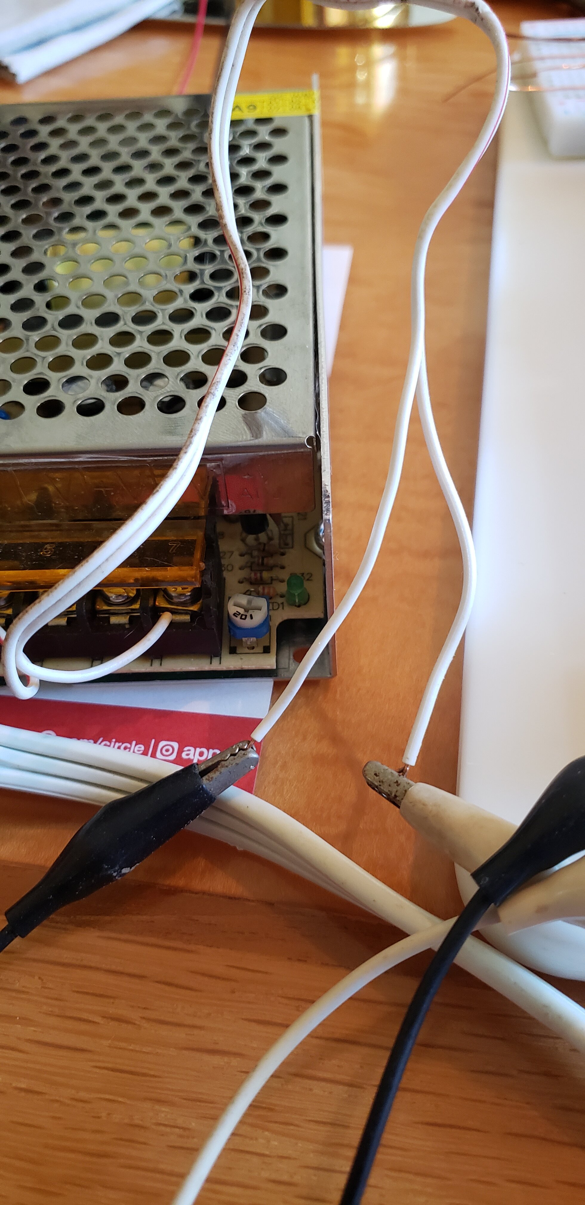

Do have an extra cap we can use? About 470uf,16v minimum?
if so, connect it across output of dc-dc converter.
power up circuit, wait 1 minute, then try 4013 test again.
Report back.
Just to be sure you mean right here? Between the black and white clips? They lead directly to the PS.

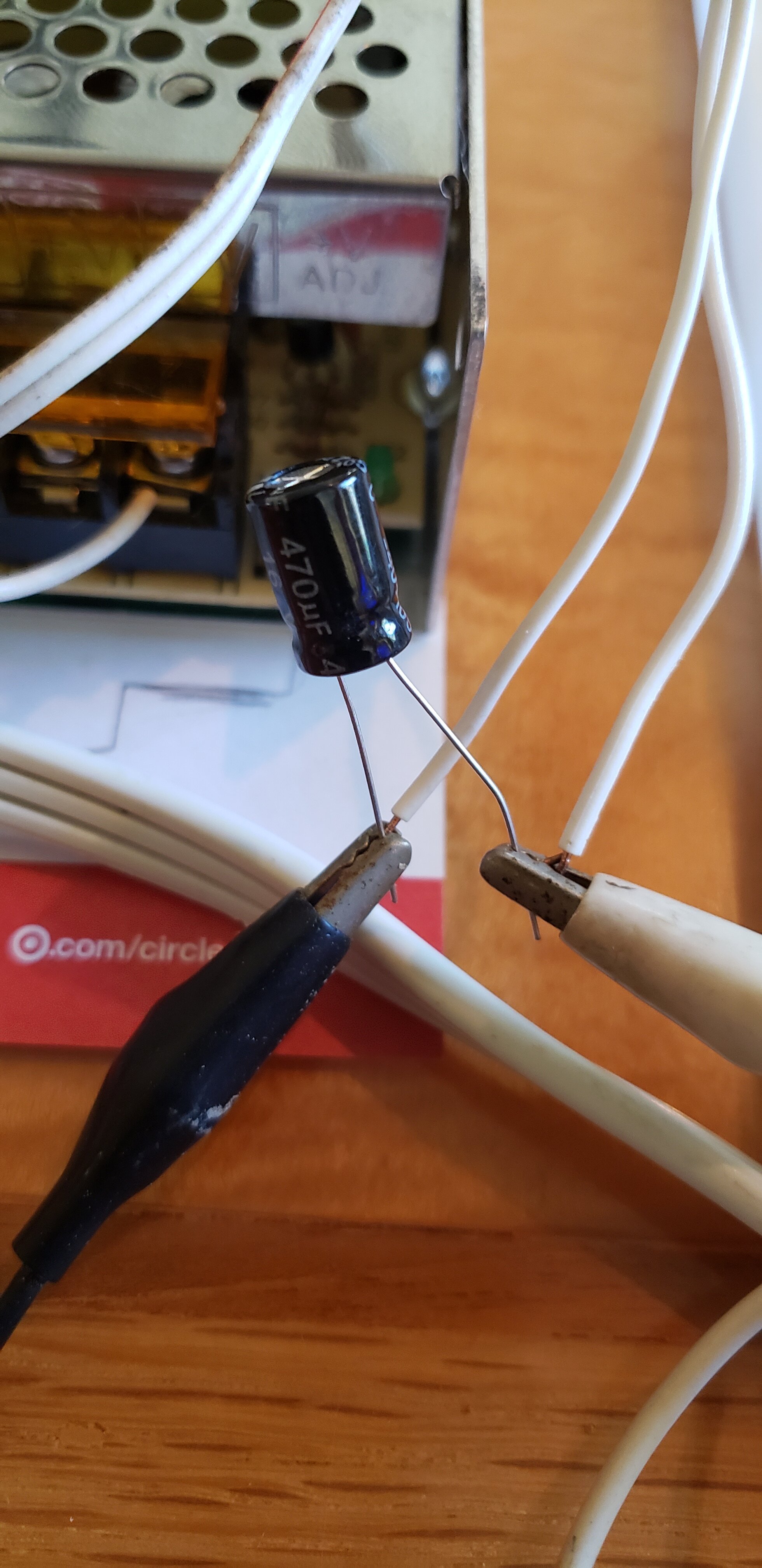

No...connect it across the 5v supply output and the supply wires for the circuit. We want to add some supply ripple filtering. Pay close attention to the cap polarity markings! The cap will pop like a firecracker if you connect wrong. + cap connects to +5, - cap to ground.
Done. No change. Only timer led goes out. No beep, no relay opening. Going to pick up kids.

#49. Did I connect the cap correctly?
This is between the 12v supply, before the mini-360. Or would you want it right after the mini-360

Ok. Test done with cap 470 16v inserted after mini-360.
This time it manually cycled on and off rapidly with no issues. It still does not auto cycle. Only the led goes out and the relay remains engaged. Voltage at pin 13 remains at 5v.
