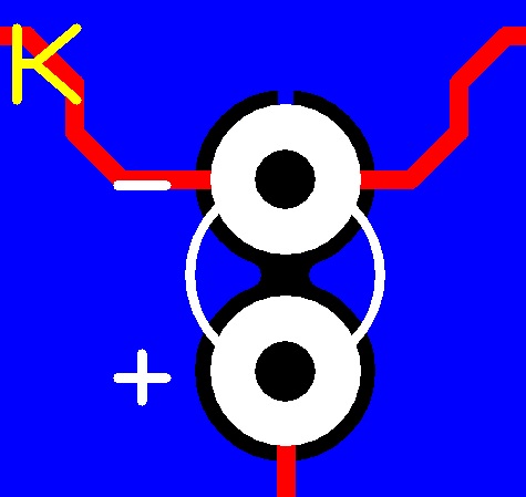

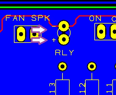

now the only remaing concern i have is the led + / -. They appear to be reversed in the silkscreen. see attached

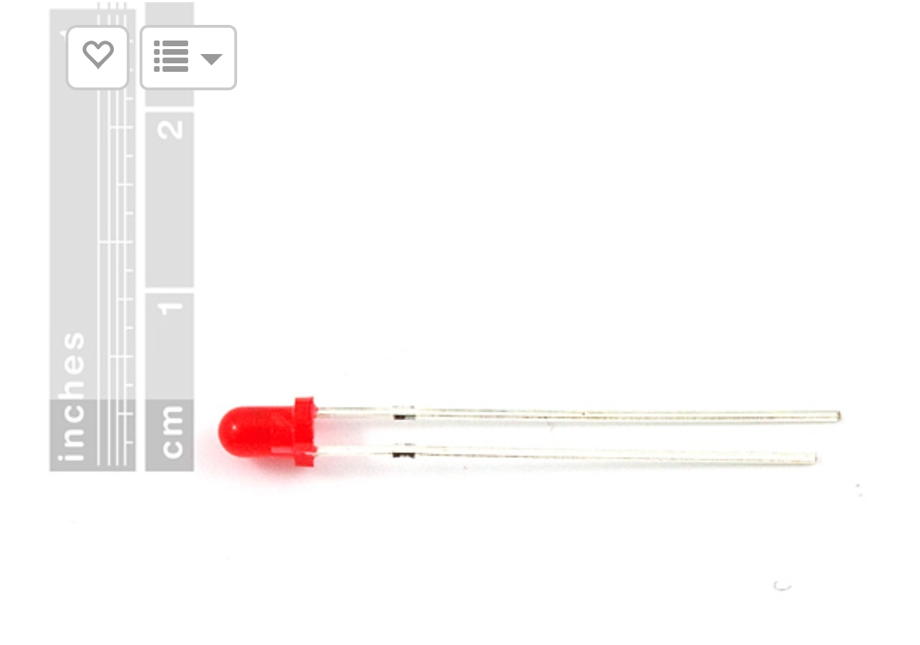

What is the manufacture name and part number for LED?
on my demo board i install the leds with the annode facing toward the front of the board. on this silk screen it appears that the led are to be installed with the cathode facing forward.
i do not have one. they are 3mm.
I cannot emphasize this enough:
Know EXACTLY which LED is going to be used or the footprint cannot be relied upon to work.
Find the LED and verify/modify the footprint before using.
This should be done for any part you haven't used before.
The pin-pads on the existing LED footprint look suspiciously large.
I understand. This is from a lot of 100 multi colors 3mm leds. So the pin pads look big. Courious, What problems could that cause?
A larger pad can have a "heat sink" effect that will cause more solder and heat required to solder the part. In extreme situations, the extra heat can cause the pad to lift and separate from the pcb. If a high quality LED, a large pad may be ok. But, aside from that, I would verify the distance between the center of the pins.

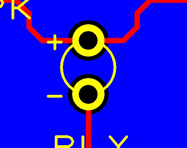

i have edited the file and changed the pad style. the polarity symbols were incorrectly documented. I removed both pours, updated the component, then reapplied both top and bottom pours assigning the GND Net to each. so if this completes the pcb design i thank you.

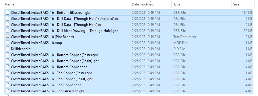

the manufacturing output produced a number of files. i ran autogen and selected all layers for every report. so which ones do i submit? im thinking just the .gbr files

Submit all drill data (*.drl) files.
Submit all gerber (*.gbr) files except:
(paste) (this is only for surface mount PCB's)
bottom silkscreen (submit only if you have silkscreen outlines/text on bottom of PCB)
I gave them everything. All the gbr and the drill files. I had the order number placed on the bottom so they got that silkscreen file too.
