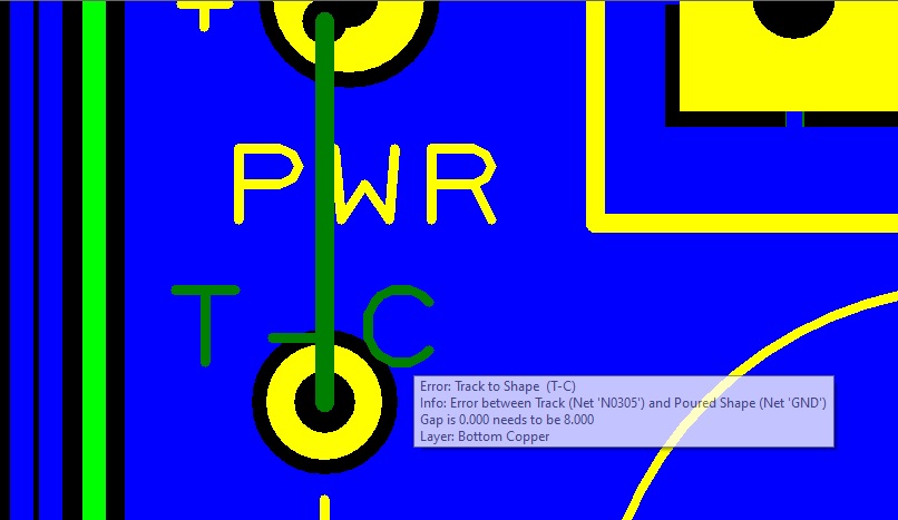

i did get an error when i added the top pour layer. A single pad U3.6 (pin6) did not receive any thermals. the images below show the same area with each layer. is this a problem? the green image is the bottom layer, blue is the top, then one shows both. I can see that the pours did alter my tracks. i can see many tracks in the image that is showing both layers. All very interesting. i hope i have provided you with enough detail to see that i have done a good job here and most importantly that the issue with pin6 is really an issue. it is a DIP socket and not a component.
Pin 6 did not receive a thermal because the pour has no way to connect. It is blocked by tracks. It needs to be corrected.

After the bottom pour is done it adds 3 spokes. no room for other spokes from new layer. so i tried removing 2 spokes from the bottom pour but the program adds them back after i apply the second top pour leaving no room for additional spokes. thank you for your assistance.

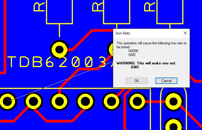

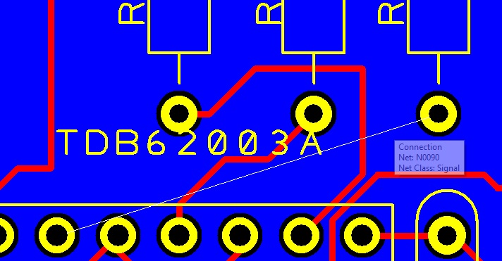

this short track from R11 to pin 14 throws a warning. says im about to merge this with ground when im just tring to route it. i know what it means and ive accidentally experienced this before but im only routing it. im getting this with other tracks. im also experiencing screen redraw issues. the board will go all white or blue, the tracks dissapear, some tracks are in such a state i cannot locate them. what a mess. its almost impossible to work. ive re-mapped a number of tracks. because of the softwares condition im unable to place vias. its just extremely glitchy. yes i said it. Glitchy.
im not upset. I am a software developer and i know how programs can perform perfectly up untill you place one too many elements on the work area and bam! Your file takes a crap. im continuing to poke away at it but i dont trust the file. so many net/tracks are missing.

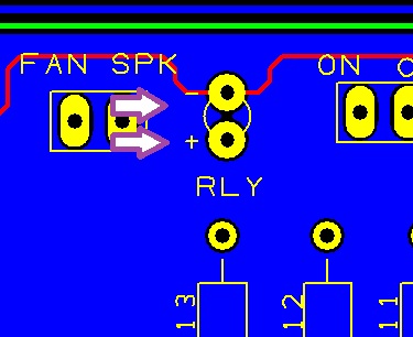

is the led labeled incorrectly? the 5v+ rail connects to the negative pad.
OMG. so i will need to re-map ?
Maybe. you need to check the schematic and foot print against the LED datasheet.
You are not supposed to route tracks with the pour in place.
Remove the pours then route the tracks.
The pour should be applied only after all tracks are routed.
I already explained this.
