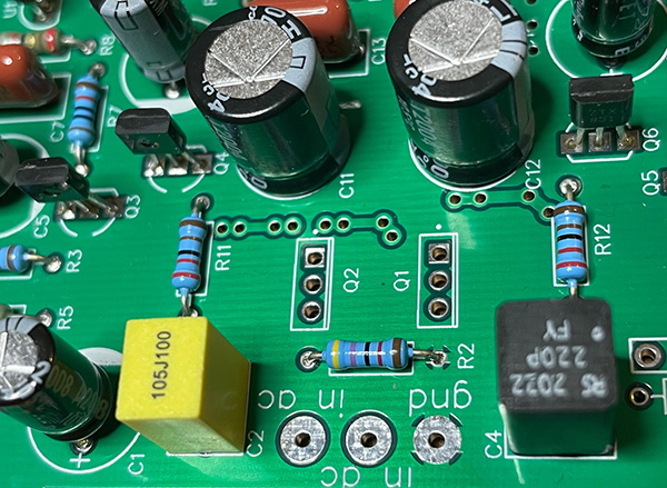

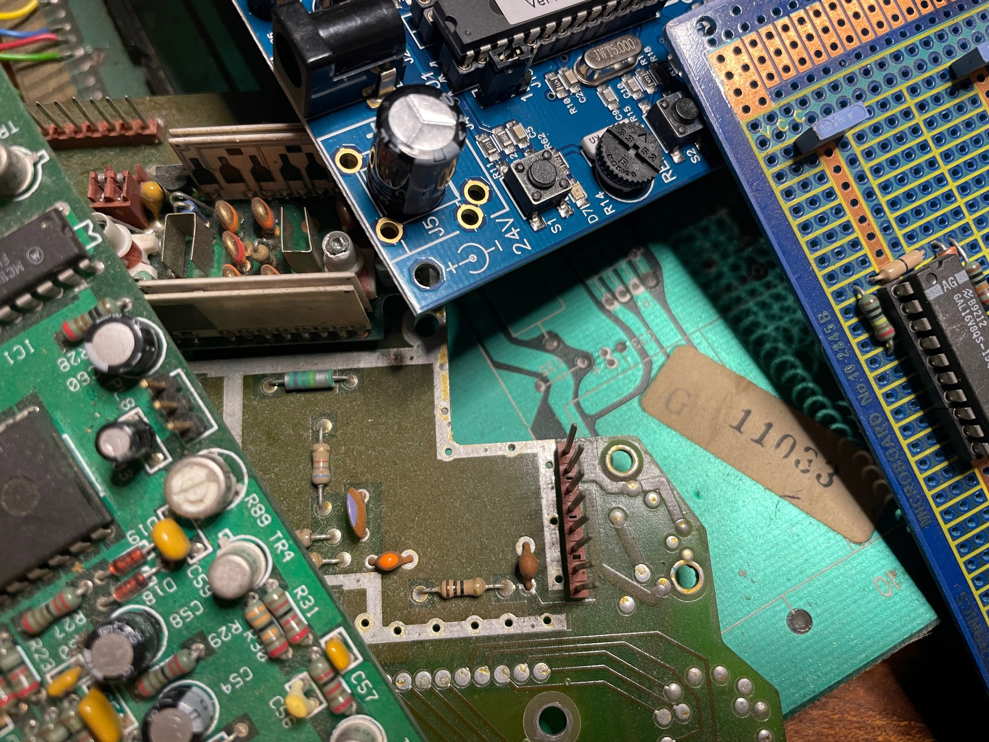

Example below - a board waiting for a few final parts, with an almost complete ground plane, just a couple of segments of track set in it where they bridge other tracks on the underside.
The "vias" are the plated-through holes that connect the top and bottom tracks but do not have components fitted.
For info, It's only soldered on the underside - the solder visible around component leads is what has flowed in to the plated holes as the underside was soldered.

All I can say is that in 50 years of professional electronics, I have never seen a commercially designed two layer through-hole PCB with a ground plane at the underside (other than as fill in addition to the topside ground). Surface mount boards and especially such as RF stripline obviously have different rules.
Example - in a quick dig for commercial double sides boards I found five, all in the photo below. All ground planes on top side only or primarily.
Colander ground plane veroboard does not even have solderable track strips on the top, only solderable points over the solder-side ground bus tracks.
As I said, one of the functions of the ground plane is to act as a signal isolator between components and unrelated signal tracks. It can only do that if it's between the two.

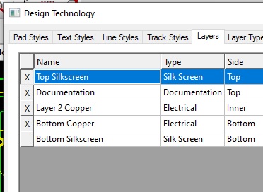

the design i currently have has a 4 layers. two copper and 2 silkscreen. all components are on top. (see photo.)

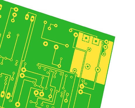

i make a copper rectangle, pour it, then assign it to net "VDD" ground. if needed. (see photo)
You are correct in the context of "virtual" layers of the PCB design tool.
But...the term "layers" in the context of the physical PCB board refers to the number of copper layers.
You board is a double-sided (or, 2-Layer) through-hole PCB. This will be reflected in the Gerber files you send to the fabrication house. When you specify the layers to the fabrication house, you will need to specify the number of copper layers (2).
The ground plane would be defined as a "copper pour" in DSPCB. It is not a silk screen and is usually not added until you have completed all placement of parts and routing of tracks. The "pour" will be need to be assigned to the same net name you used for "ground" before you "pour" it, so there is no need to route tracks for this net as, when poured, it will automatically connect all ground pins to it.

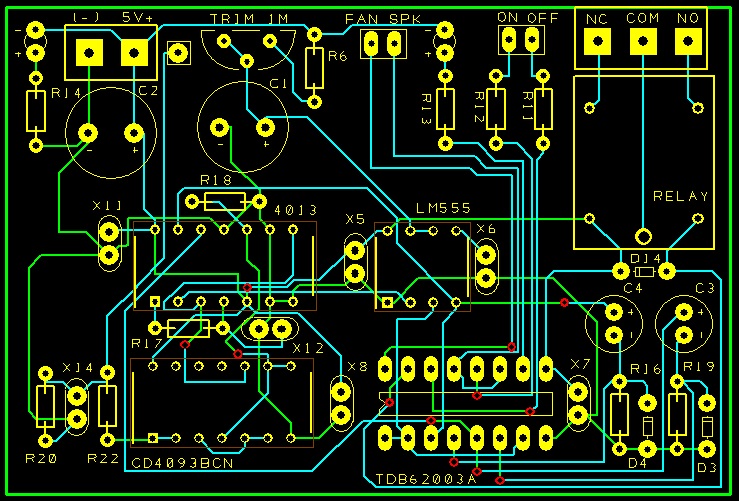

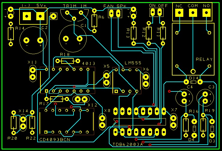

it took me 5 hours but i manually routed the tracks. hot and signals on the "signal" layer, grounds on the "ground" layer. minimal vias (12 total) signals on bottom layer only when necessary. I have yet to ad the copper pours. I need a few "pours" myself. could not figure how to move tracks from over crowded pads

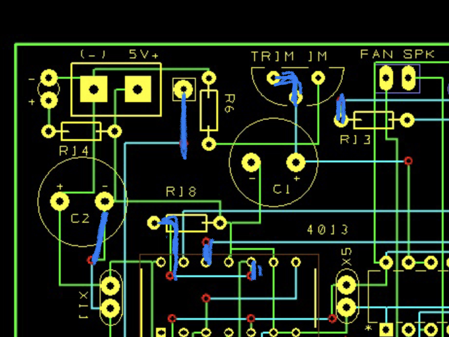

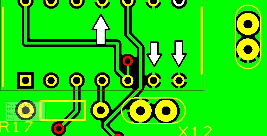

Same PCB with assigned bottom copper pour "Ground pad" i notice all the ground tracks are not visible any longer. i assume they "attached" to the pour layer.

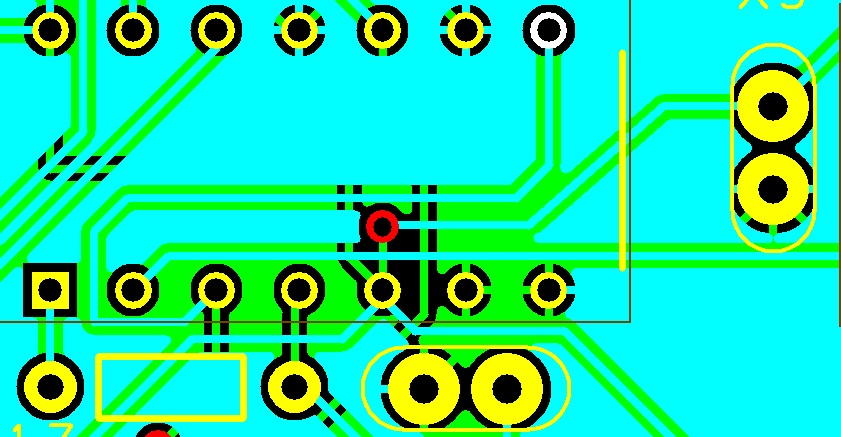

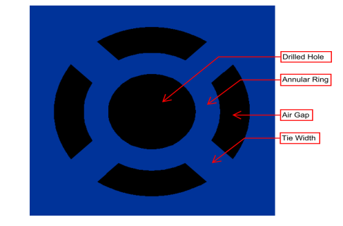

I can't tell the pour from the rest of the design in your image, but yes, any pin pad or track that is assigned the same net as the pour should now be merged with the pour.
Any pin pad that connects to the pour should have a pad that looks like this:
This is called a "thermal pad". It is designed to allow the pin to heat up and solder. Otherwise the pour would draw heat away from the pin and it would be difficult to solder.
You'll need to do a spot check and verify the thermals exist. You dont have to check all, just a couple of them.
Its not unusual for it to take long to manually route a board. I've taken days to route a board. Just depends.
I expect you will make multiple design passes since this is your first board. But it will get easier.:)

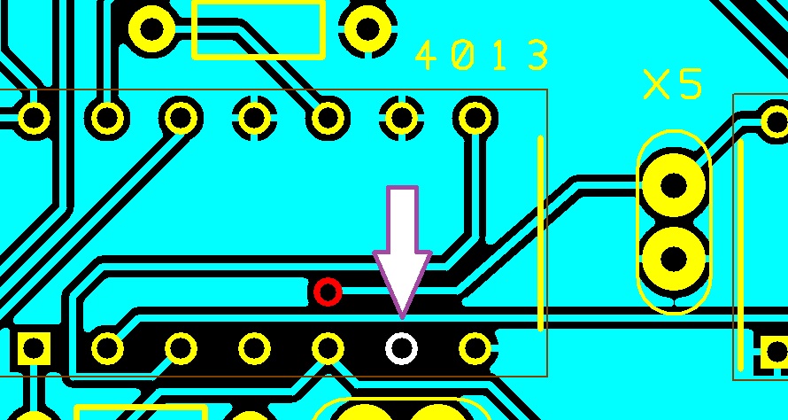

i can see them. some have two and others have more. i assume its because of room and that there are existing tracks going to the pad.
i did get an error when i added the top pour layer. A single pad U3.6 (pin6) did not receive any thermals. the images below show the same area with each layer. is this a problem? the green image is the bottom layer, blue is the top, then one shows both. I can see that the pours did alter my tracks. i can see many tracks in the image that is showing both layers. All very interesting. i hope i have provided you with enough detail to see that i have done a good job here and most importantly that the issue with pin6 is really an issue. it is a DIP socket and not a component.
