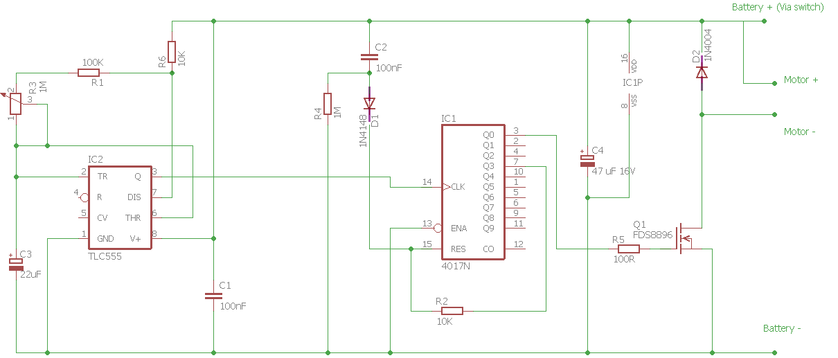

Hi Pete,
I think this should do what you require. The mosfet specified should be OK provided your motor does not take more than about 5 amps.
Les.

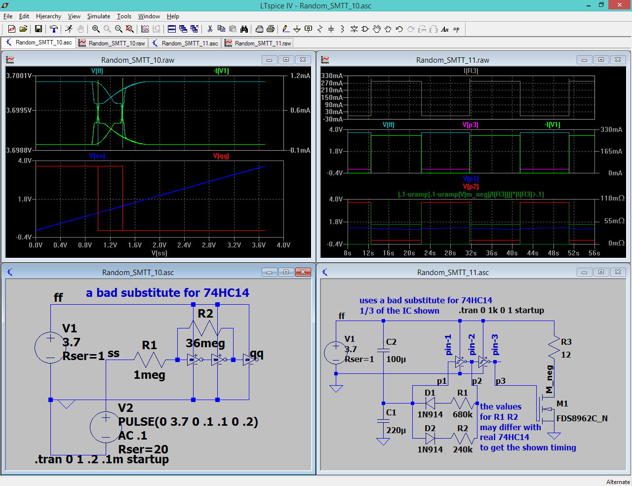

**broken link removed** ( • power supply specs./requirements: 12V DC / 100mA )
in case of ?conventional? relay ~360Ω it will require steady 33mA and will likely tolerate ?? down to 10V ??? 9V supply in worst case
while FDS8896
they have attached the MK111 manual enables to cross ref how to replace relay with anything else e.g. such as MOSFET
Hi Pete,
If you changed the value of R1 from 1K to 68K then the pulse length would be adjustable from about 6.5 seconds to about 11.5 seconds so it would give the timing that you want. If I was doing this I would just use an 8 pin microcontroller (Such as a PIC12F629 or an ATtiny13A) and a mosfet.
Les.

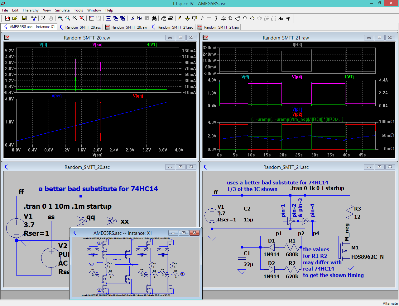

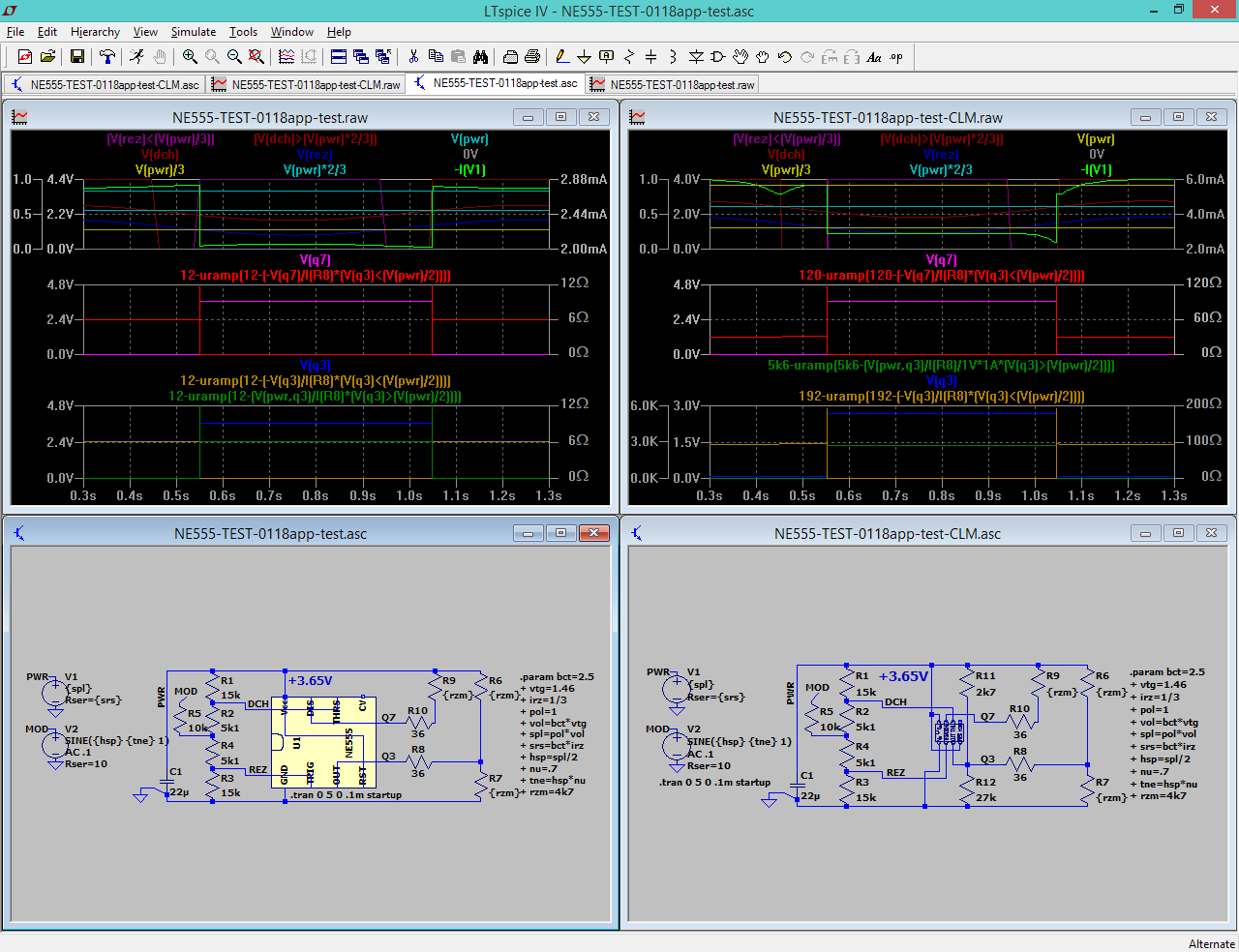

there's a doubt as well as possibility the 555 being capable operating from 3.7V Li-Ion - i'm not into running that test in real
but if the results for R.CE for pin-3 and pin-7 are reasonable (below 500Ω) the use of 555 based gizmos are justified
otherwise you can adapt random Schmitt Trigger or Comparator based oscillator as in this → example
by replacing R2 & C2 with greater ones
as ▼▼
update: ((now without node name errors))
