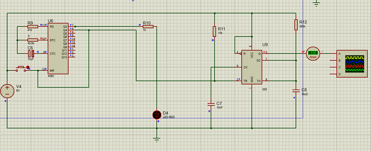

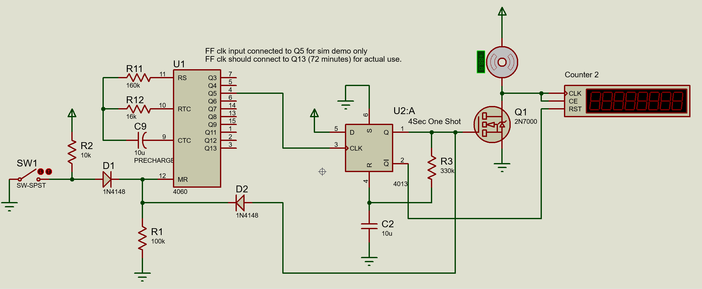

So, I've made some progress on my project. Since 6 hours is too long, I divided it into 5 segments, resulting in a 72-minute delay with a 4-second activation time. I also removed the 555 timer and only used the CD4060BC because it's the more simple and why i BC because it is the only available.
I set the frequency to 0.25 Hz because I need the output from Q4.
There is no Q1 and Q2
this is my calculation
so my circuit look like this
(this is the real one, but i make the shorter to see anything wrong)

Additionally, I'm facing a problem where the oscillator doesn't loop when I split the output to some load.
Got stuck like that, idk why is it grey

Connecting an LED directly to a logic output not a good idea. Your logic
level into and gate most likely never meeting a "1", see spec. Use a R in
series with LED to limit its current and allow the min logic "1" to be achieved.
Freq accuracy for this device is HORRIBLE due to device and C changes,
see timing variation :
Regards, Dana.
In a real circuit, you'll have to tweak the RC values. 4060 timing cap should be non-polar type, so if a large cap, use two polar caps connected in series. Using RC timing components will be a compromise on accuracy.

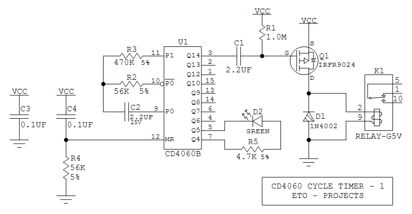

First pass concept schematic for 4 seconds on, 72 minutes off, one chip, and no 555.
The ratio of 4 seconds to 72 minutes is 1080:1, while the maximum output period ratio for a CD4060 is between Q4 and Q14, which is only 1024:1. Thus, the outputs of one 4060 can be decoded to both intervals only if the output ratio spec is reduced slightly. One option is 4 seconds on and 68 minutes 12 seconds off.
Even with that, the output gating is a bit messy. Adding a simple pulse-former to the 4060 Q14 output separates the output pulse width from the overall period.
In this schematic, all component values are approximate.
C1-R1 set the relay on-time.
C2-R2 set the overall cycle time.
C4-R4 perform a power-on reset.
D2-R5 are an optional heartbeat indicator to show that the timer is running.
The circuit pulses the output once at power-on, then enters the long off period.
ak
I have some little time delay relays with long delays.
They do not use a 555 for long delays because the oscillator is not stable at very low frequencies.
They use CD4541 or CD4521 IC which has an oscillator and 24 stage counter.
Circuit copied from the internet. I do not know about it. 3-switches to set how long the counter is and a pot to fine adjustments.
The 4541 is great for extra-long delay periods, but it has no advantage in this application other than allowing for a timing capacitor that is 4x smaller than one for a 4060.
The 4521 can use an even smaller timing cap, but still does not have enough counter stages brought out to decode a 4 second pulse in a 72 (or 68) minute period.

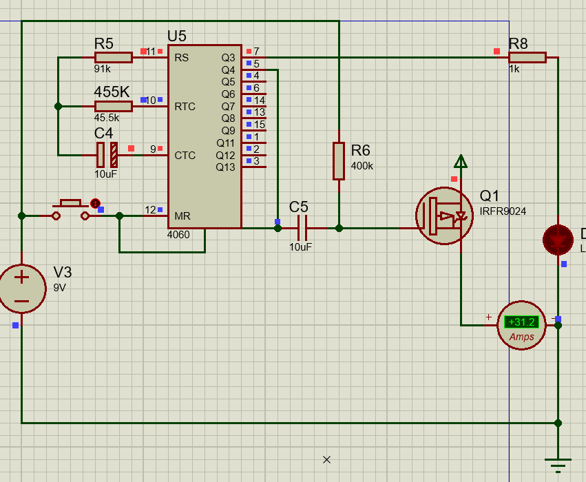

How do you generate a pulse using a timer? I tried connecting all the VCC (positive supply voltage) terminals to a single battery, but the outcome was unsuccessful. The current didn't increase or decrease; it remained constant. Additionally, when I attempted to connect a motor, LED, or relay, there was no response. How can I calculate the pulse using an R-C (resistor-capacitor) circuit?
is it
tau = R*C
R = Tau/C
R = 10^-5/4
R = 400k Ohm
if that right then my calculation should work
Or is it error because different type of mosfet ?
tried it with a 555 timer, but the outcome is almost the same; it didn't even reset the counting.

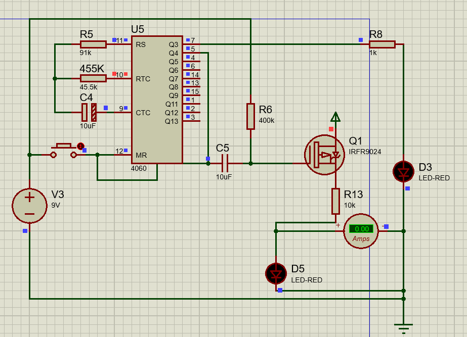

In the schematics in post #34, the Q1 drain and source are reversed. Also, R13 is very large for an LED current-limiting resistor.
Beyond that, I don't understand things. Are these supposed to be my schematic re-drawn into a simulator? If so, there are several errors. Why is the Q4 output connected directly to the 4060 Reset input? Why is it being used at all? Why is there a 455K resistor in the oscillator?
In your calculation you indicate that the pulse width you are trying to calculate the components for is 10^-5, or 10 microseconds. I thought you wanted an output pulse of 4 seconds.

If you use RC timing components at the gate of the mosfet like that, then the timing is heavily dependent on the mosfet vgs(th), so timeout can vary depending on the mosfet batch/manufacturer.
sorry wrong number
R = tau/C
R = 4/(10*10^-6) (that why i write 10^-5)
R = 400k ohm
and this is your design in proteus
And this is your design in Proteus. I have a question about how the reset will function in a setup like this.
I connected it because I thought the reset should occur when the output from Q14 is on.
So, in that circuit, I want to check the output from (R6, C5, and Q1) in your design (C1, R1, and Q1), but it still doesn't activate for 4 seconds.
