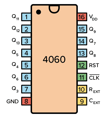

Also, the Q divider outputs on Tony Stewart image of the CD4060 doesn't align with the datasheet.
what is Qn ? and can you looping it ?
The 4060 from website who shall go nameless uses Q3 to Q13 which is wrong label but follows binary convention from Q0,Q1,Q2 etc.
While the original datasheet uses Q4 to Q14 to match powers of 2 for divider starting from Q1,Q2,Q3 ....
But the pins match functions in both IC's CD4060 and 74HC4060
while the 74HC4060 which has a lower driver impedance uses letters QD to QN even worse but avoids the embarassing correction to binary addresses.

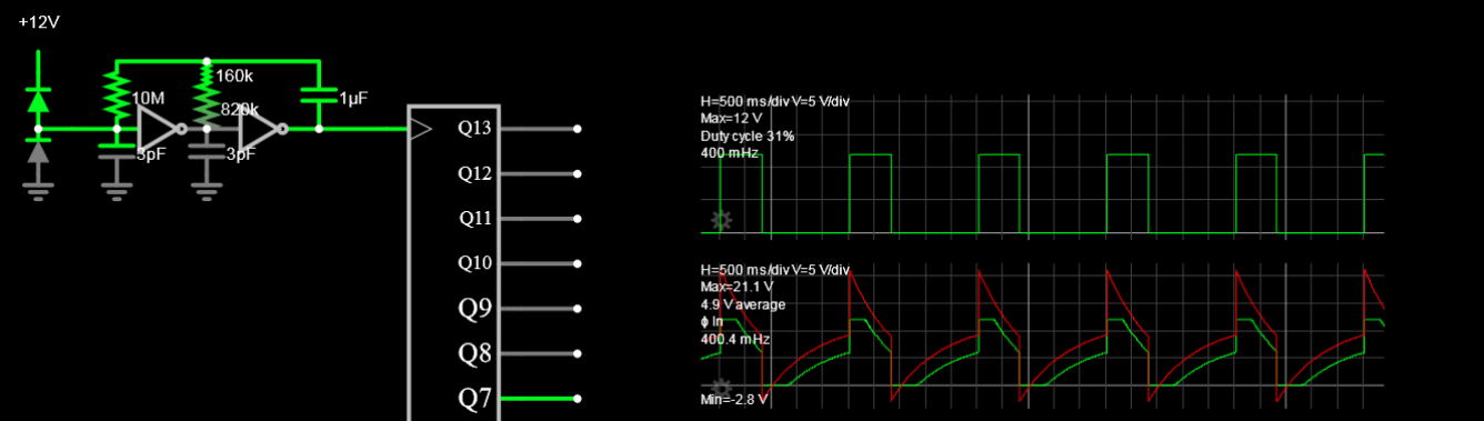

1708498076681.png How did you compute T ? there are reasons at really slow clocks this is inaccurate.
It is like a flashback to 1976 with all these 4060 solutions, assumptions and things overlooked in accuracy.
Above is the original formula for one period, T of a clock cycle.
Using 10 uF electrolytic capacitors will experience reverse voltage (not accurate) since the average voltage differential is not zero. The clock R-RC junction average for Vcc=12 will be 24Vpp and will be offset from Vcc/2 will be the inversion of the input offset threshold roughly..

If it were not for the internal ESD protection diodes the input would be 2*Vcc= 24Vpp
Things to remember using the 74HC/CD/4060:
  1. This CMOS IC has threshold tolerances like all CMOS and the RC timing here is not linear, rather it is the sum of two exponents clipped by ESD protection and switches with some variable offset to Vcc/2 +/- xx % at room temp then varies with temp.
What errors did you measure, expect and use to calculate the period T?
When taken to extremes, electrolytic capacitors leak with an equivalent resistance of Vtest/Ileak=Rp and each e-cap family has different Rp*C=Tau time constants and varies with temperature and quality specs. A small e-cap might have Tau = 10 seconds. This can increase with bulk size of C and quality.
Electrolytics leak far more in reverse voltage and fortunately this is current limited otherwise it might explode. So beware using e-caps for timing errors in this circuit. Although I simulated an ideal cap.
These may also apply to some modern uC that use RC external slow clocks.
  1. See the actual input to the 10xR inverter input below assuming Vcc = 12V on CD4060. (Red plot=24Vpp)
  2. If you do not report what you used, calculated and measured, then we have no error to correct.
  3. Remember this is a ripple counter so latency and rise time with different thresholds may cause gating multiple outputs to have glitches during transitions as the latency accumulates after each ripple /2 count.
  4. If you use another matching 10*R input to Vcc the 2*Vcc_pk-pk would be reduced in half and no long have in the internal clipped ugly waveform ( that you cannot measure accurately because the low current (5mA) Schottky diodes must have 50 K current limiting R's in front to survive the kV ESD tests. Then there must be 2 stages to ensure no shootthru.
