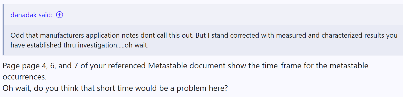

If the cap is charged thats when the potential problem occurs if Vcc is removed and it rapidly collapses
>> faster than the RC discharge you mentioned.

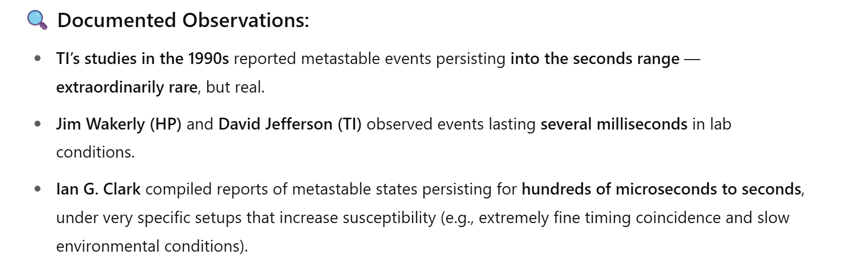

Did you notice the web has many studies with varying time, or the fact that ap note had a clean
clock, which you dont ? ChatGPT shows times :
Would seconds be a problem in this design ?
Lastly KISS = Keep It Stable and Simple should apply.

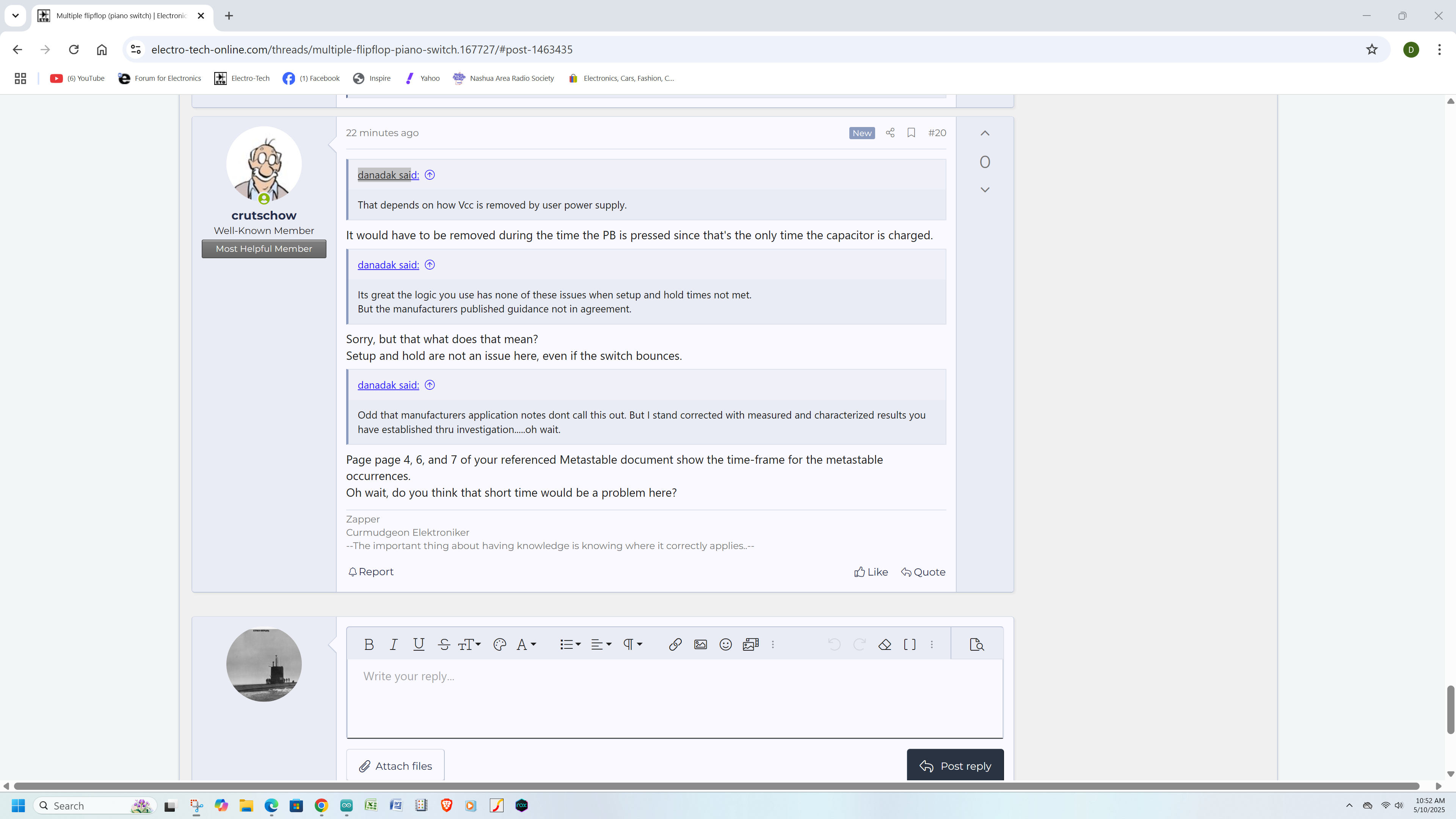

The metastable state in the TI document refers to the data level being in transition at the same instant as the clock, a few nanosecond level timing coincidence. That can leave the data bistable in a mid-transition balanced state, which then takes time to resolve itself.
The data to clock delay in the switch circuit is milliseconds. How on earth is that type of metastable coincidence relevant to this circuit?? You seems to be clutching at straws here :D

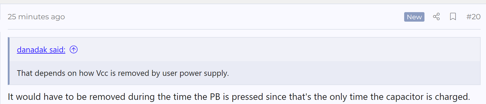

As I stated, the capacitor is only charged during the short time the PB is pressed.
What do you think the chances of that occurring exactly when the power is removed?
It would.
But your reference said that occurrence is "extremely rare", so doesn't sound like a significant issue to me.
Go for it.....ignore the reference that I added seconds have been observed in other investigations.
That circuit timing guaranteed to have mS of delay, huh, so you have timing control of the button
event as related to clock timing, now I understand...... I stand with following vendor recommendations
and industry findings into Metastable behavior. Those are my straws.
