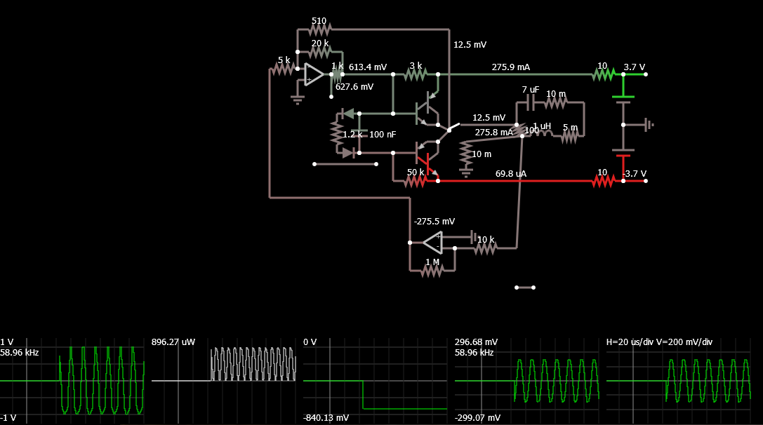

Eureka. I think I have a working micropower clock generator that starts instantly from a parallel tank circuit
Here's is my interactive simulation.
Try this
Negative feedback is for self Bias with small hysteresis reduction.
Positive feedback is to satisfy Barkhausen criteria with Tank circuit.
Try click switch to change frequency 3x ,
Press Reset to see startup operation in slow motion.
Thus with gain >>1e6 in a high speed comparator, the logic level feedback is integrated to a sinewave current due to parallel resonance is much higher than resonant reactance ~< 1 Ohm so the Q should be high and current is limited by 3.7V / 100K iuf using a LipPo battery. Noise abatement is critical, as AM radio will be stronger than the injected signal using shielded or twist pair with large CM choke ( ferrite torroid). Of cource add RF cap across comparator close to chip. Wires cannot be shown like in schematic to DUT with 100 uVpp for example.

Wow Tony Stewart
This works like a million dollars on simulation. I'll try it doing it practically today itself.
Thanks a lot. You're a genius.

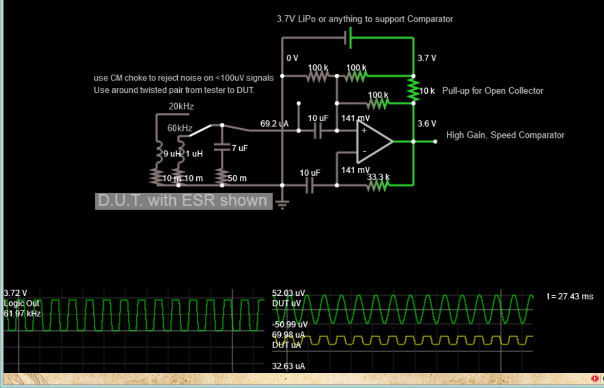

There is still a challenge to choose the right comparator. They have high speed , low latency but also low gain compared to Op AMPs.
I don't know recall these days which is the best high gain comparator or high GBW Op AMP used as a comparator.
if BW is 7x150kHz for reasonable square edges, with a minimum gain of 1e5, the GBW product would be extremely high or 1e6Hz*1e5 = 1e11.
Cascading two comparators is tricky to prevent spurious oscillations.
Background.
I estimate from 100uV to 3.7V square wave, it would be like 100uV sine to <100Vpp sine clipped to 3.7 and similar to a gain of 110~120dB depending on slew rate out, which isn't critical. 100dB gain would be 1e5 or 10Vpp sine clipped to 3.7 might be the worst case large signal gain.
The LM339 only has a gain of 200V/mV typ ( 50min) which is 2e5 compared to Op Amps with a gain of 3e6 but lower slew rate for large signal swing. The LM339 may be marginal for some LC combinations of Q which also gives gain with the 100K feedback R/X(f) ratio.
CORRECTION(edit)
It may be possible to use two CMOS buffered inverters each self biased with 1M Feedback and 10uF coupling which has 10s time constant or so. then use the resistor feedback to input with the Parallel LC load. However it may have spurious resonances from stray reactance and required good Vcc cap. My experience is each buffered CMOS inverters have a analog signal gain of 1000 ( 3stages x10) or 60dB so 2 inverters self biased could be 120dB with high slew rate or transition frequency much greater than you need. THe value of C must be slightly higher than the DUT capacitance, in the comparator mode where self bias (-input) RC= T and (+input) feed impedance RC =T
creates a relaxation effect but resonates when the external load reactance is in phase at resonance.
So good luck.
Note the comparator Vcm must be able to work near Vdd (V-) or 0V and out must swing near rail to rail even if open collector with Pullup R, unlike many BJT Op Amps.

Unfortunately BobW, ( I believe that circuit can't work here, because the negative resistance is too gm*Id is too low.
( I recall) In order for it to oscillate, the net resistance in series must be negative or equal to zero with the current sources ( or regerative gain at 0 deg phase= 1 or more.)
The reactance at resonance here is < 1Ohm.
Good point. I just had a look back through the discussion and hadn't realized the huge C/L ratio. I have the negative resistance test oscillator in my shop and could test it with the proposed L and C values, except that I'm on the road for a few days. I'm thinking that if it doesn't work as is, then a broadband impedance matching transformer could bring the resonant impedance into a suitable range. But that would make the negative resistance circuit somewhat less appealing. Will report back later.
