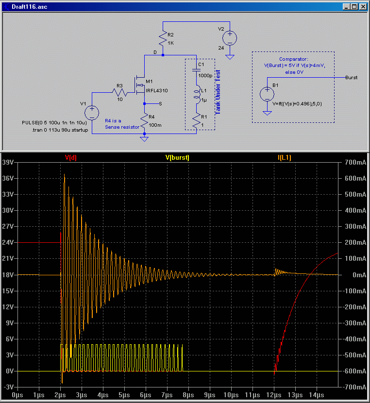

How about pulsing the tank, and measure the ringing frequency? Is the Q of the tank too low to ring?

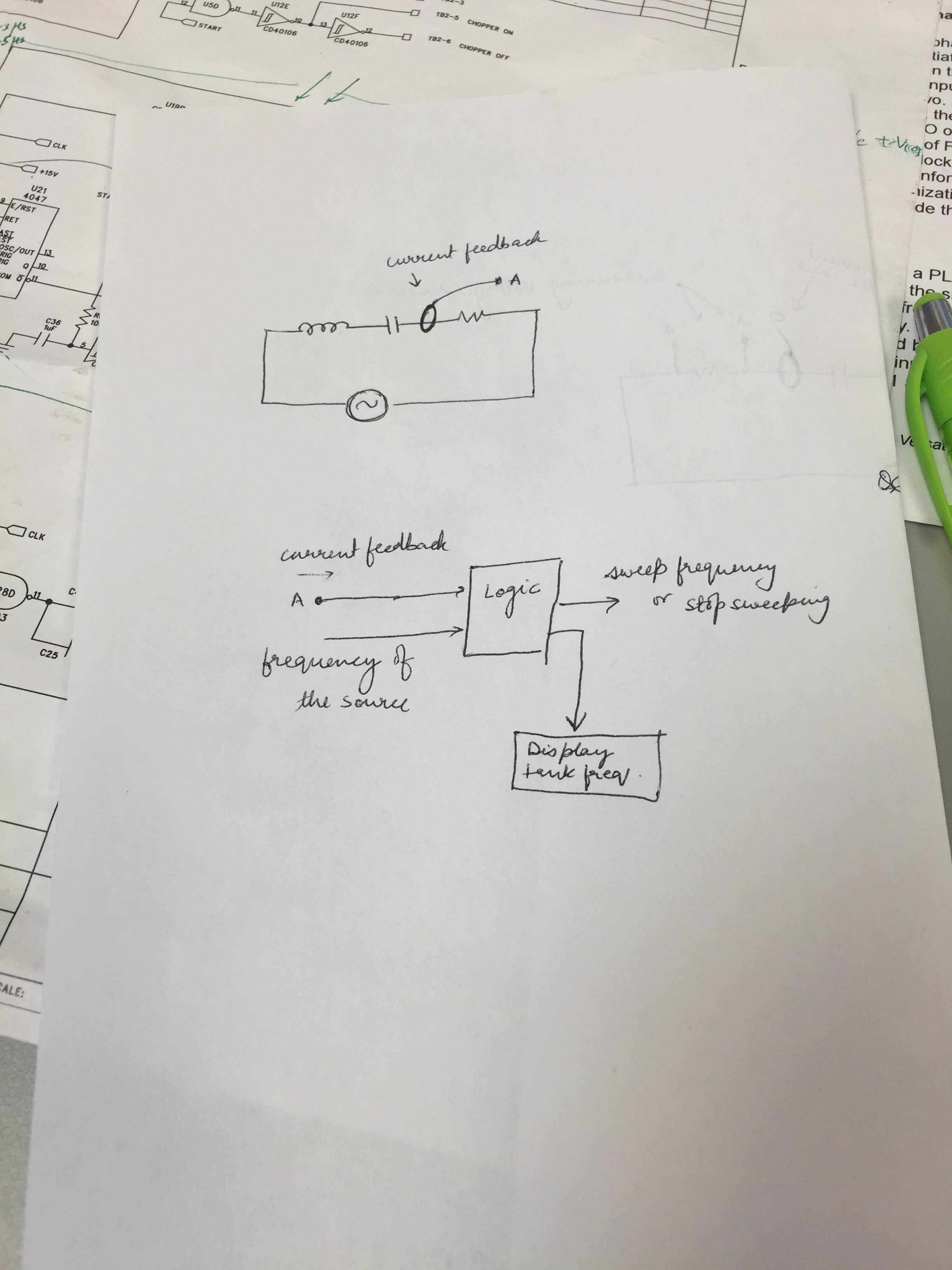

I have come up with a little explanation in the attachment for what I am looking for. I want to make a independent circuit which conducts some tests and gives me the tank's resonant frequency as a number. I hope it is quite clear this time.
The application is for induction heating, where L and C have a very wide range. However, L is typically around 1uH, C is around 6-8 mF and it would be tested in no load condition (no iron job between coil), so I don't know what to comment on R. Now these L and C work for around 50-60 KHz.
But I want to create a test circuit which can tell me the resonant frequency of my tank from the range of 3KHz to 150KHz.

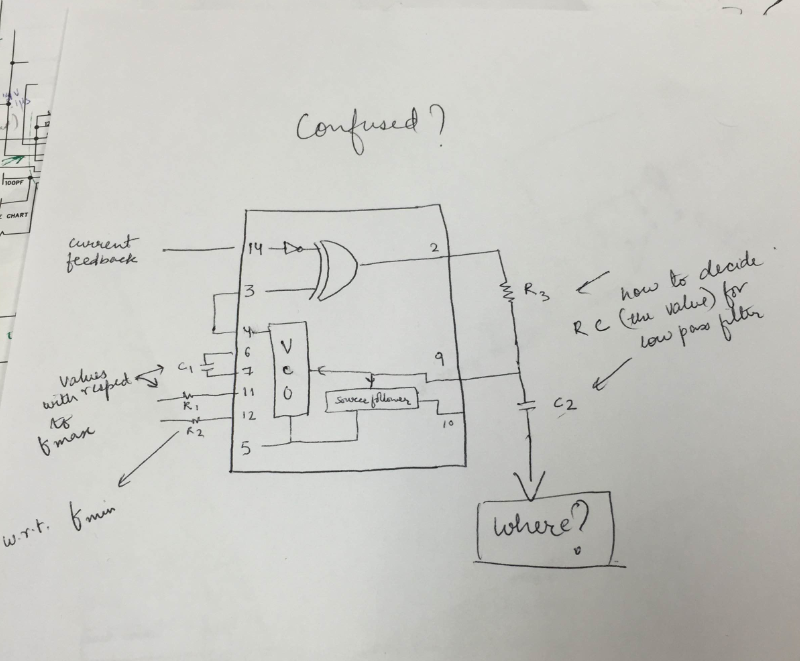

If I use 4046 and feed a current feedback to the pin 14 and compare it to VCO out in XOR comparison. What do I do with the output pin 2. What do I trigger with it. Also, I can't seem to understand how would this help me measure resonance current.
Here is a layout of what I am talking about.
4046 IC:
Vijit.
Feed V(Burst) to a ucontroller, and write code to measure the Period. The resonant freq of the tank is 1/Period.
Thanks for your reply MikeMl
It looks good in simulation but I am not sure if I could do it in real life. Also, I don't have a ucontroller. I however do have access to a lot of ICs, and I am looking to make it using a IC preferably. Do you think I could get something out using CD4046.

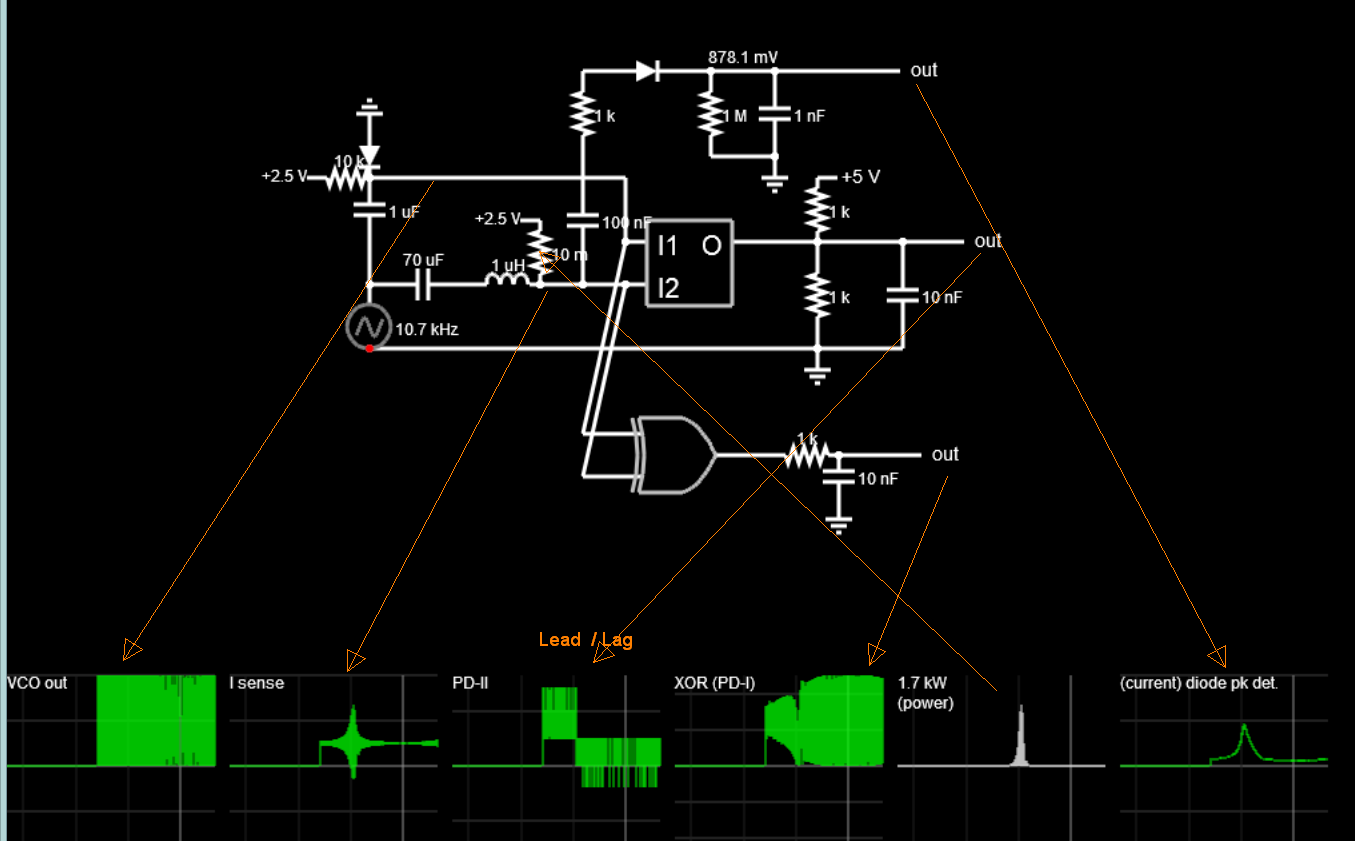

You can automate or manually sweep VCO to drive Type II PD so that voltage out to suitable filter indicates phase lead or phase lag where resonance gives phase for Voltage vs Current.
Use a suitable current Shunt R. and bias to V/2.
BTW I think low f Induction heaters are not as good as high f , which works on Alum pressure cookers etc.
So reconsider your L C and Q values.
Disregard extra VCO AC coupler, clamp diode needed for my mickeymouse simulator to bias inputs., That's supposed to be a CD4046 Type II phase/Frequency mixer,

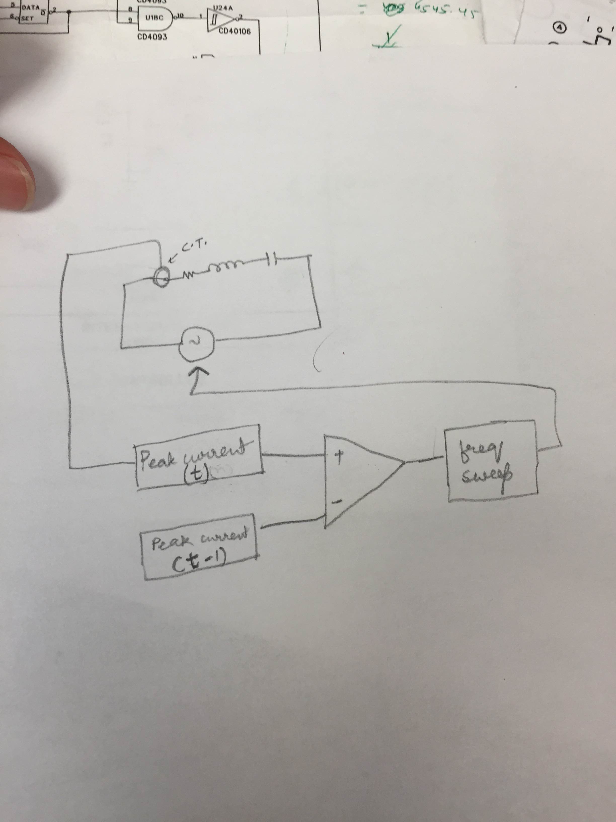

Tony Stewart This is too confusing. The thing is that I am making this project to present with a company, so I cannot negotiate with values.
Is there a way I observe the peak value of current (tweak from high freq to low) and stop the sweep the moment the amlitude starts decreasing. Please consider that I have to implement it directly, simulations won't help.

This is a proof of concept that works. I showed a Series current shunt. It should be less than coil Rs so that Q or power is not affected in a real operation. But for measurement, of resonance it doesn't matter.
All you need is a pot & VCO, counter with Type II out and filter or a sig gen and scope or pulse gen and DSO
Simulations are only to help you understand what is possible.
