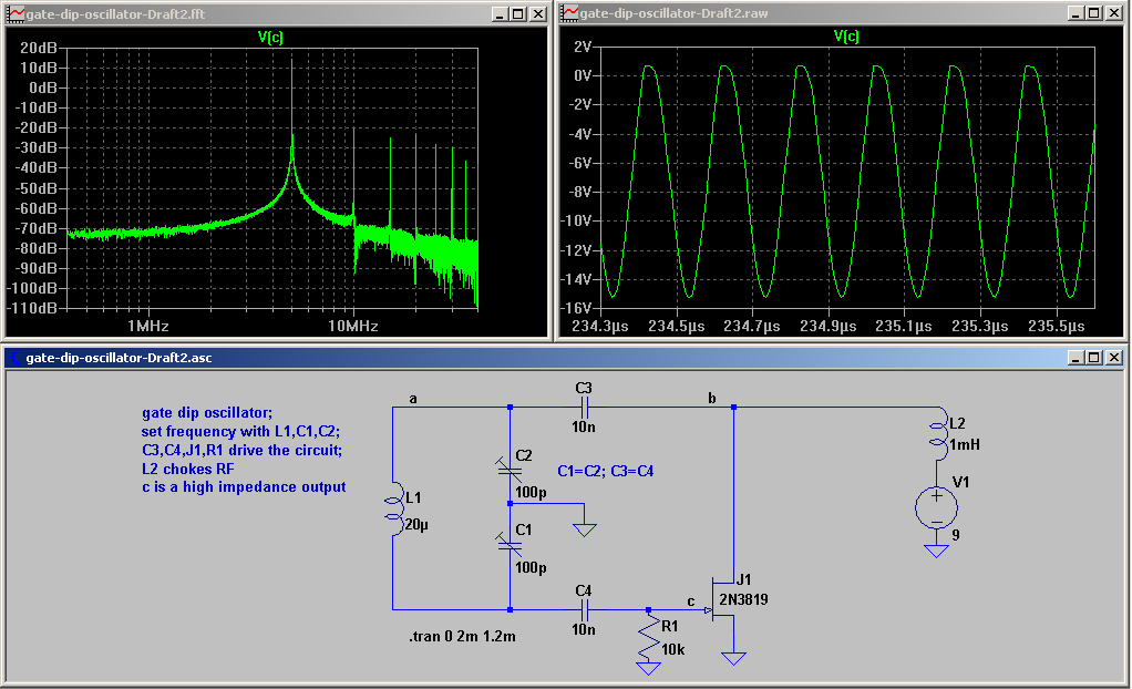

Have you considered a DGDM (Digital Grid Dip Meter; a convenient, non-contact tank/antenna resonant frequency detecting test device)? See: http://en.wikipedia.org/wiki/Grid_dip_oscillator. An example: http://elm-chan.org/works/ddm/report_e.html

You're right, of course. Low Q can result in little or no observable "dip". For sure if using a mechanical meter.
Perhaps some amplification might enhance the detection of the reduction in current at resonance.
A dip meter is actually a very good method.
Let's not conflate low Q with low resonant impedance. A dip meter coupled to a high Q tank will still show a distinct dip at resonance regardless of resonant impedance. On the other hand, if the Q is extremely low, then resonance will have a very broad peak and the measurement instrument will have to be very loosely coupled to the tank so as not to influence the resonant frequency. But in that case, there's really no specific circuit that would be superior. It would have more to do with how the measurement circuit is coupled to the tank.
I was thinking that even if the Q of the DUT was 100 ,it might work if the LC tank reactance was < 1 Ohm but it would peak Q times this for parallel and may absorb enough energy to dip a 100 Ohm dip meter a little bit.
But I've never had the pleasure to use one.
Even the Jfet oscillator version would only get about 500 uV with 9mA Idss
But then you can always amplify that.

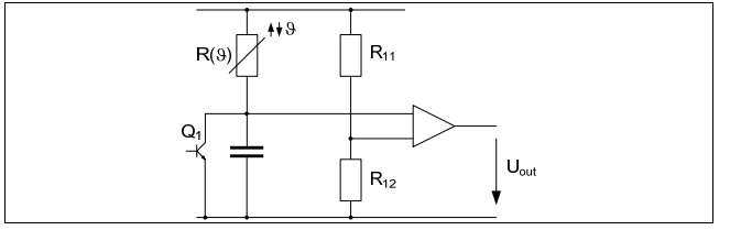

https://www.falstad.com/circuit/circuitjs.html?cct=$+2+1e-8+105.18789638808724+1+5+50 r+512+328+512+376+0+33000 c+720+168+720+224+0+1e-7+1.7647368916329036 w+472+136+472+184+0 w+472+136+720+136+0 w+696+72+720+72+0 w+720+224+672+224+0 w+696+104+696+72+0 w+672+224+672+200+0 w+528+184+528+216+0 g+672+224+672+248+0 w+672+168+720+168+0 w+648+360+648+320+0 R+720+72+720+32+0+0+1+5+0+0+0.5 183+528+184+584+184+0+0.5+1.66+3.33 w+720+136+720+168+0 a+648+368+720+368+3+5+0+1000000 t+640+184+672+184+0+1+-1.7647368911329036+4.999999998019801e-10+100 r+640+184+584+184+0+10000 183+472+184+528+184+0+0.5+1.66+3.33 w+584+184+584+216+0 174+720+72+696+136+0+2200+0.41090000000000004+NTC+2.2+CMOS x+739+111+837+114+0+14+NTC+2k2@25'C r+512+416+512+376+0+10000 g+512+416+512+440+0 w+512+376+648+376+0 R+512+328+512+288+0+0+1+5+0+0+0.5 c+456+376+456+416+0+1e-8+1.1627906976732851 w+720+320+848+320+0 w+512+416+456+416+0 w+456+376+512+376+0 x+867+295+965+298+0+14+NTC+2k2@25'C 174+848+256+824+320+0+2200+0.5891000000000001+NTC+2.2k+OPAMP t+768+368+800+368+0+1+-1.7244751883959766+-8.996682471329543e-7+100 w+848+320+848+352+0 R+848+256+848+216+0+0+1+5+0+0+0.5 w+800+352+848+352+0 g+800+408+800+432+0 w+800+408+800+384+0 w+824+288+824+256+0 w+848+408+800+408+0 w+824+256+848+256+0 w+720+368+720+400+0 c+848+352+848+408+0+1e-7+1.7244742887277293 r+768+368+720+368+0+10000 r+648+320+600+320+0+10000000 r+720+320+648+320+0+3300000 g+600+320+600+344+0 c+600+280+648+280+0+1e-10+-1.1537890152019579 w+648+280+648+320+0 w+600+280+600+320+0 w+576+248+944+464+0 w+928+232+568+472+0 o+14+64+0+290+5+0.0015625+0+-1 o+8+64+0+298+5+0.00009765625+0+-1 o+19+64+0+298+5+0.00009765625+0+-1 o+26+64+0+290+2.5+0.00009765625+1+-1 o+41+64+0+290+10+0.00009765625+1+-1 o+42+64+0+290+5+0.025+1+-1
Edit Op Amp Voltage to +5, -0V
I tried with Op Amp but found simpler solution. It needs 2 stages to be high impedance and negative feedback with inverting Q to get hysteresis but negative feedback
( confusing but it ends up as Ramp Sweep pulse generator)
This looks good in the simulation. Let me try to replicate this on my breadboard.
Thanks.
Thanks.

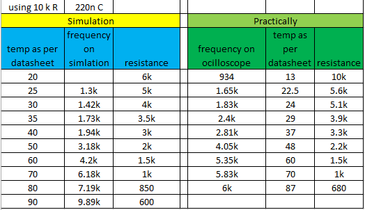

I was wondering if you measured calibration error somehow.
The thing is that looking at the difference between what simulation tells me and what I found was around 20 degrees but the difference between each temperature was almost similar. So, I am assuming it is due to resistances in the rest of the circuit. I right now used actual resistor(1/4 W) to come up with the green column and I am going to use this as a reference for my thermistor.
I also read the thermistor reading using a multimeter and it did fell on the same range of he green column.
Is there any other way that I could do it?
