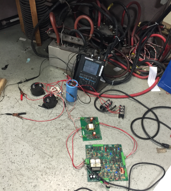

I tested the inverter after testing te rectifier independently. I blew it during testing inverter. Troubleshooting for now.
Tony Stewart Is there any way I could build one for this range.

I checked everything, my caps are fine. But I burnt my IGBT and mic-422cn in my gate drive. Could it be due to the ringing created due to the stray inductance of the wires. It was on no load, the output of the inverter was open circuited and it was supposed to work at starting frequency. With no current feedback it was not supposed to change freq. The gate burnt at t=4 seconds.
I didn't expect the Cap rated @150KVAR 9600 Hz 562 Amp to blow! I expect the IGBT to blow if not current limited.
I think you need to get an RLC meter. The cap probably is oil filled large inductance and not Plastic low ESL.
That cap is not designed for 150kHz induction heating.
It is rated at 9600 Hz only which (my guess ) is probably the series resonant frequency at 562 Amps or it could be used at lower frequencies such as a 1000 HP Induction Motor
That would put the Zo at ~ 1.3 Ohm at 9600 Hz and ESL at 20 uH.
Did you check the resonant frequency of the Cap yet?
What the heck are you trying to accomplish with different coils and that cap?
These capacitor and coils are used in the industry. I'm sorry, something was wrong with my function generator, my resonant frequency is 10K. I tested with a new function generator. As far as I believe, capacitor ratings derate when you go beyond the rated frequency. However, I looked at the charts and I am sure I am in the safe range. I have kept the starting frequency at 33KHz right now.
The idea behind using different caps and coils is to test the range in different frequency. I figured out the problem why the gate driver blew. The deadband was just 400ns. I increased it to 1.2us now. Also I introduced a bleeder across the filter capacitor and a snubber across the DC terminals of the IGBT modules. I would test the inverter in the morning.

After burning 1 IGBT and 1 transformer. I have finally started running on my tank using inverter at 33KHz. The no load voltage output now is 9V AC at 33.1 KHz. The current during clamping it to tank is going around 30A. I am going to get a current feedback using a ferrite coil.
So I guess, inverter issue is fixed now. I have now have to worry about sweeping. I'll start working on the frequency sweep on Monday.
