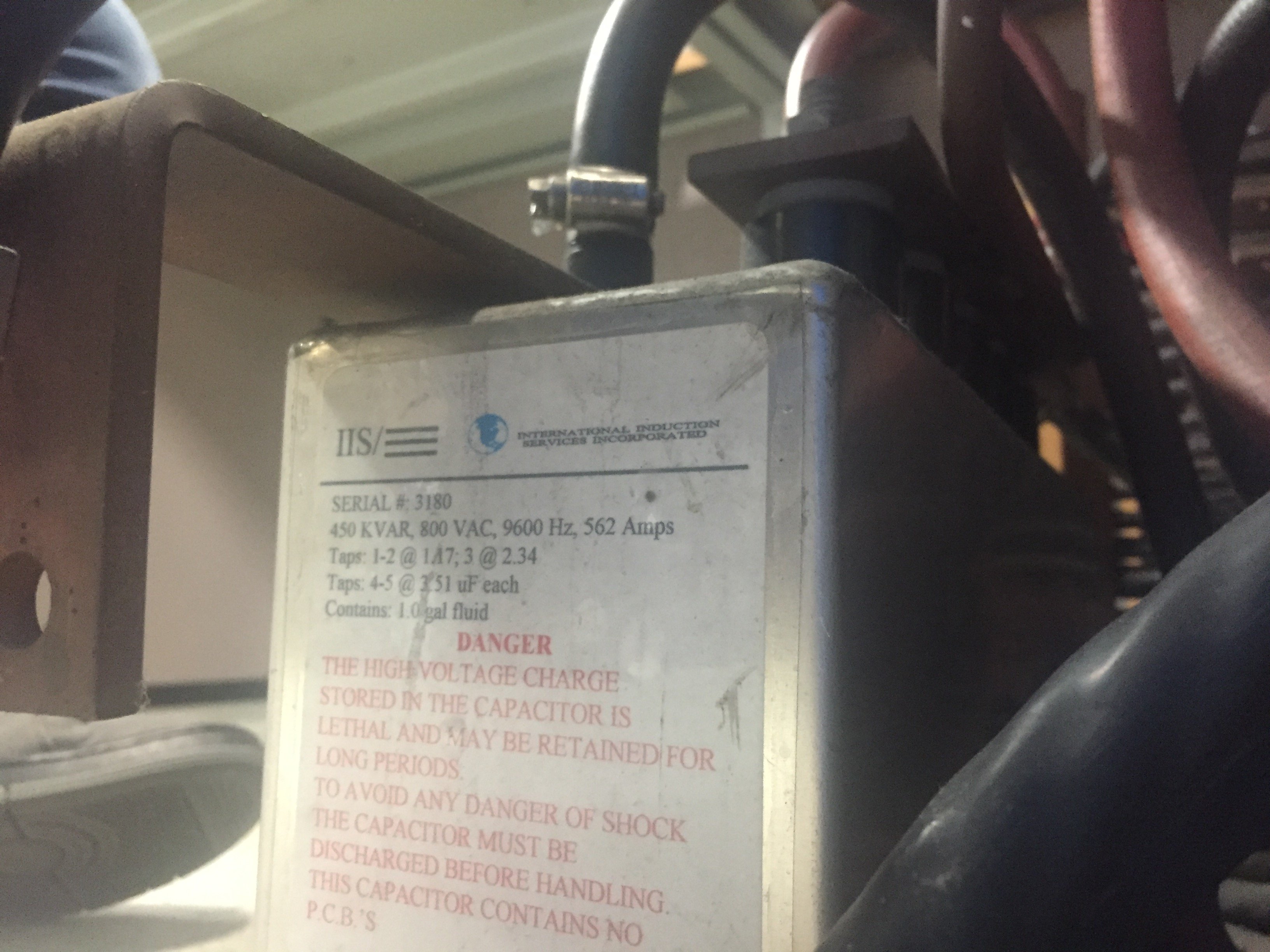

I am using CSM150/200 , total 10 caps of 5 parallel pair of caps (of 2 caps in series).
L is made by themselves by using coils (air core), so no datasheet or value of L as such.

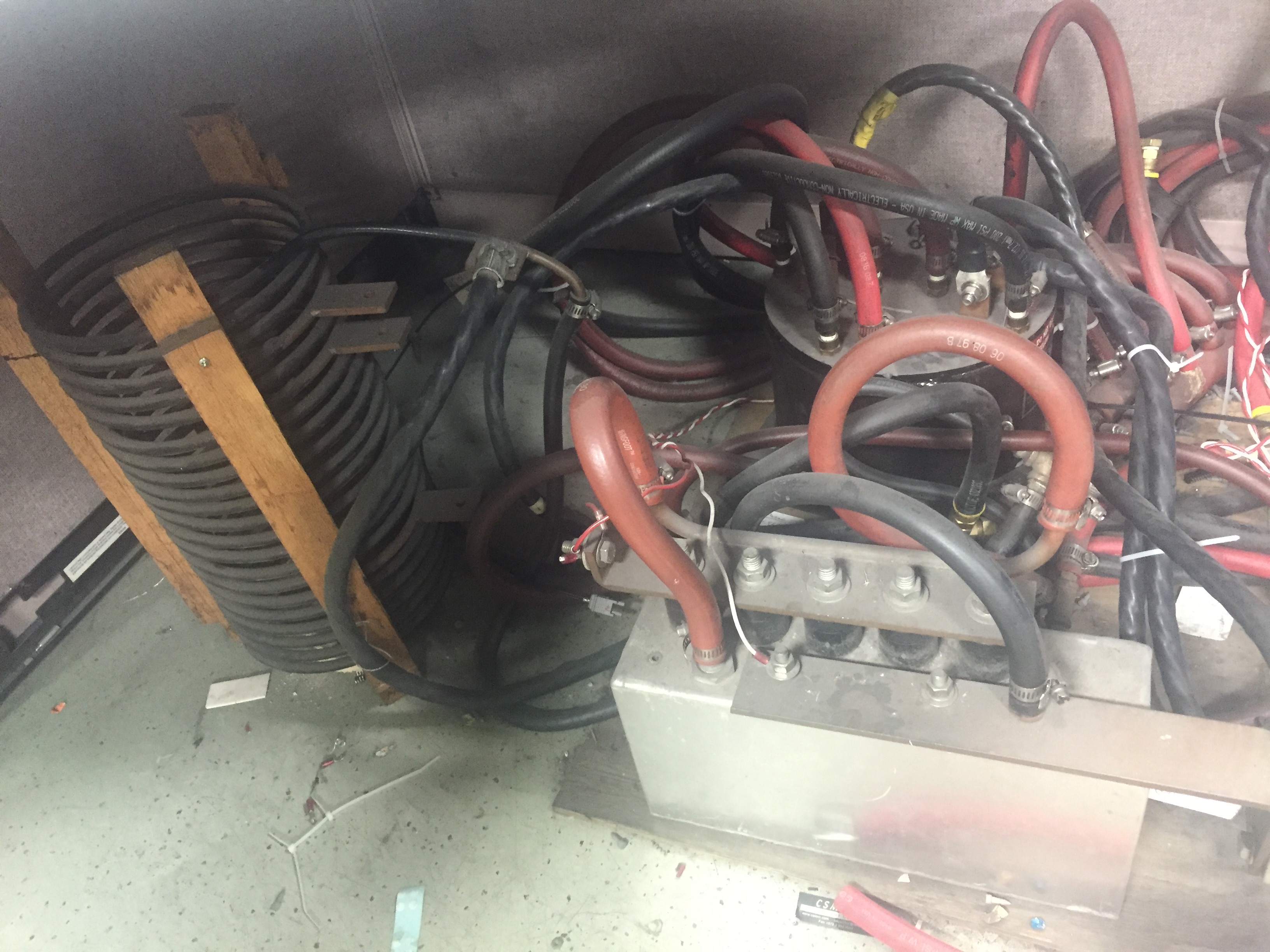

This is what a one of the tank's caps and coil looks like. Their resonant freq calculated using a scope and a function generator is around 18KHz. Now, I tried measuring the resistance using a multi-meter across the tank, it gave me 0.3 ohms.
Assuming equal resistances I'd say 0.6 ohm ESR for both caps and coil, since it is a parallel tank.
The overall cap is 7.02uF. L can be calculated using the formula to be around 11uH.
Does it help?

11uH <>7uF @ 18kHz , Zo=1.25Ohm
If ESR = 0.3 Ohm then Q is only 4.4 and excitation frequency can be within 25%
but conduction loss is 0.3/1.25= 24% so induction heater efficiency is only 76% max.
This rules out pulse ring test. so I see why you want to sweep it.
ALthough from viewing the coils, it's hard to image almost 1cm thick coils and cables are more than a few mOhms... hmm

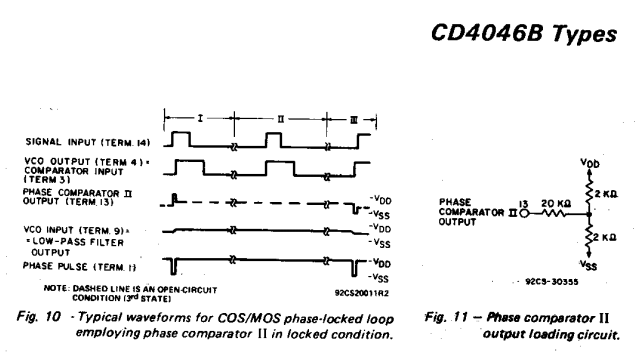

Read how PC2 works. It is a tri-state pump up down phase/freq detector so a small cap C is needed or RC/C lag;/lead filter. to charge up. Adjust impedance to control PLL capture time, jitter, PC2 out sag voltage. between pulses....
You don't need high voltage, but you do need reasonably high current (100mA) to energize the tank circuit at 0.5 Ω more or less. Thus using a complementary MOSFET to drive the Tank circuit for maximum voltage at 0.5 Ohm max and rolls off below this away from center. Thus your driver can apply low voltage even as low as 1V but needs to be much lower impedance than 0.5 e.g. 10mΩ Nch/Pch with logic level Gate voltage may work as long as you don't have shoot thru (Vcc short) during transitions by care selection of MOSFETS using 5V drive level.
PLL Signal input should be your tank signal going into a precision limiter with with maybe <1% positive feedback for hysteresis and high gain but logic level out.
No input signal causes PC2 to go to 0V or minimum frequency after VCO filter. Note the PC2 load circuit for PC2 to modulate as I indicated before. Vcc/2 to Vcc for phase lead and 0 to Vcc/2 for phase lag.
When both rising edges are in sync for Sig and Ref ( from VCO, PC2 is in tristate mode.
Thus you can possibly sweep the VCO and if done right should lock onto resonant frequency where phase shift is 0 deg for a parallel tank circuit. and lead /lag otherwise.

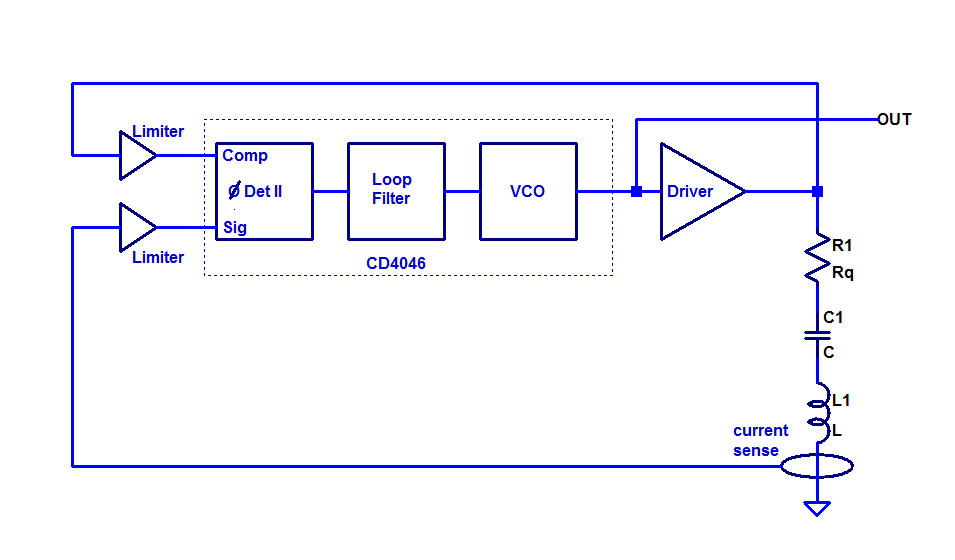

I was thinking along the same lines. I don't if you made it clear that the Comparator input to the phase detector II should be the tank voltage, limited to CMOS levels, and the Signal input to phase comparator II should be the current sense line, amplified and limited to CMOS levels (using a comparator). I don't think any sort of sweep is needed. The loop should settle on the resonant frequency, provided the Q is sufficient, and there is no phase inversion of voltage relative to current in the limiters.
Here's a block diagram.
You still need a frequency counter. You can build or buy one fairly inexpensively.

Thank you Tony Stewart and Roff for a detailed suggestion. I had decided to go with a current feedback too. Now the tank is fed through a 120Vac, which goes through a rectifier and then an inverter (so the power is going is going to be higher now). The output of the CD4046 would fire the IGBTs. I have built the power supply for now. I am working on the gate circuits to fire the IGBT modules.
The attachment shows the schematic. Do you think I am in the right direction.

To lock onto frequency, the Driver & current sense should be as low or lower than R1 above in ROFF's block diagram.
It is (important to) analyze the control system to define the loop stability gain constants for each stage to understand the challenges of non-linear loop gain with frequency, because sense current changes with frequency unless amplified with non-linear phase on harmonics. Thus a Sine source or a tracking BPF works better.
VCO = ΔV/ΔF
Phase shift in the tank circuit is Δθ/Δt which is almost +/-90 deg over the resonance approx, which means loop gain changes widely over the 10:1 or even50:1 frequency range.
The real problem with this method is that when not at resonance with a sine current, below it is a differentiated square wave from L and above it is an attenuated Triangle wave (integrated Square wave from C) and not a swept sinusoidal signal. Thus the Signal to Noise ratio varies widely and phase response is nonlinear affecting loop gain and stability as well as causing harmonic challenges to the phase detector.
After looking at your schematic again, I see you have spent a good deal of complexity to create VCO symmetry using parasitic properties of RC to create the smallest possible edge trigger pulse using D FF's differential delays into a Schmitt trigger to recover a square wave again.
