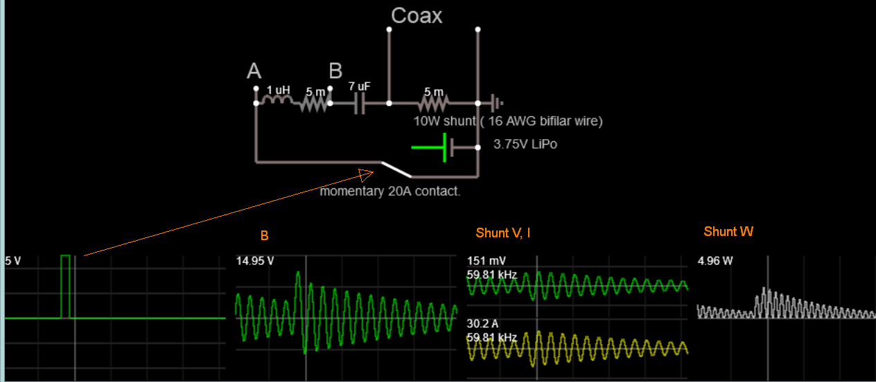

This is a fairly simple problem made hard by communication here.
the values you chose resonate at 2.91 kHz (1uH 7 mF)
maybe you meant microFarad (7uF !!) in which case that makes more sense 60.1kHz
The impedance Zo at resonance is 500mΩ.
Q= Ratio of Zo/Rs ( including coil) = resonance factor and for Q= 1, 10, 100, Rs= 500mΩ, 50mΩ, 5mΩ ( perhaps the coil Resistance) which results in a step response of <1 , 5 and 50 cycles
You will need 50 cycles for < 1% accuracy unless very precise threshold adjustment on counter.
This also means your connections must use braided wire or Litz wire or be very short.
Once way is to use direct COAX connection to an amplified shunt R of 5mΩ directly across coax and terminated by counter and scope.
Since this now means 5 mV/'per Amp, you can now choose your voltage and amplifier gain at 150KHz BW
I might suggest a pulse circuit that shorts out the coil after energizing it, however the counter AC couple may not response quickly enough and DC couple will saturate counter front end with battery voltage.

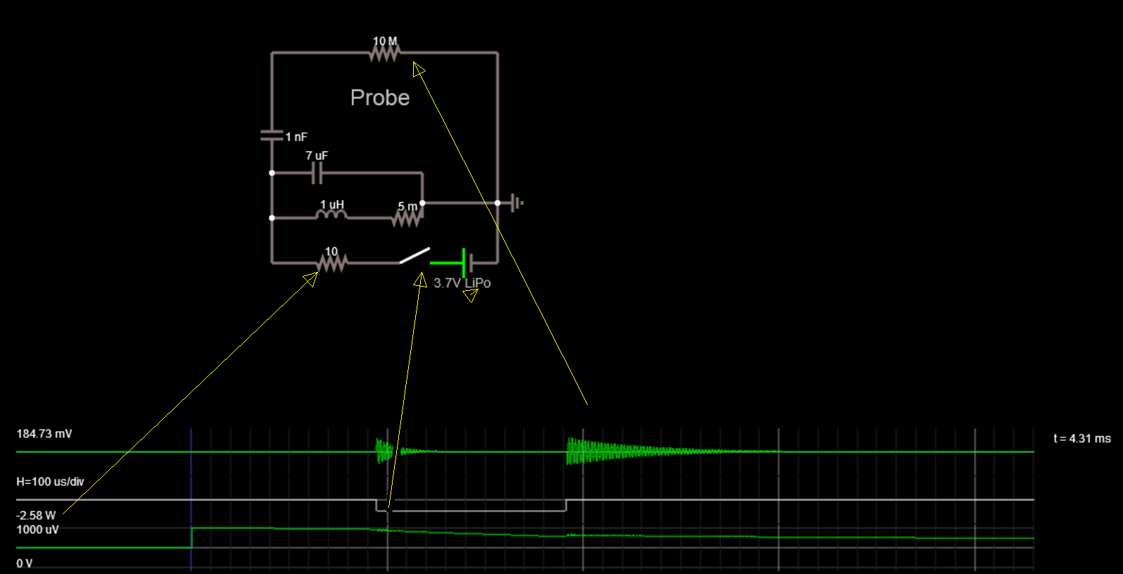

If you can isolate coil and cap in parallel, then try this direct to counter.
5W but only for as long as it takes to momentarily charge up the resonator RC= 70us.
Discharge is AC coupled with series cap and probe / counter impedance 1M or 10M with sensitive input on counter.
Check sensitivity of counter for zero crossing error and max gain or 1:1 or 10:1 probe,
If you can't get this to work. then we can get fancy with VCO , peak detector m scan ramp and peak and hold circuit with Control Voltage pause on resonance,
Counter must be in gated trigger mode for >100us then tryup to 1ms .
and report accuracy using 3.7V LiPo. If you want it safer, add 1A fuse.The 10 Ohm resistor will draw a few Watts but only for <1ms for each contact bounce. So use a good switch ( momentary ) that is low in contact bounce. If cap is not connected it may arc on switch, so TVS diode may be used for additional safety ( user fault)
This is low voltage, low energy... few mJ (3W x 1ms)
This does not trigger IGBT.
Test time after connected 1 second. Push and read.

I only described the setting for a good low cost frequency counter with a sensitive input. ( in my last couple comments)
By careful selection of passive values and counter trigger thresholds, the test takes 1 second and reads frequency of the burst directly, instantly.
Make sense yet? WHich part did you not understand? The probe? I was suggesting using a scope probe for the counter. But as R in raises Q and duration of ringing, it also attenuates input so amplification may be needed. The counter usually has a good limiter inside.
