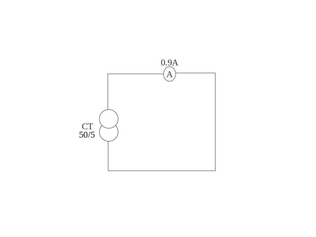

Hello everyone,
*******************This is my first thread.:)

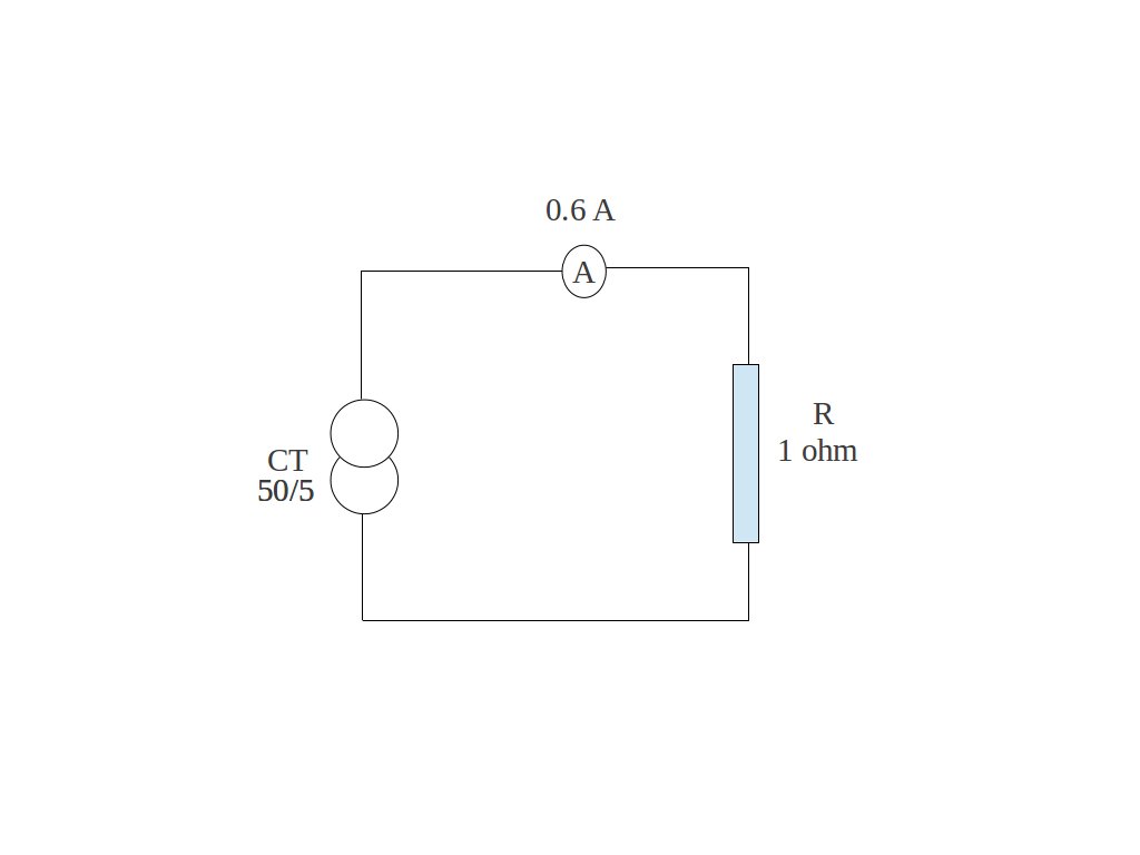

* I have designed a signal conditioning unit(scu) where the input to scu is from current transformer(ct). The problem is that the current from ct when measured with an ammeter shows 0.9amps which was connected as the figure i have attached at first.
***************** But when i connected the ct input to my scu,the current read by ammeter was 0.6amps.(figure 2).
*************** I thought ct is a constant source to a variable load.Is that right?
I wonder where that 0.3amps has gone.can anyone help me out in this

Have you allowed for the ammeter impedance in your setup?
The secondary current (low) of the CT is proportional to the primary current (high). You would normally connect a burden resistor (google that if necessary) across the secondary to develop a voltage which then would be the input to the SCU.

and the load i hav connected to ct is a 1ohm resistor..and i got a feel that this 1 ohm resistor makes immatching impedence between primary and secondary?,(max power transfer theorem)..

The load connected to the ct is 1ohm resistor,is that a burden issue?..the problem is that i needed an amplification from ct and hence i increased the primary turns...is that a issue that made this problem??

I hav purchased it,its a split core ct of ratio 50/5. I did a late night work on it with your ideas. For 1amp primary current(with single turn) i received 50 milli amp current on secondary of ct(connected to load).But theoretically i shud hav got (1000*(5/50)) =100 milli amps. Blindly i increased a turn on primary side of ct(totally 2 turns) where i got 100 milli amps on secondary(didnt know how that happened)...
So as alec_t theory was right(burden),then the secondary o/p shoud hav been half of that 50 i.e, 25..But the o/p is relatively maintaining the ratio of 50/5 for 50/10(when increased to two turns)..
Can i hope this to work for the same for even all values of current...So finally ,is there any thumb rule to calculate the secondary current of ct with a load (burden) on sec???:confused:
The secondary current is theoretically the primary current divided by the turns ratio, for various burden resistor values. The resistor value should be such that the VA rating of the transformer is not exceeded.
If the CT is indeed a 50:5 type then 1A through a single-turn primary should give you 100mA secondary current, as you say. I can't explain why you only get 50mA, unless the CT has been wrongly marked and is in fact e.g. a 50:2.5 type.
Edit: What is the VA rating of your CT and what value burden resistor are you using?
