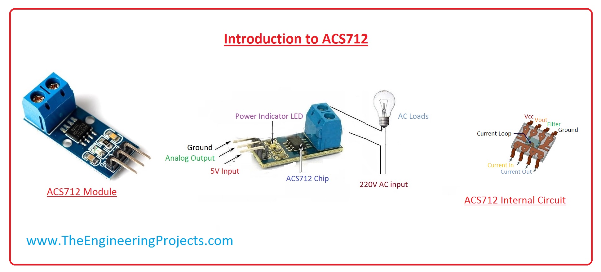

Maybe you have returned this product by this time. I find the ACS712 module more convenient.
ACS712 is an AC or DC current sensor, which is used to measure AC or DC current. The maximum value of AC and DC which can be measured is 30A, its output current signal can be read via analog I/O port of Arduino. It is also available in 5A and 20A version which provides precise and economical solutions for AC or DC current sensing in industrial and commercial systems. ACS712 consists of a precise and low offset linear Hall sensor circuit with a copper conduction path located near the surface of the die. ACS712 is used in different industrial projects and commercial electrical devices which includes motor control switched mode power supplies, load detection, and management and overcurrent fault protection.
