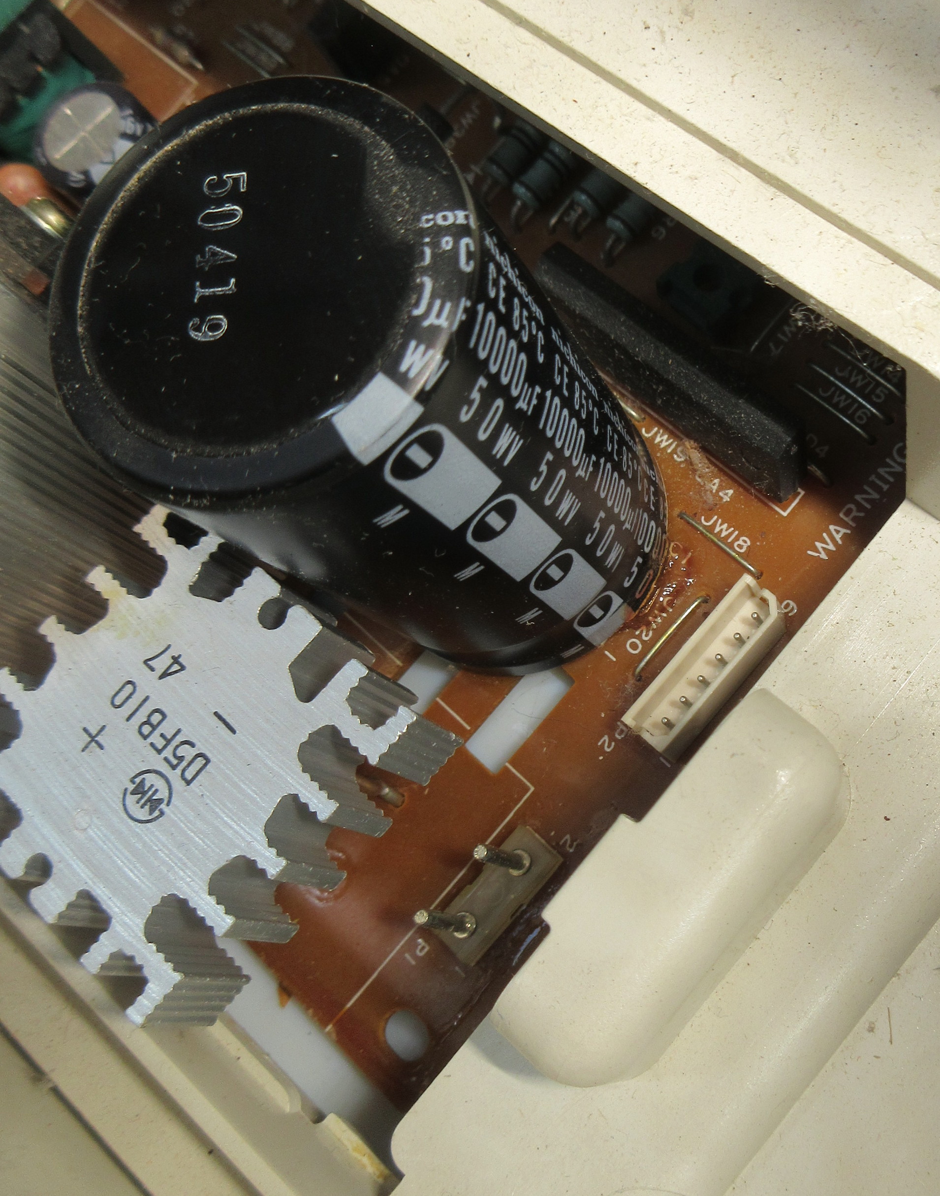

This is a Brother EM711 typewriter. It would randomly reboot as if you had turned the power off then on. Now it's totally dead. Took it apart and checked the transformer.
there is 120V on the black and white wires going up to the transformer, but only like 30 mV coming out on the two red wires on the left. Bad transformer? And where do I find a replacement? Found nothing by searching those numbers and have no idea what the output should be.
Agree. There is something "open" on the primary side, which is uncommon. I would carefully unwrap some of the cover layers (paper?) to look for the possibility of a thermal fuse or some other element that acted as a fuse on the primary, buried under the wrapping.

Got the $50 power supply off Ebay delivered today. Hooked it up starting with 5 volts, then 10, 12, 15.... and around 20v it started to work but not very well. Wasn't until I hit 24 volts that it seems fully functional. Will put all the rollers back in for another test to confirm everything works and it takes a 24v transformer before searching for one.
Works great with 24VDC. Someone in another forum said I should use a 18V transformer because it's AC. Really?
Yes, 18VAC will produce about 25VDC at peak. Under load, the voltage will normally drop to the 22 to 24VDC while operating under a light load. Under heavy load, it might drop to 20V. A 24VAC transformer will give almost 34VDC peak. The question to that is, would 34V damage anything? Under heavy load, that 34V will drop to 26 to 30VDC, depending on transformer VA rating.
Recheck the component voltage ratings around the rectifier diodes, if they are ALL rated 50VDC or better, then a 24VAC may work ok. Test your printer at 30VDC first, see if it works ok. Measure the maximum current drawn. 30V x current will give approximate VA rating required for transformer
There's a big black reservoir capacitor on the left of the first picture - what voltage rating does it have? - the required DC voltage is probably going to be between 24V DC (which just works) and the voltage rating of the capacitor, probably 35V?.
18 volt transformers in this footprint are around $50 with shipping. Any reason I couldn't use this 20V model I could get for $15? Don't think I have this typewriter on for more than 15 minutes at a time.
