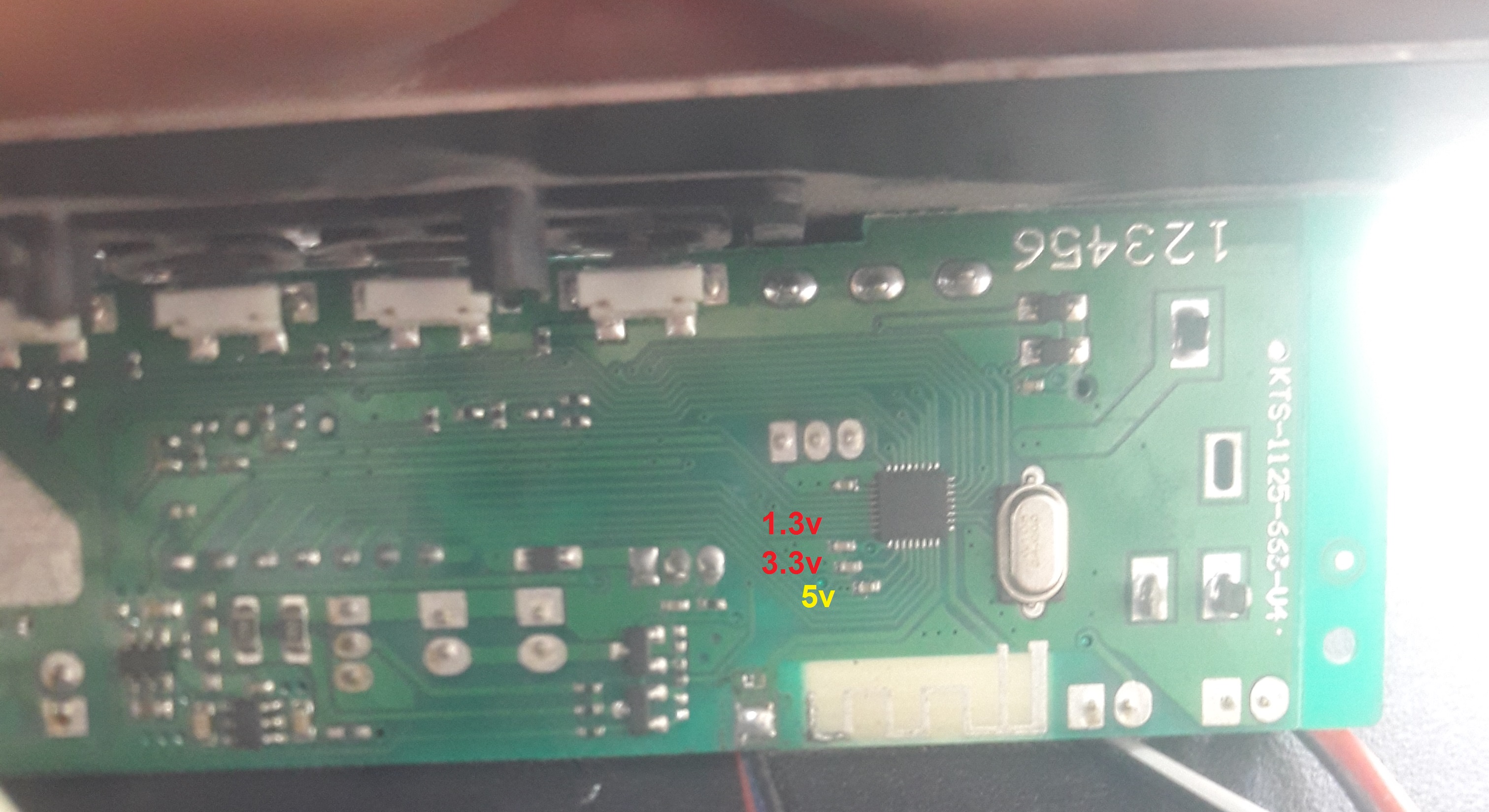

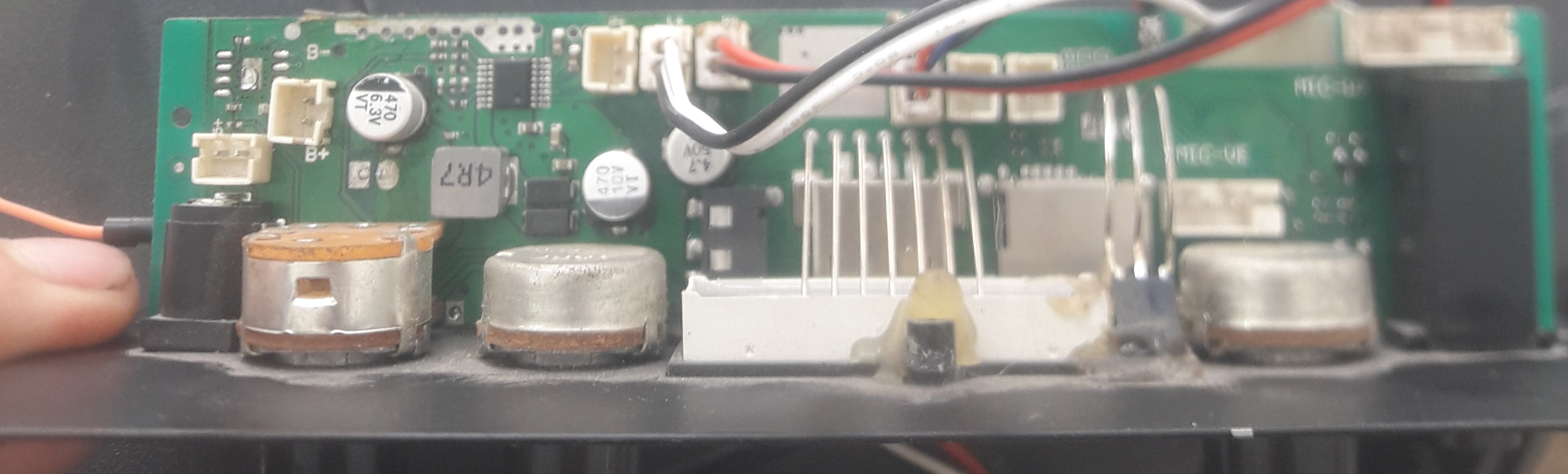

A KTS 1075 bluetooth speaker has come for repair. Now after the repair, the problem is that it resets at high volume and the sound of bluetooth and loading comes from the beginning. What is the problem?
I checked the device with the power supply, there is no problem with the battery
Did you do the repair work? I believe the problem exists in the PCB. Maybe you or whoever did the repairing, short- circuited something unintentionally or disconnected a component.

Yes, the problem started from here. The device did not charge two 18650 batteries. I noticed that the output terminal of the battery socket has low voltage. I removed the charge IC control charge chip becuse 1.6v output chip and the battery also had a problem. It did not work well anymore. I replaced it with a tp4056 charging module and started the device. I started the device, but it restarts loudly
I think you need to open it again. Look for a short circuit or newly damaged components.

I tried the speaker device with an Aux cable, there was no problem with the loud volume, and I only have a problem with the Bluetooth mode. There are 3 smd capacitors next to the power supply with voltages of 5v - 3.3v, 1.2v, only 5 volts, the voltage drop is decreasing.
