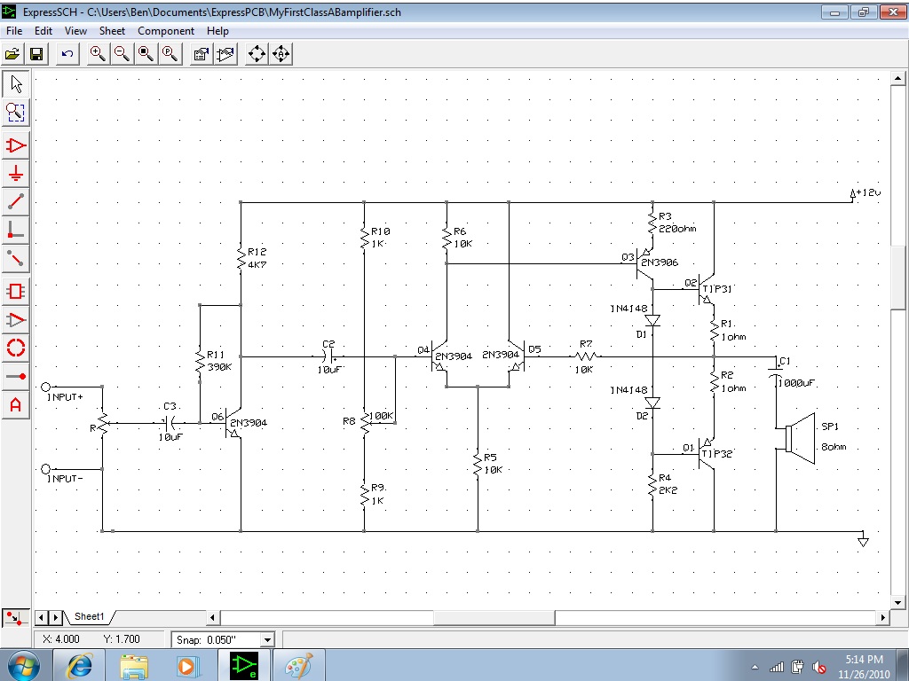

My first class AB amplifier
ben7
Well after extensive research on class AB amps I have finally built my first one! :0 I just had a spare pair of TIP31/TIP32 transistors that I have used in the circuit. Power supply was 12v @1A, and this amp can drive a 10watt speaker easily! Two medium-sized heat sinks were used, and after a long time at full volume they got just a tad warm. I am looking for feedback on any adjustments to make it better. :)
If your amplifier had no voltage losses (it has many) then its output voltage will be 12V peak-to-peak which is 4.24V RMS. Then its output power into 8 ohms is 4.24V squared divided by 8 ohms= 2.25W RMS. But its voltage losses reduce the output power to only 0.5W RMS if the output transistors have gain higher than typical.
The output transistors need a typical base current of 5mA when the peak signal in the 8 ohm speaker is 4V (500mA). But the value of R4 is too high at 2200 ohns so it will have a voltage loss of 11V. Use 200 ohms for a voltage loss of only 1V and if the gain of the output transistors is typical or better.
Another way to reduce voltage losses is to add a bootstrap capacitor to the junction of two resistor R4 in series. Research it.
The two diodes probably do not match the Vbe of the output transistors and will cause crossover distortion or very high idle current and high heating. The two diodes should be replaced by an adjustable Vbe-multiplier transistor. Research it.
There's also no gain in the power amp - I would suggest looking at a real circuit and comparing it, this looks like an attempt without understanding why the missing parts make it so poor.

Also, you didn't notice that it should have a 100pF capacitor between the base and collector on the PNP transistor Q3. ;)
Ok I see, I will try it with R4 as 220ohms.
Then remove R3 because it reduces the open-loop gain too much.
The open-loop voltage gain of your circuit is so low that it probably will not oscillate without the capacitor. If R3 is removed, R4 is bootstrapped and the differential amplifier has much more gain then the 100pF (or 47pF) capacitor will prevent oscillation when negative feedback is added.

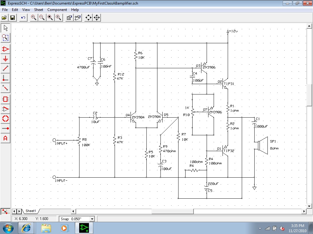

I removed R3, and I boot-strapped R4 with 2 100ohm resistors and a 220uF capacitor. Also used a vbe-multiplier as well.
It sounds good!
I think it is oscillating now because when I remove R7, the volume of the music decreases dramatically.
Do you think I should add another pre-amp stage also?
And what about using a dual rail supply?

It's getting closer to been an amplifer now.
1) Add a resistor and capacitor in series from the LH end of R7 down to chassis try a 470 ohm and a 100uF or so for a start, this will give the amplifier some AC gain (set by R7 and the new resistor).
2) Dump the silly preset at the front, and just use two 47K resistors as a potential divider.
3) Use a preset resistor in the Vbe multiplier so you can adjust the bias.
4) Dump the preamp entirely, the power amp should give enough gain to accept line levels - but without the correction in 1) it has no gain at all.

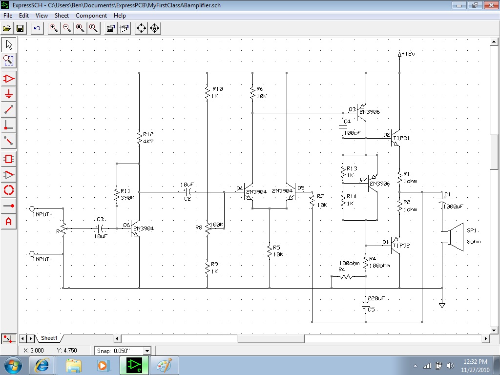

So what would I have to do to make it have more output watts? Change R7 and/or R9?
I got rid of the "pre-amp" and made the bias adjustable. I added R9 and C3 and that increased the AC gain.

So what would I have to do to make it have more output watts? Change R7 and R9?
No.
R7 and R9 adjust the voltage gain (sensitivity) that has nothing to do with the max output power.
What makes power? The voltage times the current. The power is increased if the supply voltage is increased because then the voltage and the current are both increased.
Ordinary "low power" car amplifiers use a 4 ohm speaker so the current is pretty high then use two amplifiers in a bridge for each speaker so the voltage is pretty high across each speaker, then the current is also pretty high. My car has 2 ohm speakers and bridged amplifiers.

If I changed the power source to 24volts, will that make it louder?

Yes, 24V will give you about 8W - same as two bridged amplifiers on 12V will.

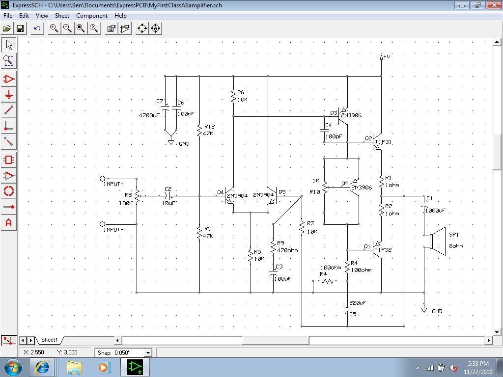

Changed circuit:
I just used it with a dual polarity power supply, I took note that the amplifier is quite sensitive to noisy voltage rails. ;)
It got two times louder, R4 and R4 (yes, my mistake on the circuit diagram) were burning hot, along with Q7 and Q3. :O
I removed the output capacitor and turned it on...no smoke, and music came from the speakers. :)

I just used it with a dual polarity power supply..... It got two times louder, The two R4s were burning hot, along with Q7 and Q3.
Your hearing's sensitivity is logarithmic so you need 10 times the power to be twice as loud. You didn't get 10 times the power.
Twice the supply voltage doubles the voltage and doubles the current in most parts so of course the resistors get 4 times hotter.
Each R4 dissipates 0.34W when the supply is plus and minus 12V. Q3 dissipates 0.68W which is more than its max allowed heating.
Q7 should not get hot because it has a low voltage across it.

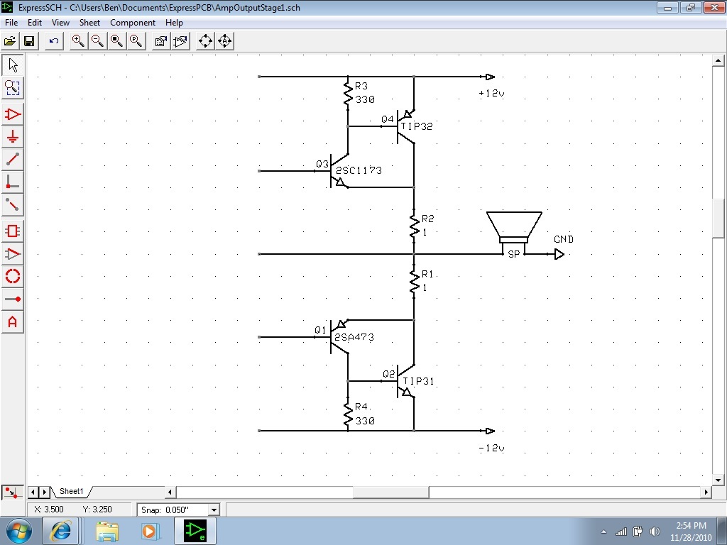

My new Q3 is a 2SA473, it was one of the few PNP power transistors I had around.
I have seen this output arrangement before, I think it will increase the voltage gain, but I am not sure.
Take a look:
