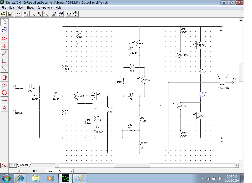

My first class AB amplifier

I want to make it have an RMS output of 20watts into 8ohms.
So, If we want to have a 20watt RMS output, the output will have to be 40watts peak.
40W x 8ohms = 320
√320 = 17.88854381999832, or about 18V required at the load
18VDC/8Ω = 2.25A peak
The + and - supply rails would need to be able to each handle half that value of Amps, or 1.125A minimum
So how would I figure out what is the + and - supply voltage needed?
According to https://www.electro-tech-online.com/threads/audio-amplifier-diagrams.113553/#post929153
Here is my updated circuit with a Sziklai pair output stage.
From the useful link that Nigel gave me it seems that a Sziklai pair is good for Hi-Fi amplifiers.
Should R11 and R12 be 220Ω like shown in the diagram?

I want to make it have an RMS output of 20watts into 8ohms.]
The output waveform must be almost 18V peak but the drivers for the output transistors, the output transistors and their emitter resistors have losses so maybe the power supply should be plus and minus 22V.
Now that you have compound output transistors with high current gain, you can reduce the current in the driver transistor Q3 by increasing the value of R8 and R9 to 1k ohms or 3.3k ohms. Then the driver transistor can be a little one and can have a high open-loop voltage gain. Also, the value of C5 can be reduced.

Do you think I could use a + - 24 volt supply instead?
A higher voltage creates an amplifier with more output power and more heat.
The transistors must be able to survive the high voltage and be cooled well so they do not overheat. They must be able to provide the higher current.
The power supply must be able to supply the power.
The total supply is 48V but the output transistors have losses so the output signal is probably 42V p-p which is 14.85V RMS. The power into an 8 ohm speaker is about 27W at clipping. The power into a 4 ohm speaker (it current is nearly doubled) is about 45W at clipping.
