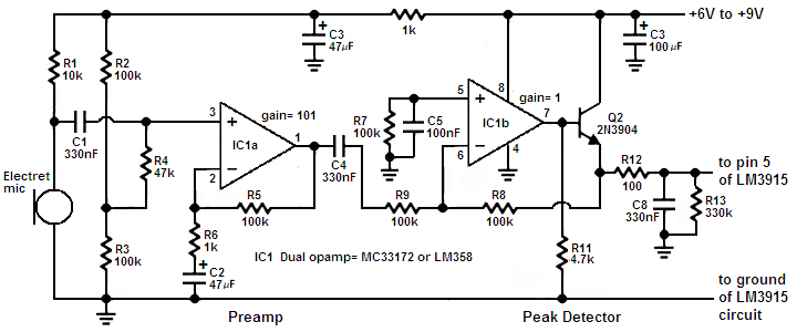

If the output of an MP3 is 300mVppk you need a preamp.
I would consider using a dual OPA, something like a CA3240.
Use the 1st half as a preamplifier and the 2nd half as a full wave rectifier, in that we we can remove the crude pnp rectifier.
hi agu,
The post #57 showing the peak detector has a gain of 1, no pre-amp shown, unless I am missing something.
I mentioned in the text "Reduce the value of R9 a little or increase the value of R8 for more gain".
The opamp inverts so a negative input is cancelled by a positive output, which prevents the input pin from going more negative than ground.
So you don't want the gain to be so high that the circuit clips its output as high as possible that will cause the input pin of the opamp to go below ground which is bad for it.
My circuit used another opamp as a mic preamp and when it is over-driven then the low gain of the peak detector opamp prevents its input pin from going below ground.

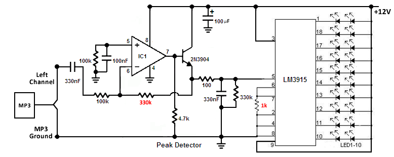

I agree that the mp3 player output will be low, and I've seen similar 300mV references elsewhere. So, I guess that preamp will be necessary. I thought that the 5K pot was for that problem, but I guess the output voltage is way too low for that to help.
So I'll still need a few parts from the store, couple of opamps and some other parts as well. But I have absolutely no idea how to get everything I need without parts list from a ready circuit. Audioguru, those circuits that you posted mention electret mic, +6 to +9V, I will have to use 12V for this one, so I guess the resistors and such won't do as in the pics.
The AG circuits look good, I think I can build them, but how should they be modified for my purposes?
If you use my single opamp circuit then you must use a single-supply opamp like the MC33171 that I used or an MC34071. Half of an LM358 can be used but it is poor at high frequencies.
Set the LM3915 like it was before with an input of +1.25V to light the 10th LED. Then the gain of the opamp needs to be only 1.25V/.4V= 3.125.
Increase R8 to 300k or 330k.
If you use a 12V supply then the LM3915 might get very hot. You can add a power resistor in series with the voltage to the LEDs to share the heat.
The 5k pot isn't needed with my opamp circuit. It was used to turn off the first LED when there was no signal in the Mickey Mouse transistor circuit.
So the circuit in this picture would be one correct way to do it? And this gain of 3.125 should work with low output voltage sources like mp3 players?
I plan to use 2 LEDS in series per output to reduce the load on the chip.

But no matter what, I'd say that a pre-amp with an ajustable gain between 3 and 6 would most probably do the job, right ?
You don't need adjustable gain when your are fed from the headphones outputs of an ipod that has its own volume control.
But you might want to turn down the sound level and turn up the gain of the display so it is near max rthen an adjustable gain control is needed.
The 330k resistor could be a 1M pot connected as a variable resistor. Keep its wires short.
What I had in mind with an ajustable gain is to be able to accomodate the circuit to various MP3 players with different output powers (hence different output voltage profiles).
I was also wondering if the OP wants to listen to his MP3 player at the same time he uses his circuit. If so, he might want to adjust the MP3 volume to his liking and then boost the gain of his circuit so it is still full scale.

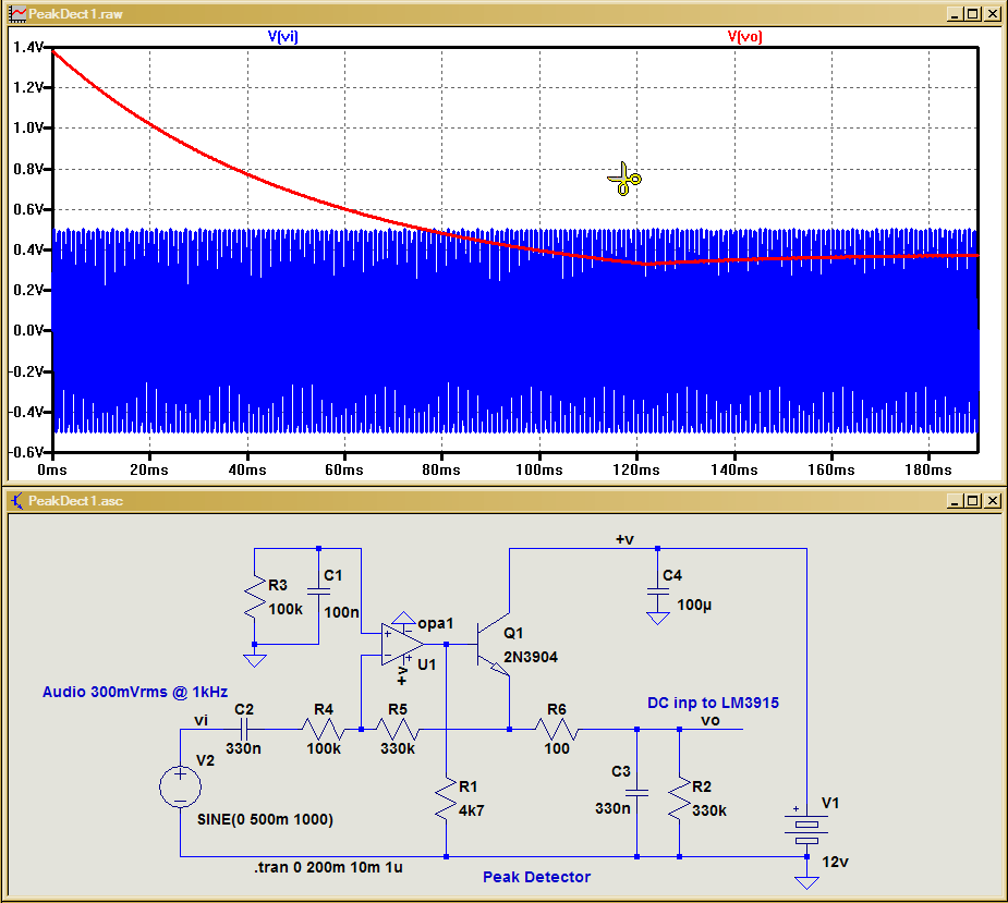

Morning Gaichuke,
I ran a LTspice simulation on that last circuit you posted, its got a 'strange' output response.
I will run 'agu's as a comparison later today.
