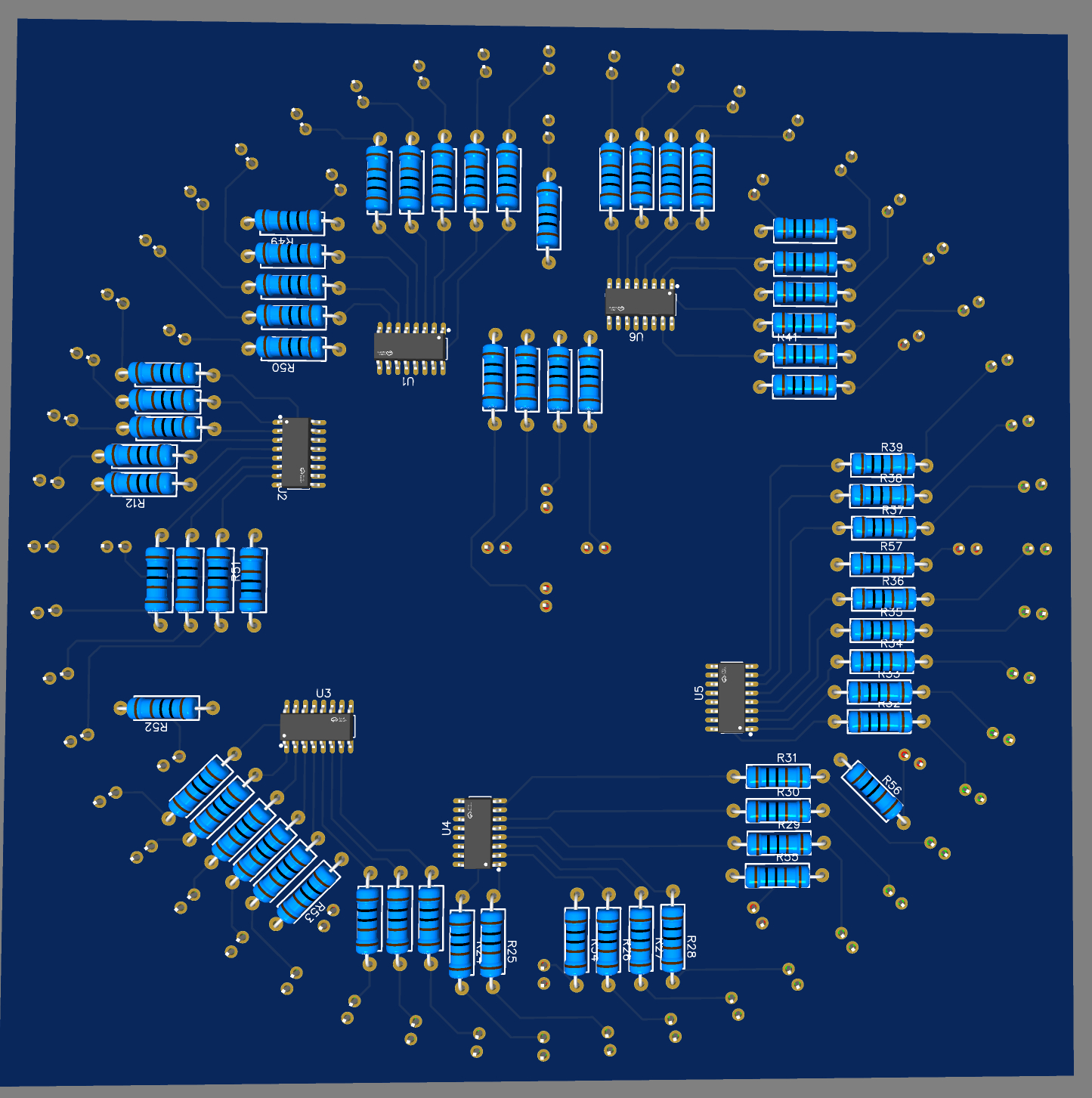

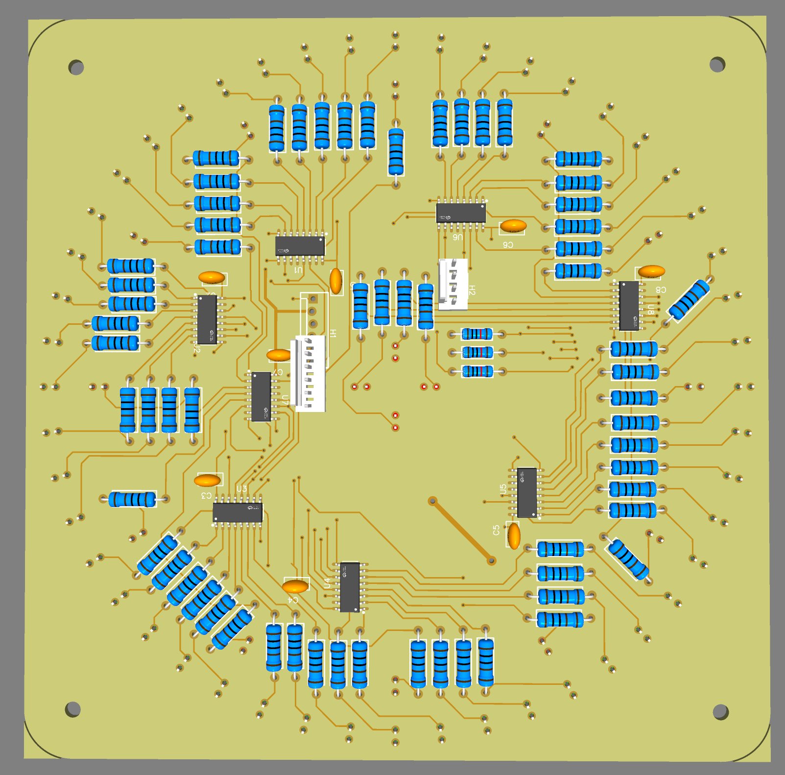

Simple LED Analog Clock Idea

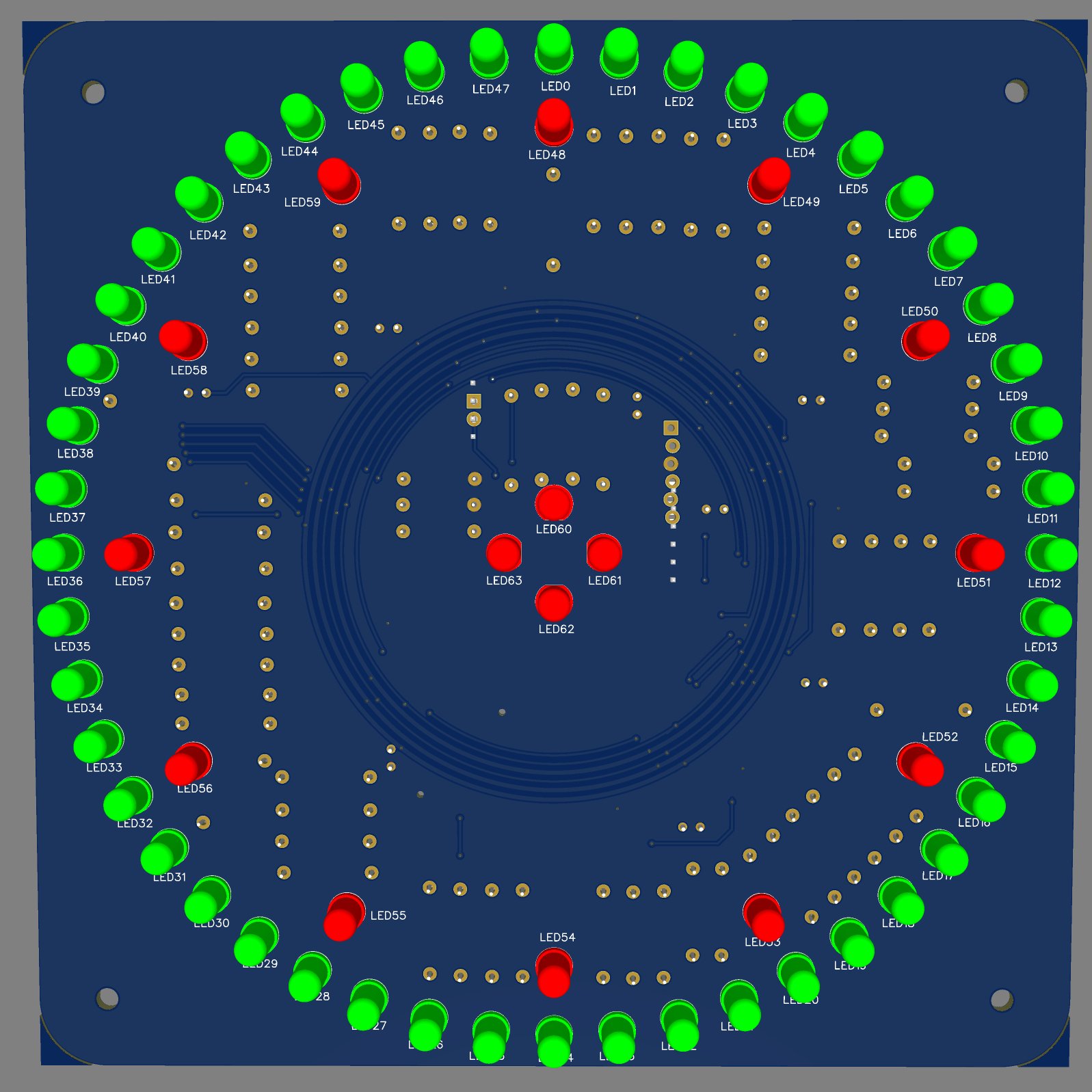

Nice looking clock, why through hole resistors?
It's vastly faster to hand assemble using through hole than SM, so it makes perfect sense - if you're having it assembled by the PCB manufacturer, then use SM instead.

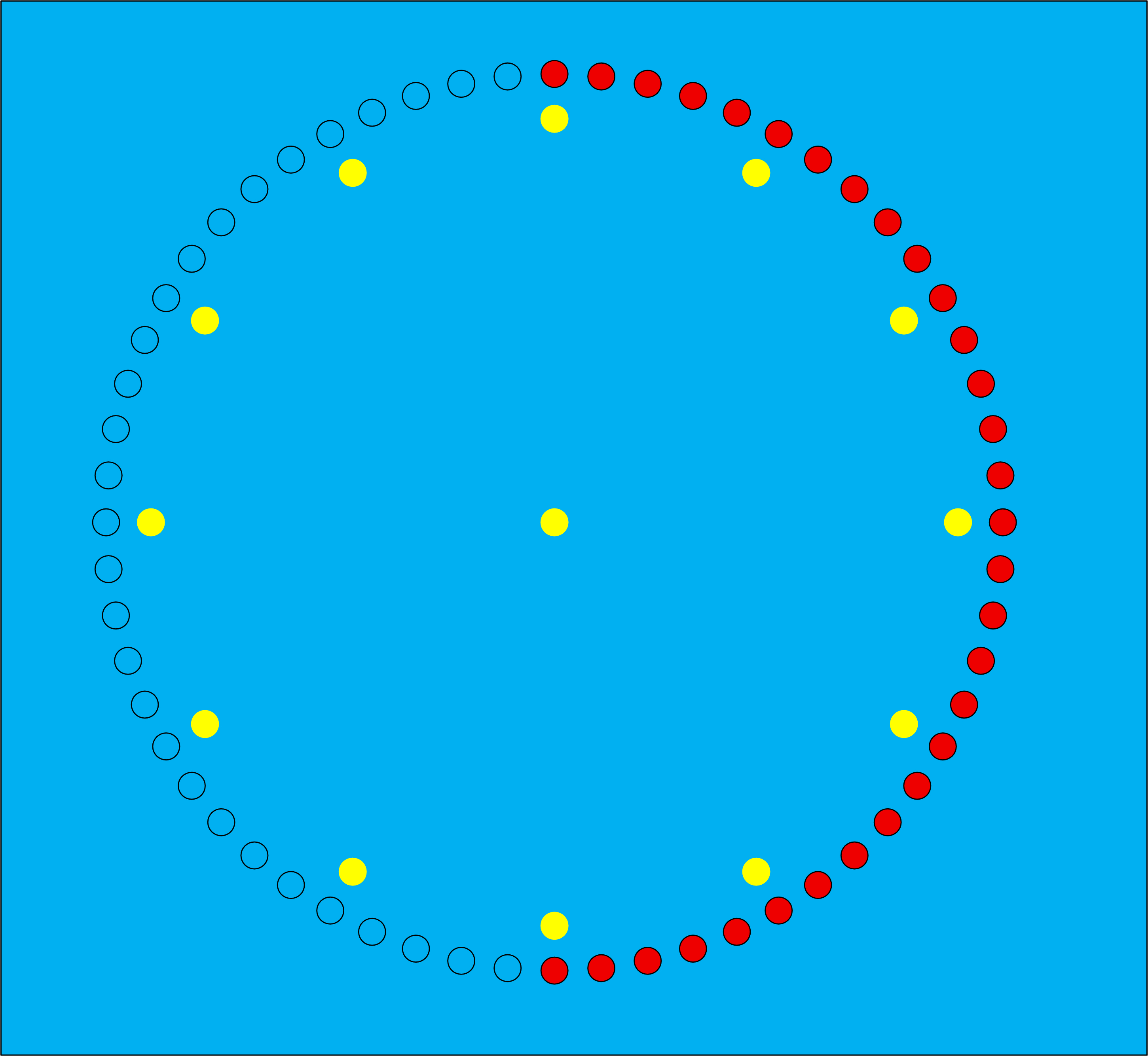

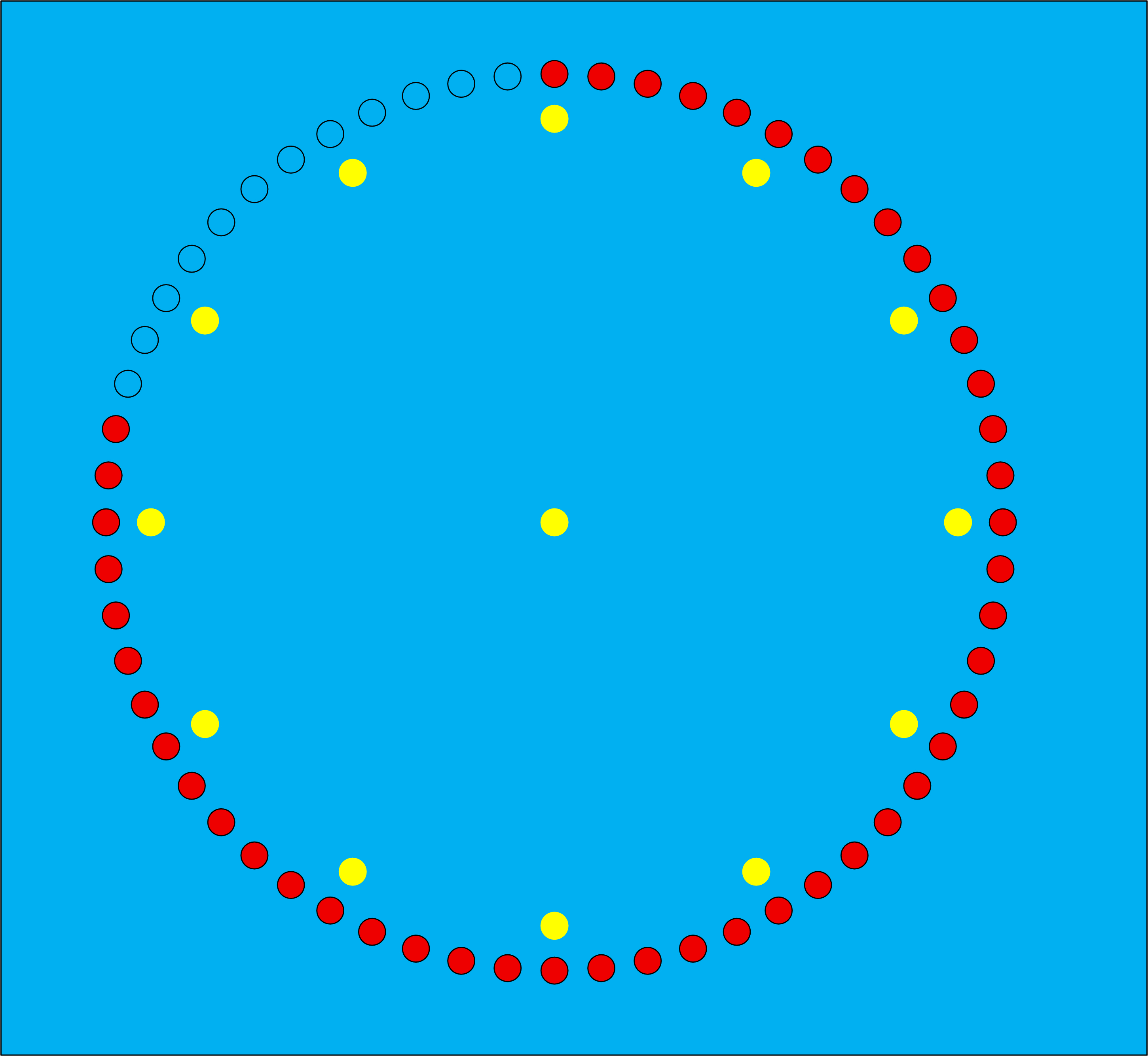

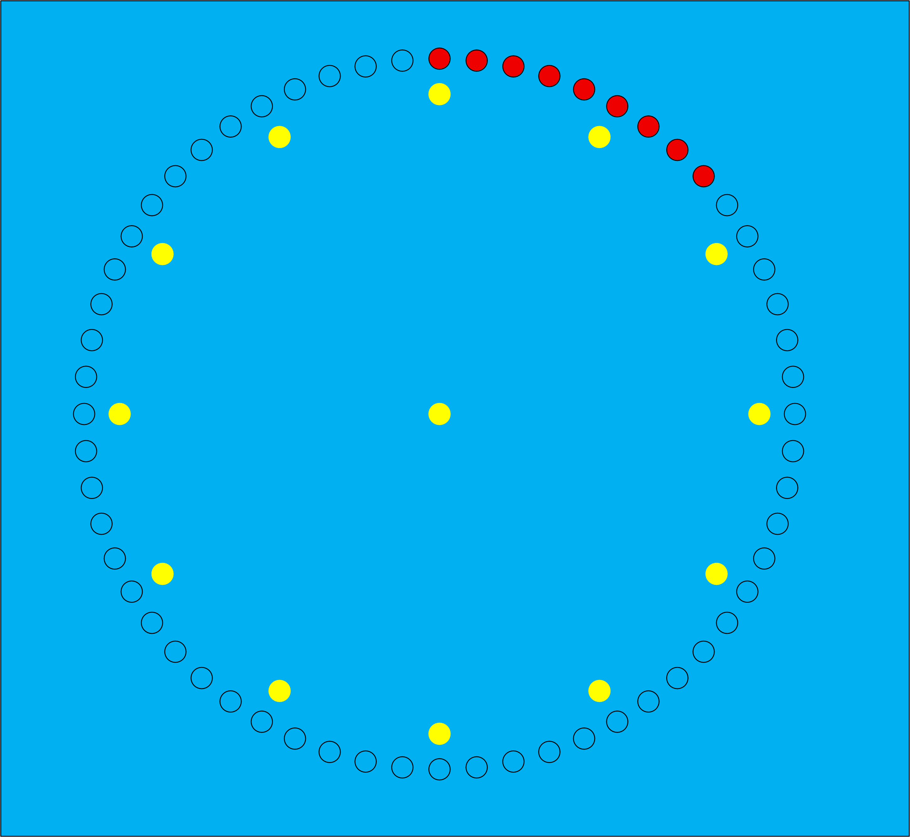

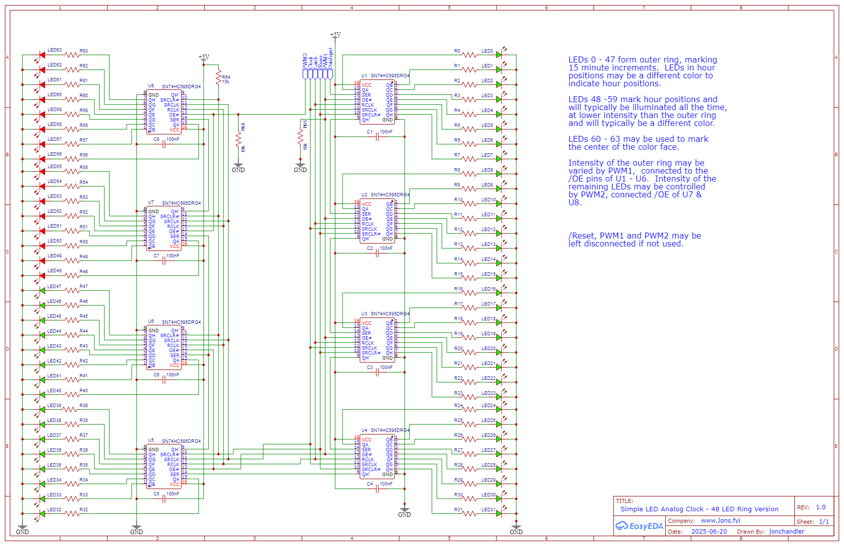

LEDs don't easily replicate the hands of an analog clock, at least without a multitude of them. Following the theme of my analog clock, an easy-to-understand "about" clock is pretty simple. A ring of 60 LEDs (60 to preserve the ability to display minutes, but 48 works better for this idea) displays not minutes, but hours. As the hours progress from noon to midnight, the ring is progressively illuminated (and repeated from midnight to noon). The ring of LEDs can be controlled by eight 74HC595 shift registers.
Inside the ring of 60 (or 48) LEDs are 12 LEDs to indicate the hour positions. These LEDs will always be illuminated.

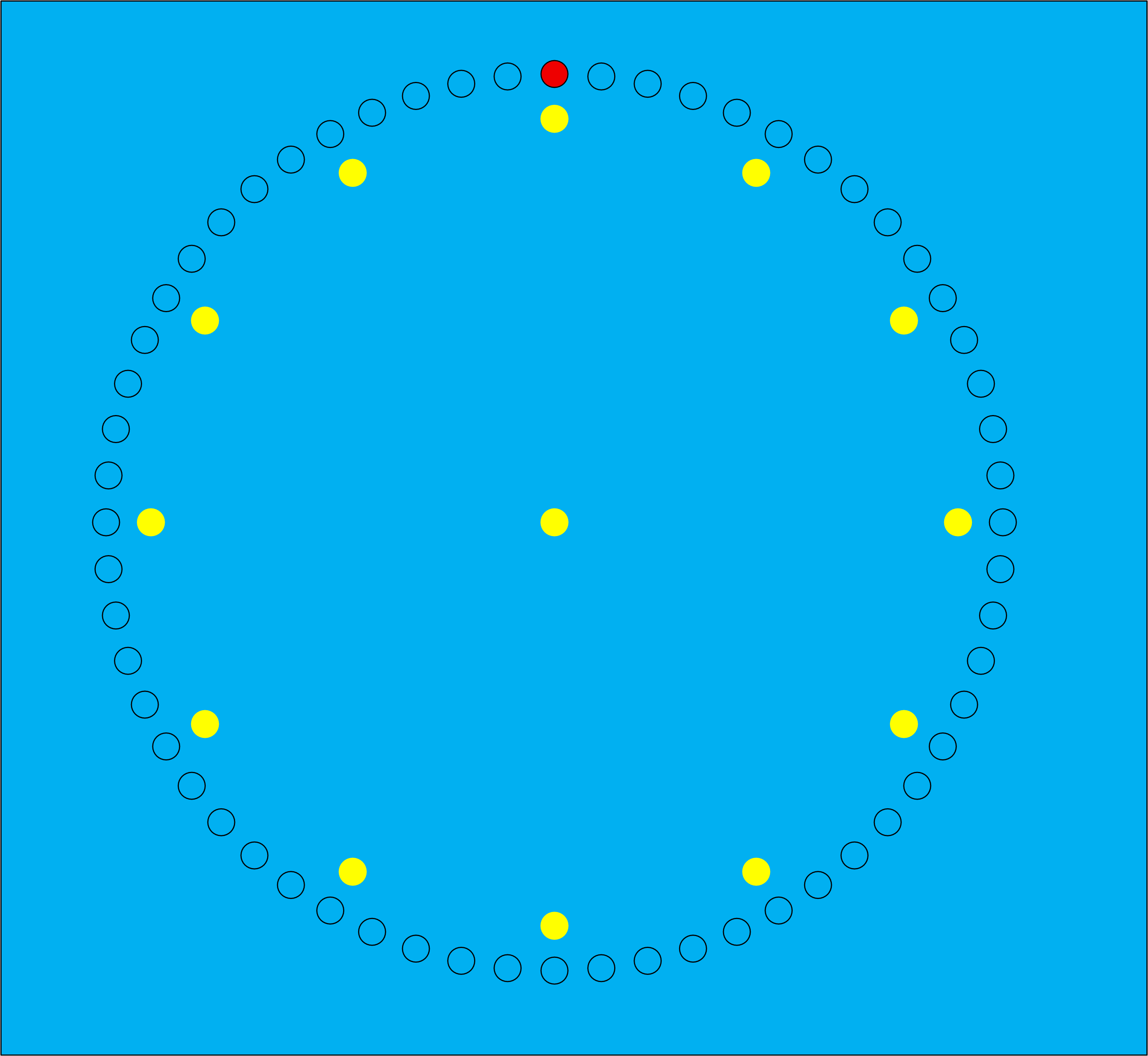

You can use 74HC4017s, but you have ZERO flexibility if you do. Exactly one LED which march around in a circle for the rest of time (ok, two LEDs if you insist on using one LED for minutes and one for hours). At some some point you may come to understand that if the "55" and "12" LEDs are illuminated, it's not almost noon – it's almost 1:00. But anyone else looking at the display will be confused. Look at the hour hand as time progresses. But you'll be stuck with it.
That's why I'm not attempting to emulate an analog clock. If you use 12 additional LEDs to indicate half-hours, your concept might be workable – it's after 12 and not yet 1.
Using the '595 shift registers, for little difference in cost or layout complexity, you could light up any or all LEDs as you see fit. You could do exactly as you've described. Or you could make time runs backwards. Or display a 10 minute timer. But this has all been explained before in your 20 page thread and you choose not to understand.

Curious would a single resistor save 7 resistors?
Only if it is guaranteed that only one LED will be on at any given time.
Also, this technique puts a reverse voltage across the off LEDs, Because the circuit voltage is only 5 V, this is not a problem. In a 12 V circuit, the reverse voltage could be great enough to cause reverse breakdown of the off LED junctions.
I am dumbfounded that despite examples, videos, and explanations, you STILL are locked into a mindset of only a single LED being on at a time. Why lock into the most limited design that will result in an un-decipherable display (for reasons already explained numerous times), when you can have the ultimate flexibility of lighting up any or all LEDs at once?
