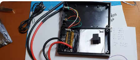

I got a cheap spot welding board and wanted to test it out. Since i got no LiPo handy, i thought i could use a microwave transformer and a 100A 1600V rectifier since board needs DC. I tried with both 7.5V and 12V coming out of the transformer. I basicaly get nothing. It barely shows on the 0.1mm strip, doesn't go through. If i had to guess i would say im not even getting 1 amp out. Transformer should be more than capable to supply enough amps to at least make a spark. Is there something im missing here ?
20250413_010002.mp4_snapshot_00.02.487.jpgScreenshot 2025-04-13 020407.pngS35101595a88a4716b093c6bc5f58bfe52.jpg

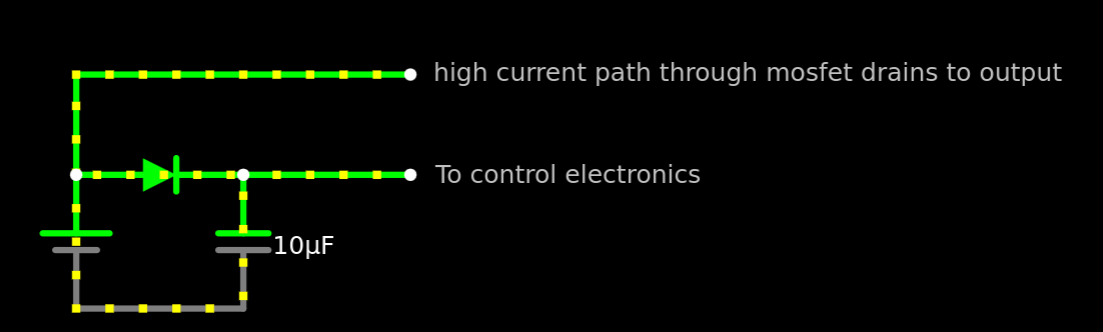

I may be mistaken but I think the aluminium SMD electrolytic capacitor may be connected as shown in the schematic below:
If this is the case, the diode and capacitor will help keep the control electronics voltage the same during the weld cycles. If the voltage on the input (anode of the diode) drops, the capacitor will remain charged and will maintain the voltage that was previously there. It doesn't need to be that large, only large enough to supply whatever small amount of current is needed for the control electronics during the welding cycles. If I am correct about this, you should be able to connect another capacitor in parallel with that one to prevent the board from turning off during welding. Can you use a multimeter on continuity check mode to see if the diode and capacitor are connected as they are in the schematic I posted?
I tried measuring between capacitor (positive side) and board input (positive). The reading read 0.7V for a brief moment, jumped to 1.8V and kept rising. So that would indicate that there is a diode between cap and input ?
I did try to put a 3000uF resistor in parallel with the existing 470uF one and can confirm that the board no longer turns off. Now i have to do a proper resistor bank, see if it helps. I tried soldering 2 0.15mm tabs together today and its no go as it is.
Ok so i finished this project, sadly as it is, it isnt usable.
- I added about 81.000uF worth of caps in parallel (about 50 caps), though it's normal caps, not super caps, so their power delivery is probably still very weak
- Transformer exit reads about 7.3V, capacitors which are connected to rectifier exit read about 9.3V, spot welding board is said to support 6-16V or 9-16V depending on which data to belive
- Board control has its own power source so even if board input sags to 0V, it will stay on
- System as it is, cannot weld 2x 0.15mm tabs together
- During the weld, killawatt reports 315W peak power draw, though cant be sure how accurate this can be due to short pulse
- If i bypass the mosfets on the board and connect rectifier negative directly to 1 of the spot welding tips and short them for a few seconds, i get a reading of over 900W. So the system is certanly able to pack a punch. That should be well over 100A considering the voltage also drops. Then ofcourse, there are losses. No part of the system heats up except the coil, so it's hard to figure out where the power is lost.

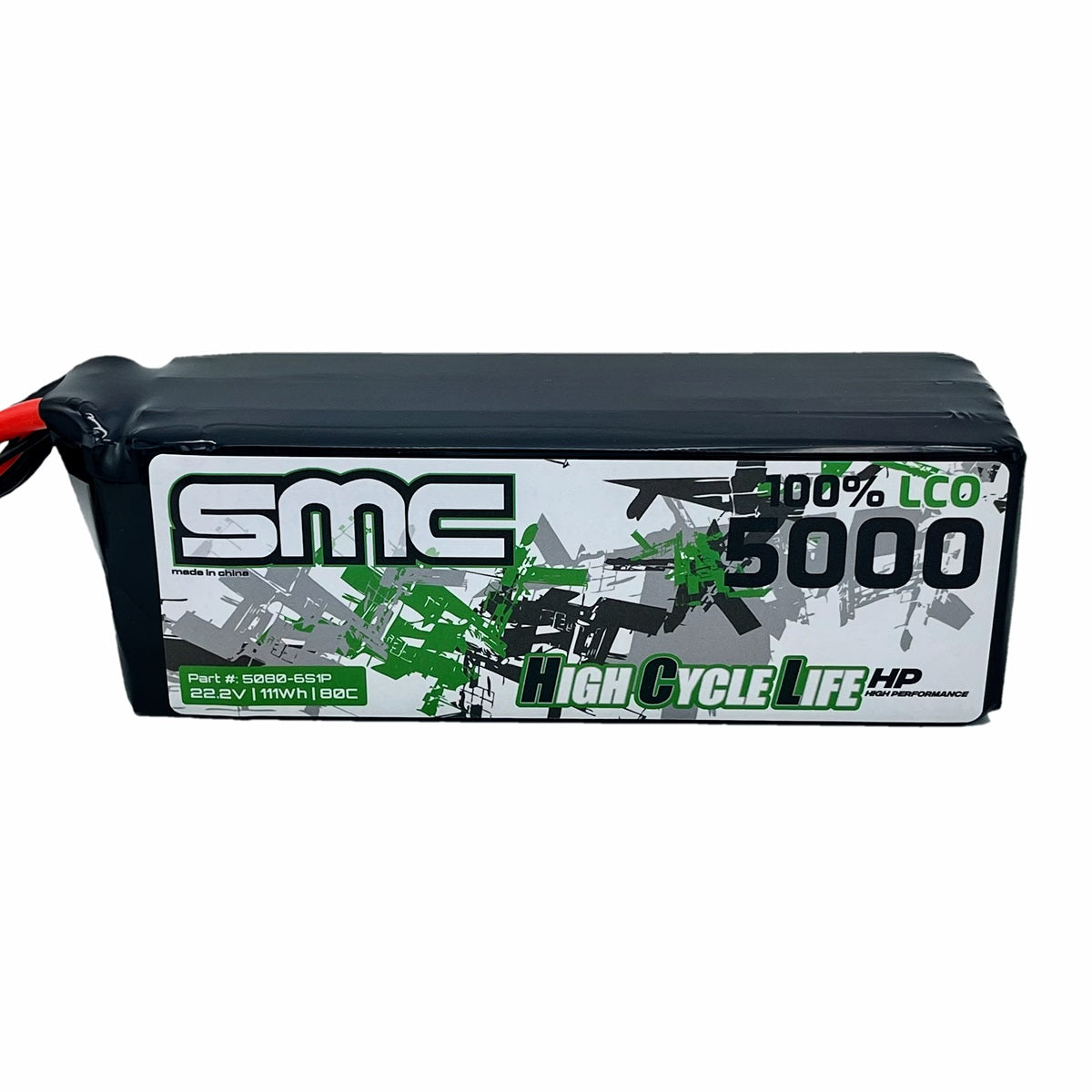

Cells have different maximum current ratings, depending on their internal construction. High discharge cells can be rated at massive currents - radio control flight packs are often like that.
Example:
That's 5AH, 80C rating; 1C discharge is one hour rate, 5A. 80C is 400A!
Some packs are rated 100C or more.
Example:
Some electric car batteries use high current 18650s - Tesla did until they changed to a larger cell type.
