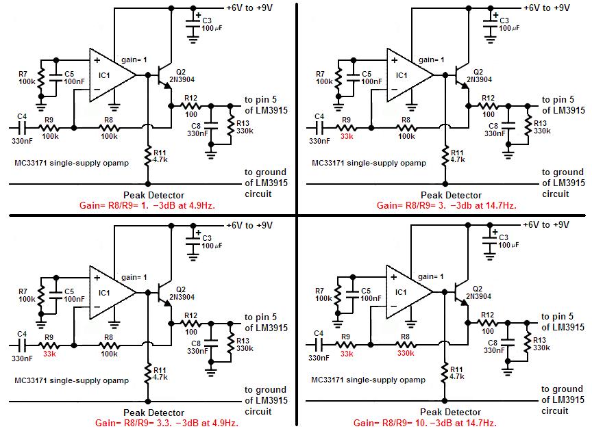

Could I get some details before that how to adjust the gain in this circuit, I think I'll just change the resistor there until I get good response with my mp3 player.
When the source has a low impedance, the gain of the inverting opamp is simply the ratio of R8/R9. Since the input coupling capacitor C4 is in series with R9 then the low cutoff frequency is determined by "one over two pi RC" as shown here:

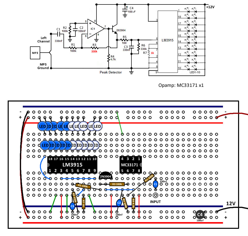

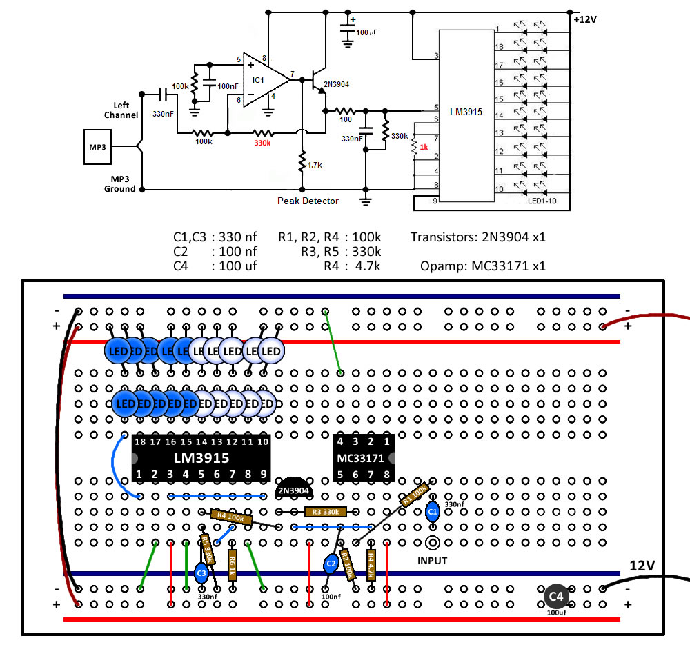

Ok, I built one. When I power it up, every LED stays unlit. In the picture is the illustration of how I did it.
3915 pins are showing what they should be showing, all the ground pins 0V, +12V pins 12.3V, pins #6&7 1.25V and pin #5 0V.
I tried to input some audio from the mp3 player, but nothing happens, voltage on pin #5 and on the 2N3904 stays 0V. I checked with multimeter if any AC is coming from the player, the connections work, audio signal is going to the board.
EDIT: Could it be that the MC33171 pins are wrong in the picture?

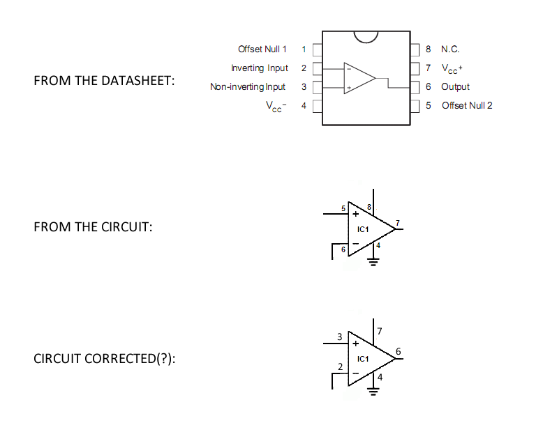

The picture in the datasheet got me thinking, but I can be just plain wrong here. If you look at the picture You'll see what I mean.

hi Gaichuke,
I will let 'agu' answer the OPA pin query as he has posted the circuit.
On your image you are showing R4 as 100K, it should be 100R, is a typing error.??
EDIT:
The one shown in 'agu's circuit is a DUAL opa IC's pinout , the MC33171 is a SINGLE IC
Oh right, there's two R4's there.
The R4 going from MC33171 #7 to the ground is the real R4, it should be 4.7k.
The 'fake' R4 going from LM3915 pin#5 to the transistor E is actually R5, which should and is 100k.
According the circuit diagram, the resistor to pin5 is 100R, not 100K
And from pin 7 , the npn base its 4k7.
Oops. So I actually have 100K resistor where only 100R should be. Just 1000x off. That might be a problem, yes.
But isn't 4.7k same as 4K7 ?
Yes.
You copied my "preamp and peak detector" circuit from post #89. It clearly shows an MC33172 8-pins dual opamp.
When using an MC33171 single opamp then you must use its different pins.
Breadboards are a tangled nightmare of crossed and diagonal wires and parts. I use stripboard where the layout is neat and tidy and parts are soldered so nothing is intermittent.
Yes.
Heh, that I did.
So single opamp pins would be according to datasheet... 2, 3, 4, 6 and 7. 4 would be the same, 2-3 input, 7 Vcc and 6 output.
Well look at that. It works! Thank you!
I had to substitute the 100R resistor with nearest counterpart I had(1k) for now, but it works nevertheless. Now I can move on to the casing and getting the signal divided from mp3 player to both amplifier and the VU meter circuit. Oh, and getting the second row of LEDs to work too...

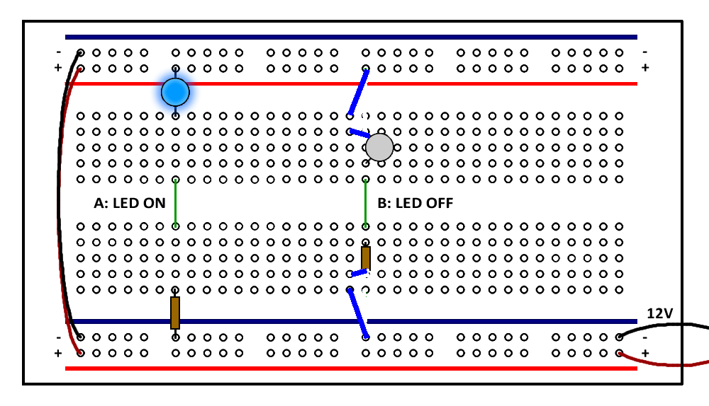

Hello again, everyone.
I think my LED problem is related to breadboard again. There's something odd about how it works or I'm not doing something right. I've made a picture of two setups with LEDs, A and B.
A works like it should, LED lits up.
B doesn't work, LED stays unlit. In addition, if I remove the last jumper wire going from resistor to the ground, LED flashes briefly and burns up.
What I'm not seeing here? EDIT: PLENTY. SHORT CIRCUITS GALORE.

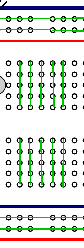

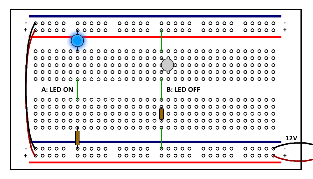

Morning,
In B the LED is shorted out by the board!!!!
The project board pins are arrange in rows as shown in this image.
