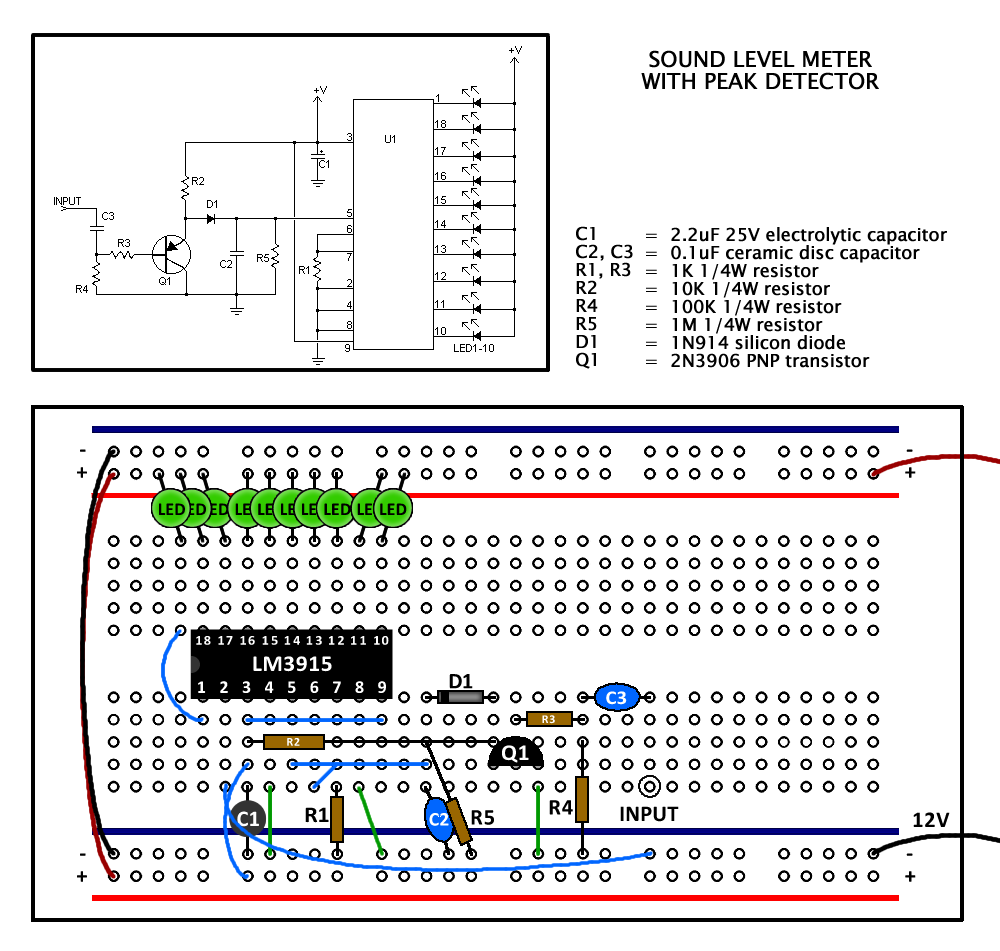

LM3915 LED VU meter problem - pictures included
I checked, it looks fine. I also tested the other chip I have, but both of those are giving me same measurement values.
looking fine doesn't mean it is fine. To make sure pin2 is connected to ground connect the positive DMM probe to the positive rail of the supply.
Use the negative probe and measure directly at IC-pin2. The reading should be about +12V.
If there is no voltage to be measured the breadboard might be faulty not contacting the IC-pin.

The peak detector transistor is shown on the datasheet of the LM3915 with a peak input of 10V, not 1.25V as shown here. At lower levels it has a serious error.
I agree that the transistor is backwards. Looking at the flat on its case with its pins down it is EBC. European transistors like the BC547 are CBE.

Here's the present setup, and I'm so confused now. I decided to change the place of pin #2 ground jumper which is seen as the long wire to the ground rail. There's no audio input to the board. I also fiddled with the position of the wires coming from the battery. This power-setup is supposed to be right as well, I mean the power and the ground just have to be connected somewhere, correct?
But now what happens when I plug the power is that every LED except no. 1 lights up immediately and stays on. And I have no idea what's happening.

"Fixed it", the transistor was the wrong way around (flat side up). Now it is flat down as in the pic, no LEDS light up.

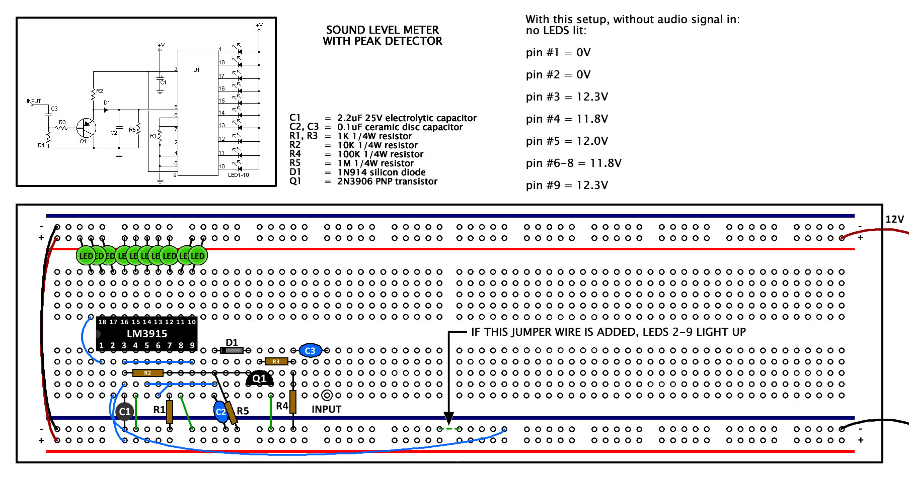

with the current setup, without audio signal in:
pin #1 = 0V
pin #2 = 0V
pin #3 = 12.3V
pin #4 = 11.8V
pin #5 = 12.0V
pin #6-8 = 11.8V
pin #9 = 12.3V

I changed the jumper wire for pin #2 to a longer one and I also changed the spot where it goes. Now pin #2 is 0V, but all the others are still 9.x

I did some testing with the pin #2 jumper wire going to the ground, and I noticed that there was a spot where the V of pin #2 changes from 0V to 12.3V. Exactly in the middle of the breadboard. If it was on the left side, 12V, and if on the right side, 0V. This isn't supposed to be the kind of board that splits from the middle, but could it be one nevertheless?
Here's a pic of the true situation, I didn't tell you this previously, because I honestly thought it would matter. You see, the breadboard is in reality twice the size, and I just showed half of it in the previous illustrations. The ground and the positive line from the 12V battery are on the far right end. I also tested this with a jumper wire in the middle, and when that was included, LEDS 2-8 lit up immediately when powering up.

I have some boards just like that.!! its perfectly OK, just put a short jumper across the 4 gaps, 2 top and 2 bottom OK.

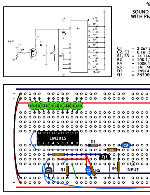

You have R5 connected to the wrong spot instead of it grounding the input pin 5.
If you add one resistor to make the reference voltage +10V like in the datasheet then the peak detector transistor will not turn on the first LED when there is no signal. With ther reference voltage at +10V then you will need a preamp opamp.

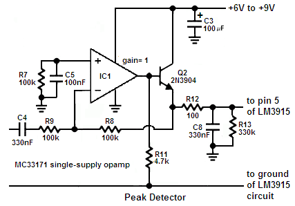

Maybe you should replace the peak detector transistor with a single-supply peak detector opamp circuit. I use it in my sound Level Indicator project.
Its output will be +1.25V peak like your LM3915 circuit. Reduce the value of R9 a little or increase the value of R8 for more gain but do nort give it too much gain. My circuit is attached and has a gain of 1.

hi agu,
I think you are misreading the image ref pin 5, it not very clear so I have highlighted the wires as I understand them to be.
