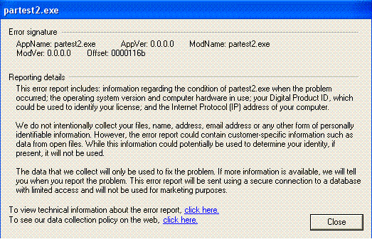

hi, just got a problem that's buggin' me for a while now. I'm trying to access the parallel port and downloaded the inpout32.dll and tried to access the ports after I placed the inpout32.dll in C:\windows\system, but there is still a problem and an error occurs, the exact link of the code i'm trying to do is this

Try putting it in either c:\windows or c:\windows\system32 instead. we normally dun put driver in C:\windows\system. If problem still persist, try putting that driver in the same directory where you run your program.
the instructions only told me to put the inpout32.dll in the C:\windows\system folder, it doesn't need to be installed (i think), it is located here http://www.logix4u.net I already ...icrosoft, I attached the details of the error

the instructions only told me to put the inpout32.dll in the C:\windows\system folder, it doesn't need to be installed (i think), it is located here http://www.logix4u.net I already ..., most prob your error come from programming.
i've already tried it with visual basic and it went fine, got it running in VB6 a few months ago. but my project needs to be done in visual C++ right now because the image processing will be done in C++, and I would like to have a uniform language in my project so as not to have problems with the delay in processing instructions, etc...I chose C++ for the speed of image processing. The problem is, I have no experience in using inpout32.dll for visual C++.

Well, i just went and download the package again. It include a VC6++ source code inside. I compile it and run. It went fine without any crash. Here is the source

Remember to include stdafx.h & stdafx.cpp in your project. I believe wat u need is only 2 function, "Inp32()" & "Out32()". Run the example again. If you can run VB6 example fine, i see no reason why you cannot do the same for VC6++
what operating system are you using? I'm using windows XP and I had a problem talking to my parallel port because there was something in the O.S. that blocked me from accessing it.

Not quite. The .lib needs to be linked to the final executable. The .dll only needs to reside someplace where Windows will be able to find it during execution, namely the Windows\System32 folder on NT/2000/XP systems and Windows\System on 95/98/ME.
gastonanthony appears to have done just that judging from the previous posts, so he'd already have the required files. If the DLL was missing, he'd get a more friendly error message, and if the .lib wasn't linked during the build stage, he wouldn't have an .exe

or in the present working directory
IT is very bad practice to start putting DLL's into the system32 folder that did not come with the OS.
It was that kind of practice that has lead to DLL-hell
DLL-Hell: When a programmer customises a system-dll and puts that in the system folder. Another programmer customises the same dll (for another program) as a result program1 no longer works
Have that on a OS-scale modification and you start to see why Windows-95, Windows-NT, Windows-98, Windows-ME were soo unstable.
2k and XP overcame this to some extent by protecting SYSTEM-dependant DLL from replacement (except during a SP or patch).
Other DLL's can still be perverted.
RPM-based linux distrobutions have something called RPM-Hell or (dependancy-hell) where there is no disctict link between the dependacy of one DLL to another.
Linux does not have the equiv of DLL-hell (as in programmers customising DLL's) since it is all open-source and If they want something in a *.SO they just submitt it, otherwise they will just make their own shared libary.
Leave the DLL in the working directory to ensure no pain later
