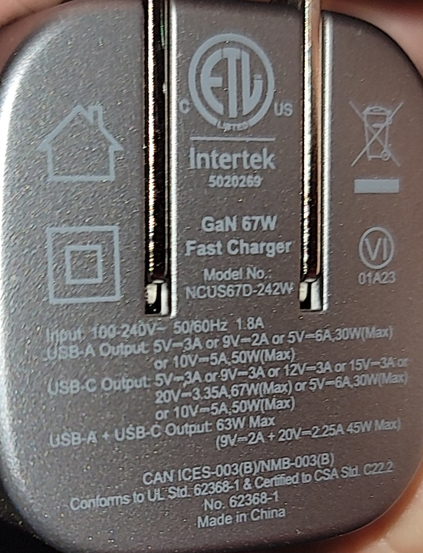

● USB C PD chargers always start at 5 volts and remain there until negotiated otherwise.
● If the PD charger doesn't have the requested voltage available, it will provide the closest lower voltage available. In every case. If the device can work on that voltage, it will. If not, it won't. It will not be damaged by a lower voltage or by plugging into a standard USB charger.
● It's true that some chargers advertise the total power available, even if that power is not available from a single port. When purchasing a charger, you have to look at the specs carefully. If the charger doesn't specify the power available at each port, look elsewhere. The power ratings for all connectors will be shown on the charger itself.
In summary:
● The charger will not provide a higher voltage than requested.
● if the requested voltage is not available, the charger will supply a lower voltage. The device has the option of using that voltage. If it doesn't like it, worst case is it won't charge. No damage to charger or device will occur.
● There is exactly one (or two) kinds of connectors – no problem of having the shell too big or the hole for the pin too small. And no chance of reverse-polarity.
● There's no need to keep a drawer full of chargers, all labeled with sticky masking tape with the fear that of inadvertently selecting the wrong one, ending civilization as we know it. And no need to keep a dozen chargers next to your chair to handle different devices. And no need to move your charger from outlet to outlet as you move around.
● Every device does not need a different charger that will end up in a landfill when that device is retired.
USB C PD is a good thing., and it is becoming a worldwide REQUIRED standard.

The critical difference, from what you describe in the first post - is that using the wrong (but compliant) USB-C outlet WILL NOT CAUSE HARM.
What you connect will only slow charge, or not charge at all - but no harm. The highest power & voltage versions are backwards compatible with the lowest demand devices and using a 60W one to charge a phone is OK.
The only variation is the highest-demand device that can be charged. If you don't need to charge a laptop, you can use a cheaper, lower power one for smaller device. The standard is very logical and consistent, to my mind.
Putting 12V on the 5V pins as you described at first, would destroy things!

MrAl calm down. You're sputtering. And much of what you posted is just plain wrong.
As far as using PD? I guess you've missed a number of my posts here. I have discussed here using USB C PD to replace a gaggle of power supplies when traveling. I just completed two nights in a row of operating my CPAP from a 2" cube PD supply. It works flawlessly, replacing a power brick of more than 6× the size and weight.
Since I took the time to understand the standard, this is the arrangement I'm using:
60w PD supply --> 20v trigger --> 10 amp buck converter module --> 12v to CPAP.
Why that arrangement? Because I knew 12 volt operation had been deprecated – I could not depend on PD power supplies supporting it. Going with 20 volts also provides a boost in power available, giving me some margin. Why a 10 amp buck converter, when 3 amps is the maximum available current? I tried a 5 amp rated module, and the inductor quickly became too hot to touch. Now the system is hardly warm to the touch.

Not if they are PD compliant. Measurement error on your part?
Some will put out 12vdc but not any higher.
The voltages put out depend on the wattage of the charger. 20 volts --> 60 watts. If the charger doesn't put out 60 watts, it will not supply 20 volts.
What this says to me is there is a LOT of variation with these chargers/power sources.
Indeed there is, depending on the rated wattage. It's really not that difficult to understand.
It would be incredibly hard to make they all the same, or should I say FORCE them to be all the same.
It's a standard. To say a power supply is PD compliant, it must meet the standard.
