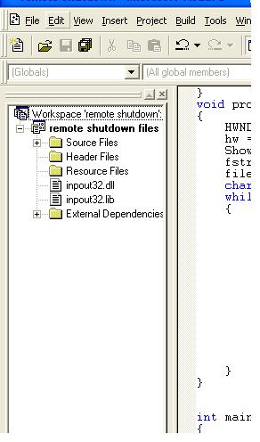

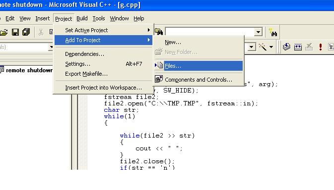

i will make this as easy as possible without being horrible.
1)copy the files out of the zip to the debug folder where the final built .EXE will be.
2)inport the dll and lib to the project, use the code shown.
3)use the built .EXE and inpout.DLL together.

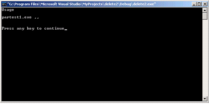

I did just what danielsmusic instructed,the program was built successfully (i think), and it opened a window, i attached the image of the window below, but as I pressed a key, the window disappeared afterwards, I haven't done the hardware yet, but do you think that it worked?
but when I replaced the _outp(atoi(argv[2]),atoi(argv[3])) by Out32(atoi(argv[2]),atoi(argv[3])), this was the error that occurred:
error C2065: 'Out32' : undeclared identifier
I think I saw someone posted in here that I need to replace _outp() with Out32() if I was to used the inpout32.dll?

You don't know what the code does?
Looking at it, it's waiting for at least 2 command line arguments, the first being either commands "read" or "write", the second I'm not sure. Where did you get that source code?
error C2065: 'Out32' : undeclared identifier means there is no such thing as function 'Out32'... You sure it takes a capital 'O'?
Ok, sorry, just went back and read the whole thread :oops:
The instructions danielsmusic gave you are incomplete. What he describes merely copies the files to your project folders. The .lib needs to be linked to your program. In Visual Studio/C++, once your project is opened, goto Project->Settings and click the Link tab. At the very end of the Object/library modules: text input box, type the name of your library file "inpout32.lib". Rebuild the project.
From **broken link removed** :
The DLL Inpout32
The functions in the DLL are implemented in two source files, "inpout32drv.cpp" and "osversion.cpp". osversion.cpp checks the version of operating system. "inpout32drv.cpp" does installing the kernel mode driver, loading it , writing/ reading parallel port etc... The two functions exported from inpout32.dll are
1) 'Inp32', reads data from a specified parallel port register.
2) 'Out32', writes data to specified parallel port register.
So your function calls should actually read Out32 and Inp32.
Also, since you don't appear to have a header file with that DLL, you also need to add thsee definitions at the top of your source file (preferably under the #includes) :
/* ----Prototypes of Inp and Outp--- */
short _stdcall Inp32(short PortAddress);
void _stdcall Out32(short PortAddress, short data);
This will get rid of the error you got at compile time.

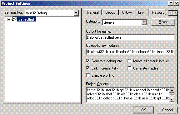

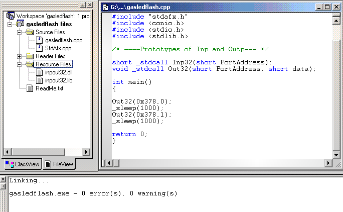

ok, so I tried a much simpler code, a blinking led code, it compiled, built and linked successfully, but nothing happened to my circuit. What could be wrong? I already extracted the inpout32.dll in the lib folder of VC++, in the system32 and system folder of C:\, but it still doesn't work. below are the attachments of what I did
Good, you're almost there :)
Now, you need to send a bit more data if you want to see something happen. Try something like that :
int i, j;
for( i = 0; i < 10; i++ )
	for( j = 0; j < 2500; j++ )
		Out32(...); // Send '1'
		Out32(...); // Send '0'
If everything's fine, you should see your LED blink 10 times before your program quits.
hahahahaha :lol: :lol: :lol:
thanks a lot to all of you guys especially to you Joel Rainville, I used the for loop that you made, i just saw one blink at first, then I changed the number of loops of 1s and 0s to 10000, and it worked perfectly!!! :D :lol: :D :lol:
