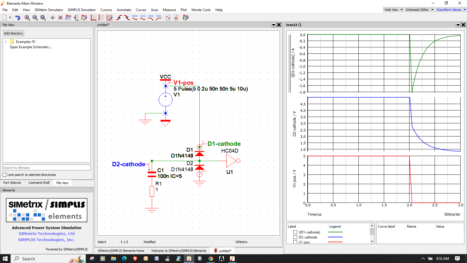

Folks seem to like building delays, debounce keys, etc, by placing large C at the
inputs to CMOS gates.
NOT A GOOD IDEA
For case where supply collapse rapid due to its design, load situation.
TI confirms this in an ap note on general CMOS usage. Here is a rough sim of the problem.
Note since spice model did not have the parasitic diodes in it I used external as substitute.
Also used 1 ohm as C ESR......roll your own value(s) for your case. Note using .1 ohms for
C ESR produced 3A thru D1......
The simple way around this is to place a series R between gate input and the large C.
Regards, Dana.
And where is that imaginary 3A going to?, it's yet another example of a wildly misleading simulation.
The chances of there being something on the CMOS power supply that can draw 3A is pretty remote, and even if there was, it would discharge the puny 0.1uF VERY rapidly.
It's a common issue, not because of imaginary high current's, but because power can feed in the I/O pin, through the top protection diode, and keeping the circuit powered up.
The supply is not being disconnected in the sim, it is being reduced to 0V.......the charged cap
providing the current.....
Load dependent .....
"puny" you say, OK, puny for you. "VERY", excellent engineering characterization of RC decay.....NOT !
Thats the whole point of the sim, except source of current is cap which does NOT keep circuit
powered up.....
Another example of a wildly misleading response....

I think your CMOS gate-equivalent circuit actually adds complexity and cannot be understood by the audience you've intended to inform. See post #2, for example.
powered up.....
In response to your usual 'chicken little' made up post to try and inspire fear!.
Ya, the two diodes (parasitic in all (almost all) CMOS) probably is too much, too challenging for some.

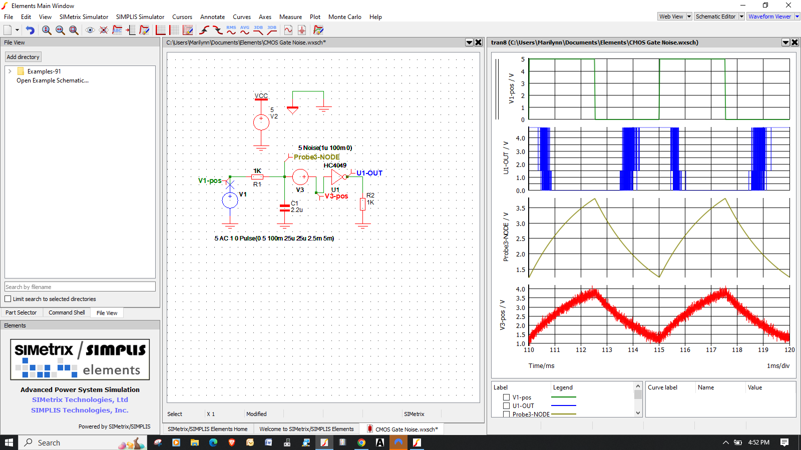

Chicken Little almost forgot to show what slow rise time signals at
CMOS inputs cause coupled with a little noise in system :
Stop the madness Chicken Little, just stop it.........

Interesting...
1. I wonder if this is demonstrating why a buffered inverter (or non-schmitt input) shouldn't be used as an internal oscillation could occur as well (causing it to drawing more supply current)?
2. Could you sim the circuit after inverter power up with no inverter input. Then provide an input after a delay of a few milliseconds? I'd like to see the results please.

Interesting...
Basically 100 mS for power up and then input to inverter starts at 102mS, and output starts displaying at 110 mS :
