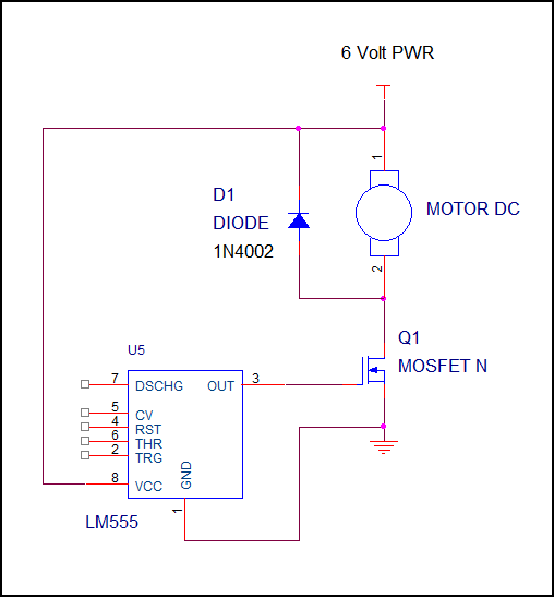

I want to add a transistor or CMOS amp to the output of a 555 timer.
Can anyone direct me to a circuit diagram that shows how to do this.
My requirement is to drive a .75- 1 amp load.
The diagram needs to show the part number and/or component valus.
Thanks in advance.

What voltage is powering the 555.
Also what is the voltage supply for the 1Amp load.?
It is possible to add a transistor or MOSFET to the output of the 555 to drive a high current load.
Hi:
What I want to do is drive a small dc motor with a 6 v battery.
My VOM shoots past 150ma when the motor is turned on.
Since the 555 is speced at 200ma I'm concerned about burning it up so I wanted a pretty good factor of safety by connecting the 555 to a transistor or CMOS for more power.
I probably don't need 1 amp capability but I think I should have at least 600ma
Richard
Hi Richard
I would likely think about using a Logic Level N Channel MOSFET similar to this one configured in a circuit like the attached. That would likely work out. You may want to add a 10 K resistor between the MOSFET gate and ground to make sure it turns off when it should be.
For an amp the MOSFET is somewhat overkill but it would work.
Ron
Hi Ron:
Your solution is exactly what I needed.
Thank you very much.
I thought it would be this simple but exactly how to connect the parts and what parts were needed was what I didn't know.
Regards,
Richard

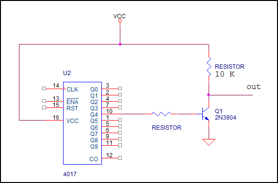

Do you know if a 4017 counter's outputs can be used to trigger or reset a 555 timer?
regards,
Richard
Without looking the trigger in and reset in of the 555 are a logic low. The 4017 when counting sequentially makes outputs high. It can be done but you would need an inverting buffer shoved in the picture. Maybe something like a 4049 hex inverting buffer and using two of the six in the 4049 package. That or maybe a few NPN transistors like 2N2222 or 2N3904 so when the base is high they place a low on the 555 reset or trigger.

I understand what you just said. One more question: Can one of the 4017 outputs be used to reset one 555 and trigger another 555?
In other words can one 4017 output be used as input to multiple IC's?
Richard
If we look at the data sheet for the 4017 Decade Counter/Divider we see it is a low power device. I would use an inverting buffer or transistor as I mentioned. When we look at a chip and want to drive something with it we look at what is called a fan out and we look at how much current the chip we have can source of sink. Then we look at what we need. Consider if you plan to have a 4017 drive a 555 reset and trigger functions you will need to invert the signal anyway.
Ron
Ron:
Looking at the 4017 data sheet it say it can drive two 74L or one 74 LS IC.
So if I understand I should be able to connect the 4017 output to the 74L and then the 74L output to the 555. Is this a correct understanding?
Richard
Not quite but close. Basic 74 series chips like 74LS or 74L are strictly 5 volt chips. Later came the CMOS versions like the 74HC series that use CMOS voltages. I am not sure what your circuit voltages are and thus for an inverting buffer suggested the chip I did.
Ron
Ok I can use a 2N3904 but do you think I can connect two 3904's to one 4017 output?
I really appreciate your patience with me on this.
I understand in general the circuit design but the specifics of the diffenent devices and what's important when connecting them is not something I learned.

Really if you are going to only work off a single 4017 output you only need a single transistor. A single 2N3904 will deliver I believe a few hundred mA and the 2N2222 up to about 800 mA. Attached is an example. The base resistor will be a function of the voltage used.
What exactly are you doing?
Ron

With respect to my question about driving two transistors from one counter output: is it OK to do this?
Richard
Yes, you can drive two transistors from a single 4017 output.
