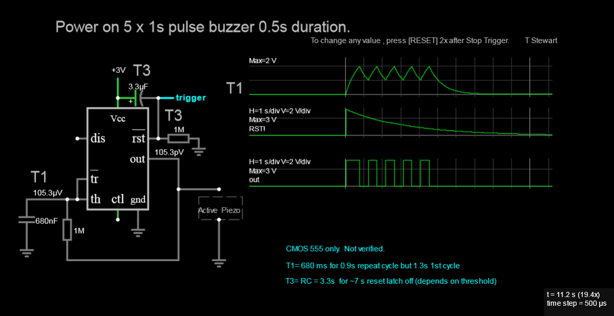

I'm trying make a non microcontroller circuit that gives about 5 quick beeps then roughly 1 second off, repeat. I'm running on 2 AAA batteries. I already have a bunch of cmos 555 on hand so was trying to make that work. I'm using a 3V active buzzer which is quite loud. I tried a few astable variations, the attached circuit with R1=1K (in series with variable resistor), R2=100K, C=10uF gave me the desired timing sequence but doesn't beep, just a steady on, 1 second off, repeat. What changes can I make to get the desired timing but with beeps.

Thanks Tony but it isn't working for me. Is anybody else able to try this to confirm if it works. My highest non-polarized cap is 100nF. I tried susbstituting a 1uF and a .47uF polarized (don't have a .67uF). Output is a steady buzz no beeping nor pause. For clarification what is the trigger meant to be. I had mentioned in an earlier post no trigger was required.
Excellent simulation; what program do you use? I assume you add a 2nd 555 to create repetitive cycles?

No, but the link should answer your question and no other components are needed. The plots should self-evident how it works. Astable clock + Reset to stop after 5 pulses.

#14 should also work.
I think you misunderstood my question. I know how the circuit produces *one* burst of 5 cycles at power-on. I'm asking about how it repeats and produces a continuous string of 5-cycle bursts separated by gaps of no cycles. Don't you need a 2nd 555 circuit (or some other oscillator) to continuously trigger the one producing the bursts:

Yes sorry I don't understand the question. I read that he only asked for 5 pulses after power on not repeating bursts of 5. Although the quick burst was generated by the active buzzer at some audio frequency was not defined in length and he wanted 1 second off. So I compromised for 50% on 50% off in five 1 second intervals. But if defined that too can be changed if specified.
Originally I was thinking of 2 timers, On, Off and one counter which later compromised to a 1 Hz Relaxation Osc with a 5 s reset.

So....did you ever try the circuit in post #14

The circuit in #14 looks like it pulsating beeps for about 6 seconds, then goes completely off. Is that correct?
