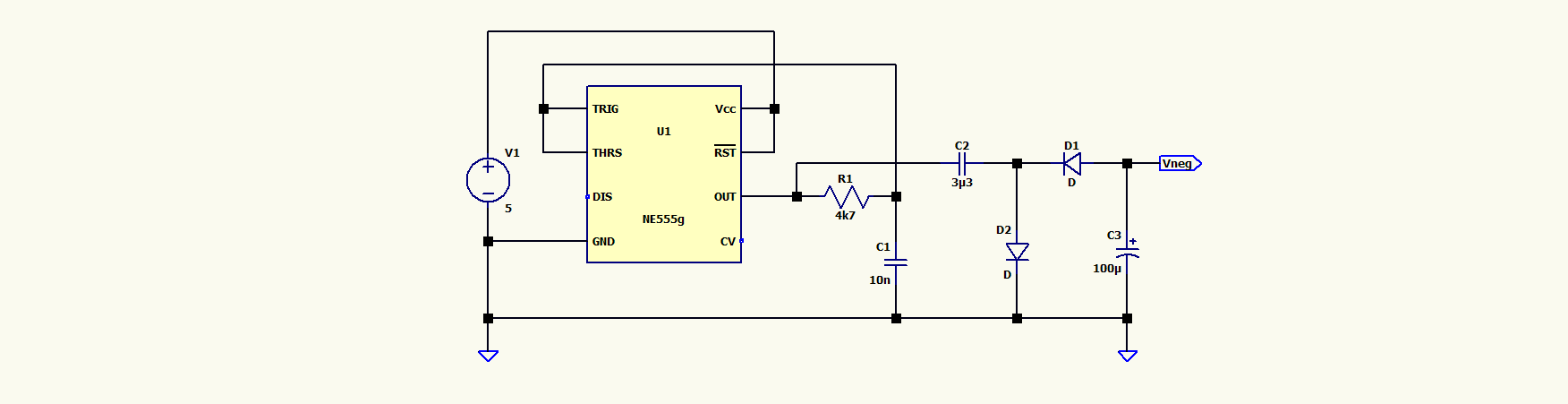

Your circuit seems a bit OTT if all you want is a negative supply for an op-amp. Wouldn't something such as this suffice? :-
Edit: Oops. C3 should be t'other way up!
It certainly would be. Seems much simpler as well than what I was trying to do. I will try it. But I will try to fix the thing I tried to build as well so I can use it with the small flyback. Should I use silicon diodes or something with less Vd.

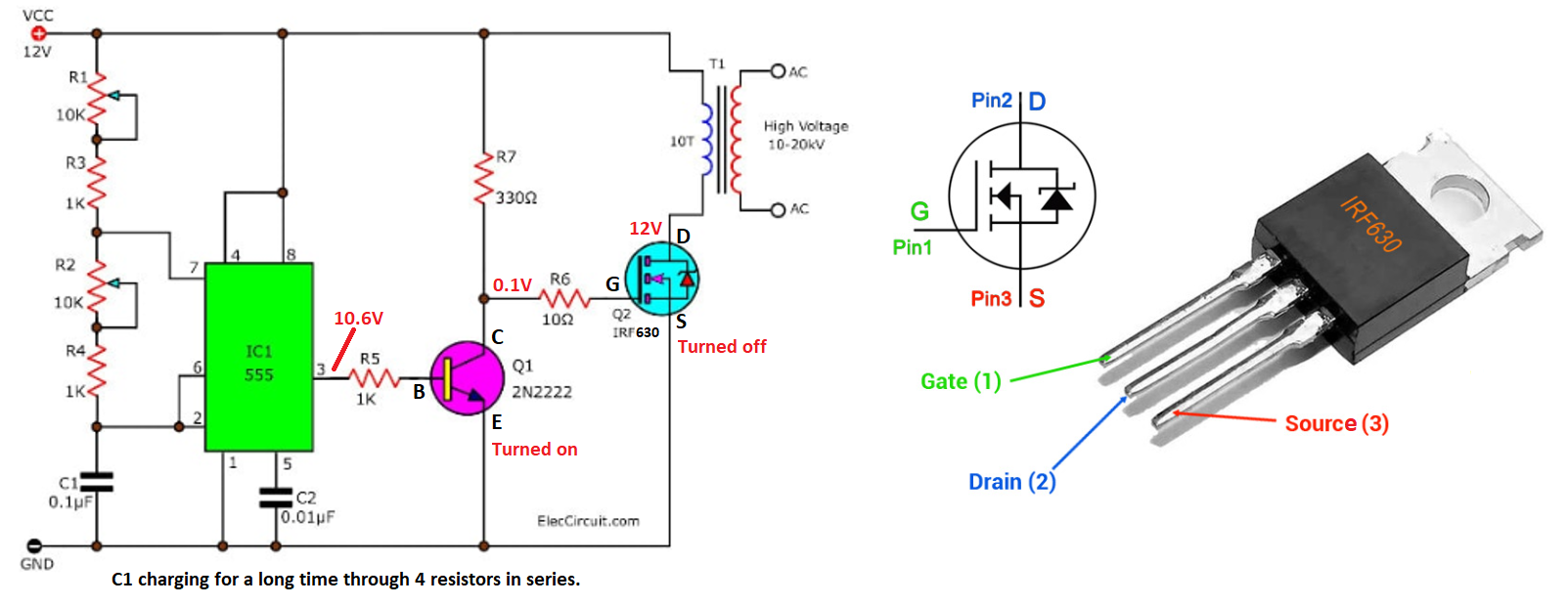

Fluffy, your 555 has its timing capacitor charging for a long time by two resistors in series producing an output high that turns on the transistors and transformer. Then the 555 timing capacitor is discharged by only one resistor for a short time when the 555 output is low and the transistors and transformer are turned off.
It would be the opposite if the transistor inverter is removed so that the output of the 555 drives the gate of the Mosfet.
Yes. My problem is that voltages at the transistor base and mosfet gate are very small and it is causing a huge current to be drawn from the drain of the mosfet.
Right now it is just like a electromagnet. When I give it sudden voltage from battery I can feel the movement of flyback transformer. No high voltage is generated because Mosfet is not switching because its gate voltage never goes zero. I think I will just replace the BJT and see what happens.
The collector of the transistor should go up to the 12V supply and go down almost to 0V.
When the collector of the transistor goes to 12V then the Mosfet turns on and its drain goes to 0V.
When the collector of the transistor goes to near 0V then the Mosfet turns off and its drain goes to 12V.
Your Mosfet is always turned on so it must be connected wrong or it is defective.

I am aware how it works. The problem is that when I checked it with the oscilloscope, I saw that there were high voltage pulses getting out of the 555 output pin but at the base of the transistor these waves were attenuated greatly. At the collector of the NPN transistor there was some positive DC voltage about 8 volts that never actually went to zero and on top of that there was a very small inverted pulse signal. Because collector voltage never goes to zero Mosfet always stays open. When I first put it together it actually worked for a while then happened to be like this. I think NPN transistor is damaged, or the Mosfet. But I always had current limiting on my power supply so Mosfet never got a current passing from its drain to source that passes its maximum value which is 9A. So unless I somehow generated a very high voltage spike at its base there should be no reason for it to be damaged. I used the pin diagram you put in the photo for the Mosfet. Actually this bothers me a lot so lemme change the NPN transistor and see if that solves it.
Ok Mosfet become a resistor apparently. It always has to be the mosfet that shits the bed since it is the most expensive. I hate it.

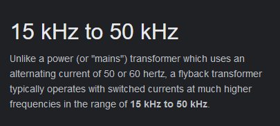

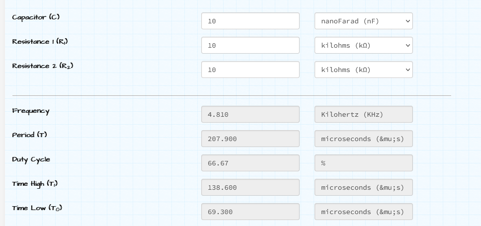

It is odd that it goes over 10Khz when it should not go more than 5Khz according to calculator. Maybe my capacitor is lower than it is branded. Still seems like too much margin error. Should I try 1nF and see if going to 40Khz makes it more efficient. I think it should operate out of human hearing range for that flyback to work nicely. Ignore this. With both 10K pots it should be able to go up to 100Khz. Since I removed one it can only go up to 11Khz. Seems like sweet spot is around lower frequencies anyway. Coil and Mosfet heats up too fast to figure where exactly it is.

The base-emitter of a transistor is a 0.7V diode. Then the base voltage is 0.7 when it is turned on and is 0V when it is turned off.
The 11.9V in the 330 ohms collector resistor causes 36mA and the base current should be 1/10th at 3.6mA.
With a 1k base resistor then the base current was (10.6V- 0.7V)/1k= 9.9mA which is high but should work fine.
The base resistor should be increased to 2.7k.
But instead you reduced the base resistor to 100 ohms which probably destroyed the transistor.
The high voltage transformer probably fed a spark over to the transistor and Mosfet.

The datasheet of an LM555 shows a graph at about 4.7kHz and its calculation of 4.8kHz when the two timing resistors are each 10k.

This works fine. I noticed that there is some additional voltage drop when I use multiple op amps. So it is not good at supplying about 10mA or something like that.

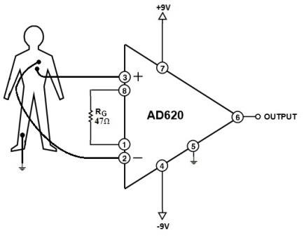

I tried building the AD620 datasheet ECG circuit with dual supply. I first tried powering it from 555 but no matter what I did it refused to work so I test it with +-10V later to see if it was caused by the 555 circuit. I put the filters and such but there was always some noise and no matter what I did I did not get an oscillation that was about heart rate. It was just random noise. I tried decreasing Rgain of the AD620 to increase its gain but it seemed like the gain I got from it was much lower than what it was supposed to be. So even amplipfying 100 times with TL074 after the output of AD620 I did not get anything meaningful.
I even tried this one to see if it was related with the leg drive op amp thing:
I also noticed that AD620 I was using almost consumed no current at 20V across its terminals with +/-10V. Maybe it was busted and I wasted my time idk.

I was suspicious of that capacitor so I tested the voltage and put it in correct way. The weird thing is that there is so much voltage drop on the negative supply. I am using schottky diodes with 0.25Vd so I should see about 0.5V voltage drop but even with no load I see something more than 1-1.5V. With 4.6V from arduino, negative side drops as low as -2.7V when only the AD620 is attached which pulls less than a miliamp. I also noticed the voltage drop was very inconsistent and changed greatly with different operating voltages even when circuit was fed from a lab power supply. I tried changing values around with no avail. Should I use a pre-set frequency for 555 instead of connecting trigger and threshold to the output.
