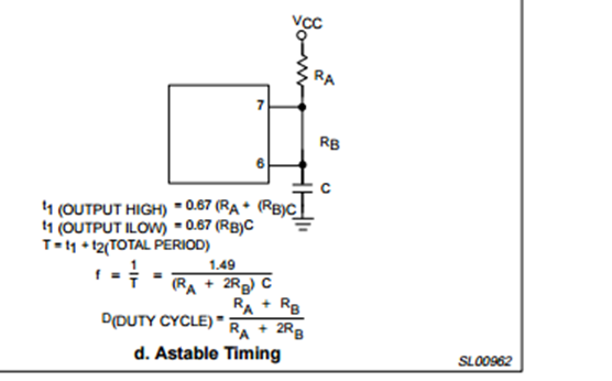

Look at page #8 of the 555 App PDF.

What exactly is Rb in this picture, C is the capacitor and Ra is the resistor, Rb? I believe it is meant to show a resistor.

Yes it is the resistors and capacitor which define the periods.

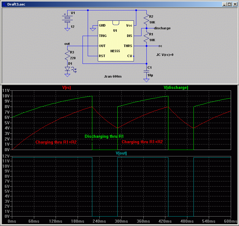

Look at this sim. The timing capacitor charges through R1+R2, but discharges only through R1 because the "discharge" pin switches to very near ground at the same time V(out) is low. Note that the first charge phase is longer than all the others, because the timing capacitor starts out at zero V, while on subsequent cycles, it is cycling from 1/3Vcc (4V) to 2/3Vcc (8V) when the 555 is powered from 12V.
After you understand this, you will notice that is very hard to get a mark (high) to space (low) ratio that is less than one...
