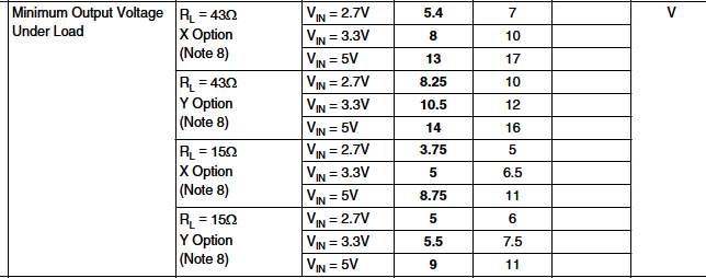

Let's see... LM27313. That data sheet looks damn familiar... oh, yeah.... I wrote it!:D Oh, well....
Anyway, it's an OK part except at lower input voltages (like below about 4V) the current limiter on the internal FET switch absolutely nose dives straight down. That means it can only do very little output power at lower ranges of VIN. Just FYI.
You would be better off using the LM2731, at least it has guaranteed current values you can hang your hat on. The 27313 is the rejects that fail when testing for the 2731.;)
At least this one has specs for how much power you can get at various input voltages (which translates directly into FET switch current).
