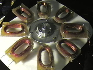

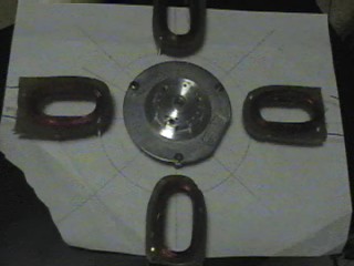

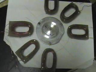

These are some pics of today.

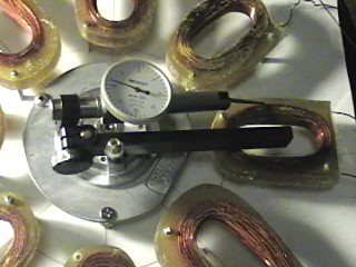

More pics..
The dial indicator came in handy to level out the height of the arms.
But still the one in the back is touching a little bit , GRRRRR ..

1) make the armatures smaller , i origionally designed them for the much larger Home Depot Magnets .. i figure a little bit thinner , and not as wide , about as wide as the magnets 1/2 " would be better.. and i can shave 1/2 " off the length.. this will give me more area for the flux to cut through.. also i found a chunk of laminate that i can use to check to see if it would work better than no laminate..
2) although the saw blade works very well it unfortunatly does flex a little bit , a few thousandths of an inch , if the 10" diameter one is thicker that would be a better choice..

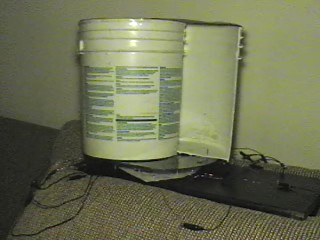

The 5 gallon bucket i tried actually works :lol: ..
It is charging two 1.2 V NiMH Batteries at this moment..
I have also been experimenting with a savonius shroud which funnels the incomming wind into the cup part of the collector and blocks the wind from the convex part of the collector..

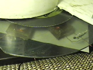

well here it is with the used 5 gal bucket.. You might not be able to see but i have the armatures connected with alligater clips , i suppose i should solder them..
the bucket is connected to the plexiglass with a screw ,as seen in the second picture , i still have to put a bead of hot glue around the bottom of the bucket..
the 5 gal. bucket is connected to the home depot saw blade..
under the blade is the magnets , then the armatures , then the base..

It seems to have a maximum speed of 128 RPMs .. because i have a three speed fan and the speed of it doesnt change much from low to high under no load conditions..If i gear it down by half , of course i would have to change alot.. but if i do gear it down by half then i could maybe get 64 RPMs out of it.. i guess i just need more power , if i had a lot more power then i could gear it up instead of down..
Also i've had to lower the armatures on the base , away from the magnets because the rotor flexes at high speed.. :( maybe if i use an automobile brake rotor then i could keep the magnets as close to the armatures as i want .. then i could put another set of magnets on top and another set of armetures on top of that...if i only had more torque.

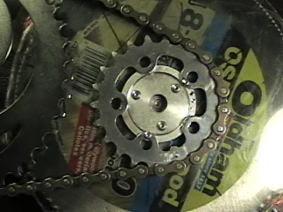

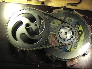

ya its awesome too :wink: tommorrow i am going to finish hooking the generator to a bicycle sprocket set to find out how much power it can produce .
i've allready lit an 1157 auto taillight bulb with it..!
it wasnt at full brightness yet , but it was glowing pretty good, which was amazing for something that I built..
As you can see i have not put a handle on it yet , nor have i mounted the larger sprocket..
but i figure with the 2:1 ratio i should be able to get a lot more power from it, maybe even light the bulb to full brightness..
spinning it by hand is fairly easy even when powering the light bulb , in fact i cant physically spin it any faster, not because of the torque required but it gets to a point where you just cant spin it any faster.. Hence the 2:1 sprocket setup..

All i can say is WOW !!
here are the stats
peak no load voltage was 35 V , i couldent get the whole peak to peak wave on the scope !! my max is 5V per division..therefore i was getting 70 V peak to peak AC ..
i noticed that once the bulb started to light it got easier to crank, as i would expect..because as it heats up the resistance goes up therefore making it easier to turn..
loaded voltage & current :
through the 1157 bulb .. 15 v Peak @ 337mA .. I guess it wasnt at full brightness , but it got pretty bright..

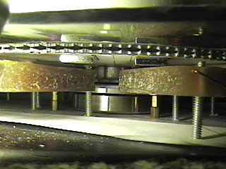

I just increased the current by adding a laminated steel ring around the inside ..I wish the rotor/saw blade didnt bend , but it does , very dissapointing.. i have a auto brake rotor :wink: around here somewhere ?? that is what they use on the otherpower site ..
i just got over 340 mA without the gearing :D a nice improvement..tomorrow i will test it , with the gears..
ok i just connected the generator directly to an Ammeter with 0.7 ohms resistance..
Said meter was reading 1200mA max !! Yes over an Amp !! wow

You will get maximum voltage with no load, and maximum current directly into a meter (like you just have).
The trick now is to find the optimum point that provides maximum POWER, which will be the most efficient use of the generator.

i forgot to add that i it was 0.61 V at 1100 mA ..
hmm only 0.671 Watts .. the amount of energy i was putting into it , i was hoping that it was more.. i could only keep it over an amp for about 30 seconds..
