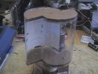

You'd have to show us a picture of the design. It doesn't sound like you made one exactly like the PDF shows. The easiest thing to do would be to use a pulley and belt. Make a larger wheel on the fan and a smaller on the motor. Run a rubber 'belt' between them. That's the easiest way, but it's prone to failure in the long run. I don't know what lifespan you want, but belts tend to slip and get loose, and don't like being exposed to the elements very much.

Mark you're right i didnt use their design exactly..
below are pics of what i did..
this one is the Savonius wind collector part..

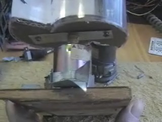

this one is a close up of how i connected the motor /generator to the Savonius wind collector..that plate (with the screw at either end) above the motor is galvanized sheet metal..what you cant see is the connection of the plate to the nylon pulley connected to the motor shaft..
i had to drill and tap two small screws to hold the plate ..

I dont know why i didnt check the current before , But i just did and the motor puts out a respectable 0.040 to 0.060 A !! Even when turning very slowly..!! and i got it to produce a maximum of 0.91 mA ..
At one speed it was putting out 43 mV and 62mA , with one meter reading voltage the other reading Amps.
granted as it is now I would need 31 devices connected in series to charge a NiCd but i see potential here...
i was wondering if there was any way to rewind the motor to output more voltage.??

the one in the PDF is small, about 5 inches tip to tip..
my new version is almost 8 inches tip to tip , and almost 8 inches high..
next i am going to try a really large one..maybe using a 5 gallon bucket..
i think the trick is going to be to keep the mass of the airfoil as low as possible..

A 540 is a common model makers motor.
The voltage generated depends (obviously) on the type of motor, and the speed you rotate it at. You need to drive the motor quite fast, so gearing up will be essential.
